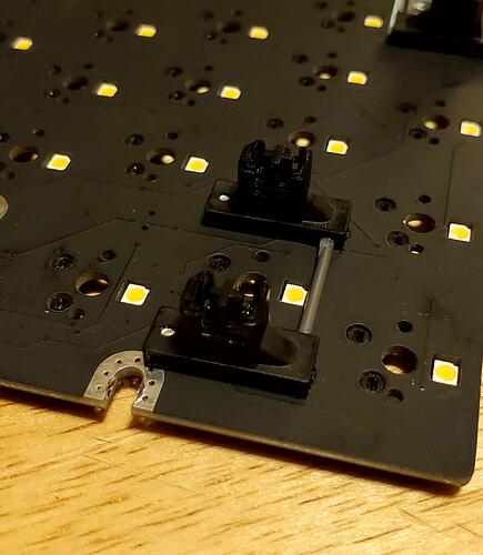

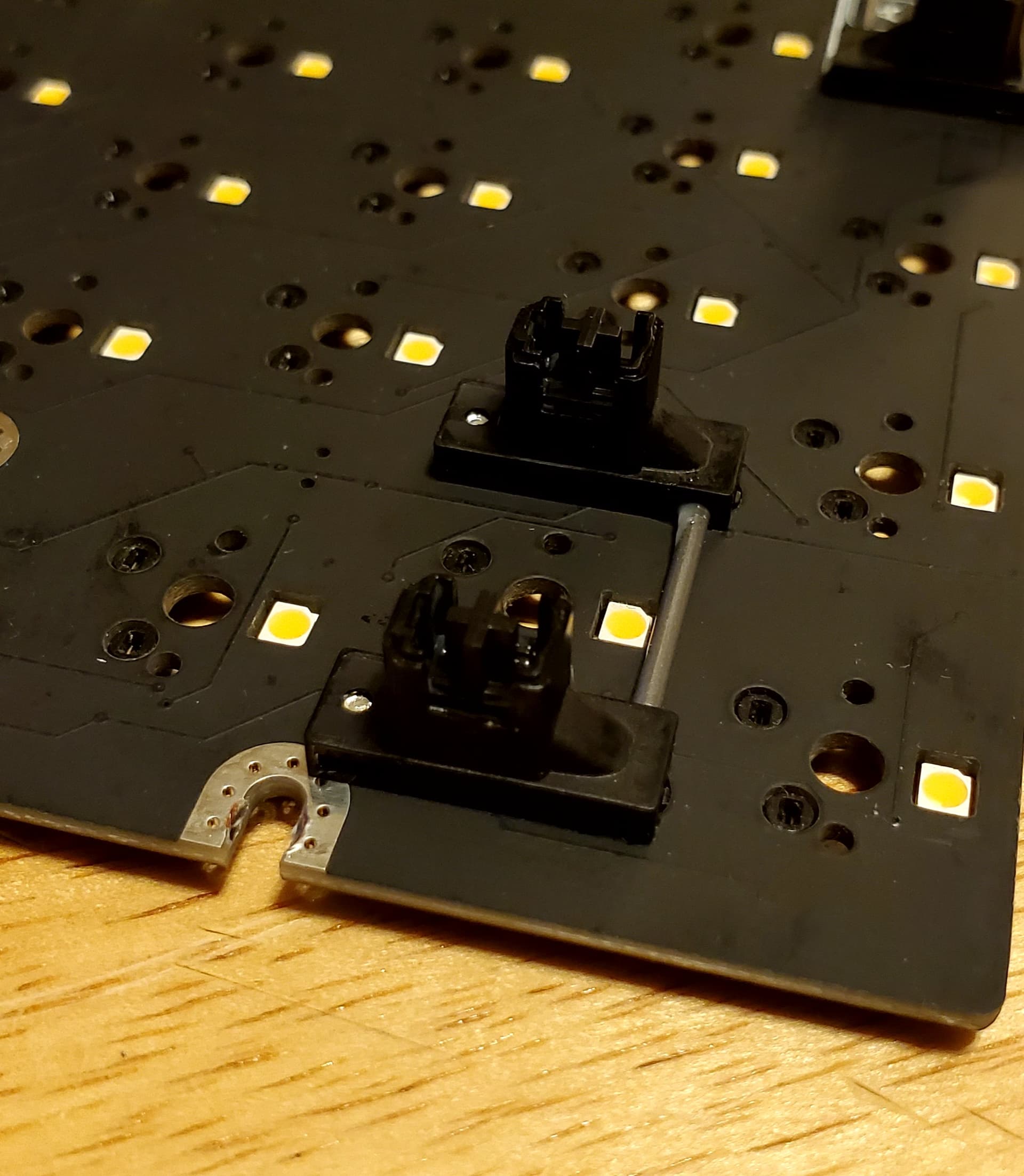

So I tuned up some of those QMX stabs & gave them test on one of my HS PCBs. FIrst impressions, tight & quiet. Overly tight though, I may have added a bit too much lube into the wire pocket in the slider but it hasn’t loosened up after some pretty serious spamming so it just may be how they are. They make the upstroke just a tiny bit slower than un stabilized keys, enough to notice & bother unfortunately. On the upside, you can remove the sliders from the housing, you just have tilt it towards the clip side when it’s fully extended & it pops right out. So lubing was not as tedious as I thought it would be. They are dead quiet when lubed to.
Think I’m gonna take these back apart & remove some of the lube in the wire pockets which should hopefully make them feel less tight & lose that tiny bit of sluggishness I’m getting. Then give them a shot in a full build when my Salvation gets back to me. Will report back once again when I do that. So far I think they have potential, but do not surpass TX stabs being honest.
