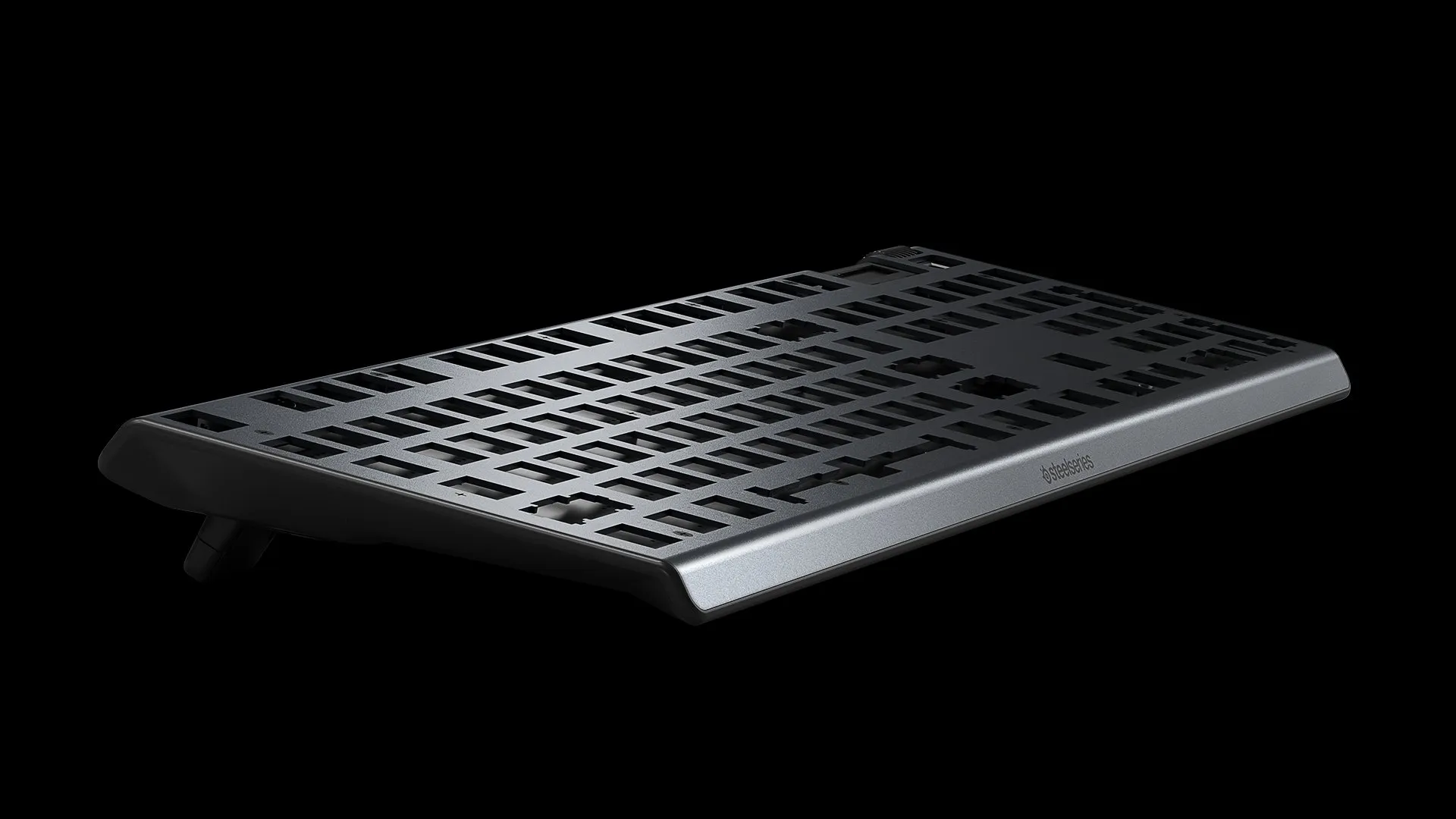

I’m not very familiar with this board, but from the Apex 7 product page, it looks a lot like a bent steel frame with plastic bottom/sides:
I’m guessing the left side of the board is either more hollow than the right side and is conducting more of the spring ping and amplifying the sound. Like @pixelpusher said, there are lots of ways to make keyboards sound better, but for a pre-built board like the Apex 7, they almost always void the warranty.
