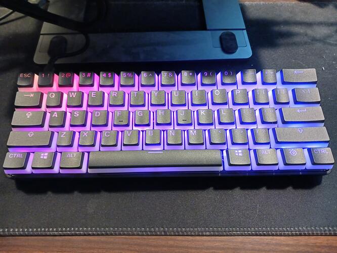

Apex 9 Mini with lubed switches and stabs, prism keycaps, and band-aid modded
I’m very new to the mechanical keyboard community, though I’ve owned a couple keyboards in the past, this is my first mechanical keyboard. After some research I bought keycaps and a lubing kit from Amazon in my quest to make it sound like the keyboards in those Youtube videos. I think it turned out pretty well but I suppose I would just like to know what people with more experience than me think about this keyboard. (sorry for terrible picture I really don’t have a good camera)

I want to dampen the spacebar sound a little bit more because it sort of sounds and feels like its slamming down, any tips?
Definitely! There are a handful of things you can do to dampen a space bar. This isn’t an exhaustive list, but should be plenty to get you started:
  • Keycap o-rings: if you don’t mind reduced travel, this is a really easy way to take the edge off of a harsh space bar; simply slip an o-ring around the center stem (and maybe the side ones depending on whether or not your stabilizers will accommodate them) and re-mount the cap. You can get a whole bag of these for pretty cheap and worse case, it’s just about the easiest to un-do mod out there.
  • QMX clips: kind of like o-rings, but not. These clip-onto switches and similarly reduce travel - but unlike o-rings which only dampen the downstroke, these dampen the up-stroke, too.
  • Dampened switch: another option is to swap the switch under the space bar for one with built-in dampening; silent switches. Some are mushy and quiet, but some retain a bit of firmness along with a “thud” sound - TTCs and Kailhs being some of the latter.
  • Un-clipped stabilizer stems: most stabs these days are just flat at the bottom, but go back more than a couple years and you’ll see little legs on the bottom of the stems - these are plastic leaf spring dampeners. Most enthusiasts clip them off for consistency with the other keys, but they’re there for a reason: they do take the edge off those wider keys. If in doubt, just about any set of Cherry stabs will have these on the stems.
  • Padding under stabilizer stems: the band-aid mod, but taken further; placing a small bit of padding under the stabilizer stem can also really help take the edge off. Lots of vendors sell little kits of these pre-cut, but it’s also not too hard to cut your own from some thin adhesive foam.
  • NuPhy’s Ghost Bar: a relatively recent product that exists for this very purpose; it’s a space bar with built-in dampening. Essentially, the center stem is a silicone insert that absorbs a lot of the harsh vibes without introducing as much mush as an o-ring, silent switch, or stabilizer padding might.
