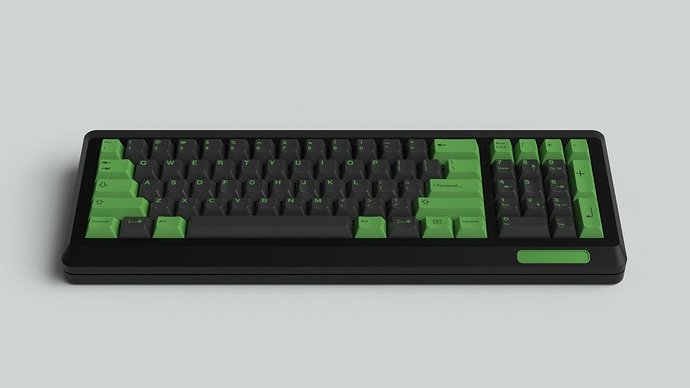

The Key Company is doing a modern version of this soon. You can see renders of it on their site on the Terminal R2 page.
You seen that thekey.company is making a aluminium custom based on this board?
Wouldn’t a UK78 fit the bill for a ‘60% plus numpad’ board?
oooh, I had not seen this
chunky bezel too. The filename refers to it as “Molly”.
@Dan yeah the UK78 is similar, except the arrow keys also occupy the numpad, and there is no divider between the numpad and rest of the keyboard.
