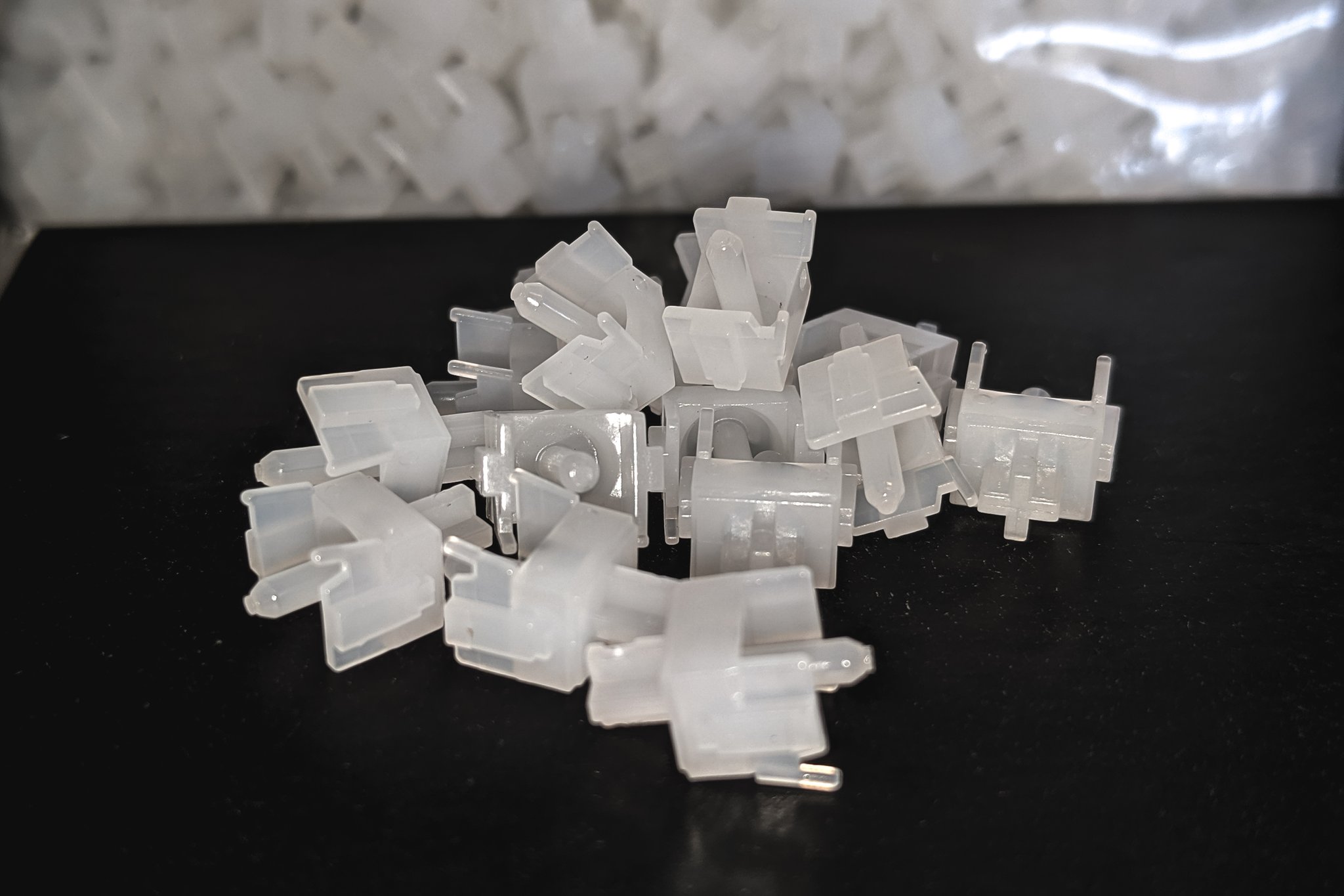

Aqua Zilents(62g) version swapped with Sprit springs(68s, 65s, and 72p) rotates clockwise when fully pressed
Anyone have weird experience with Aqua Zilents, specially with the 62g version housing?
I’ve tried googling about reviews about it and only found good things about it(for valid reasons) but something is bothering me about how they somehow twist clockwise when after the highest tactile peak.
This observation of mine came from Aqua zilents(62g parts except the springs) - ignore the keycap label.
Link of video using 72p SPrit springs, this is also same with 68s, and 65s
Is this normal for aqua zilents?
So I have 62g Zilent V2’s that have not been opened. I do have one (The tab key, IIRC.) that will occasionally torque to one side, but I think it may be due to how I pick up my travel keyboard.
Your GIF gives the impression, that you may be pushing really hard, at the bottom of the stroke. Which could possibly be causing the rubber bumpers at the bottom of the switch to deform and cause the twisting motion. It could also be a bad stem, with messed up bumpers.
aside from spring swapped, its a new batch of switches…found out later on, it’s a bad stem. Tested 3 randomly fresh from bag, fetched the stems and tried on halo housings and still the same. These are noticeable on my aqua zilents, my zilents v2 don’t have the problem.

it’s from drop. First drop of aqua zilents.
Thanks! but I think i’ll just tank this one. I don’t think it’s worth the hassle given the current situation re: COVID(country lockdown, limited delivery, etc.). Guess I’ll just have to figure out what to do with the housing.
Could try some of those UHMW liner stems… If they are available.
I actually messaged u/hbherionbob for his new stem(U4 - full travel silent tactile stem) after finding out the twisting issue of my aqua.
But yeah, those U4 or I’ll just get some Tacit whenever they’ll become in stock.

I think it’s caused by the rubber / silicon dampeners at the top not being as tall as the normal hard plastic surface that is there on the non-silent Zealios, etc.
Maybe padding on one side of the stem is protruding more than the other side?
nah, the twisting starts right after the end of the bump and before the stem hits the bottom.
