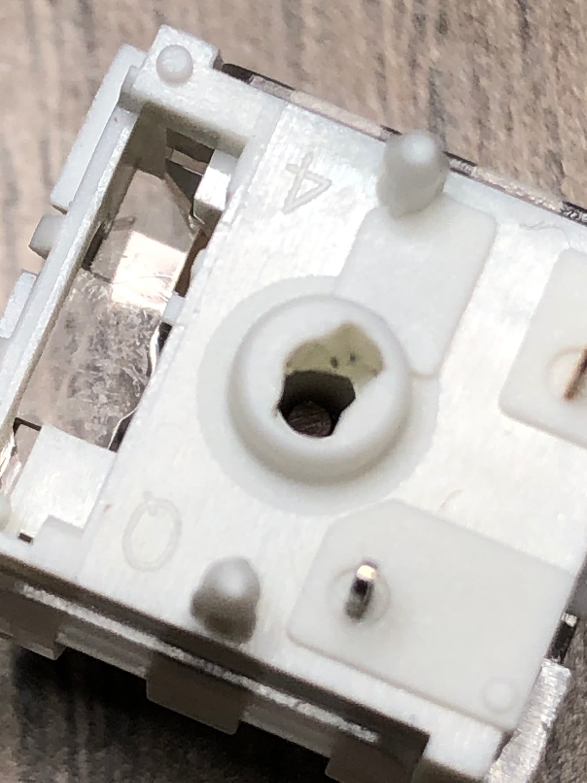

This came up in another conversation; these switches have a weird hole on the bottom along with a few other early BOXes.
It’s round in the middle, but at the bottom it has a bent key-hole shape that cuts into the tube, connecting its open space not just to the open air but to the bottom inside of the housing.
One angle of the key-hole.

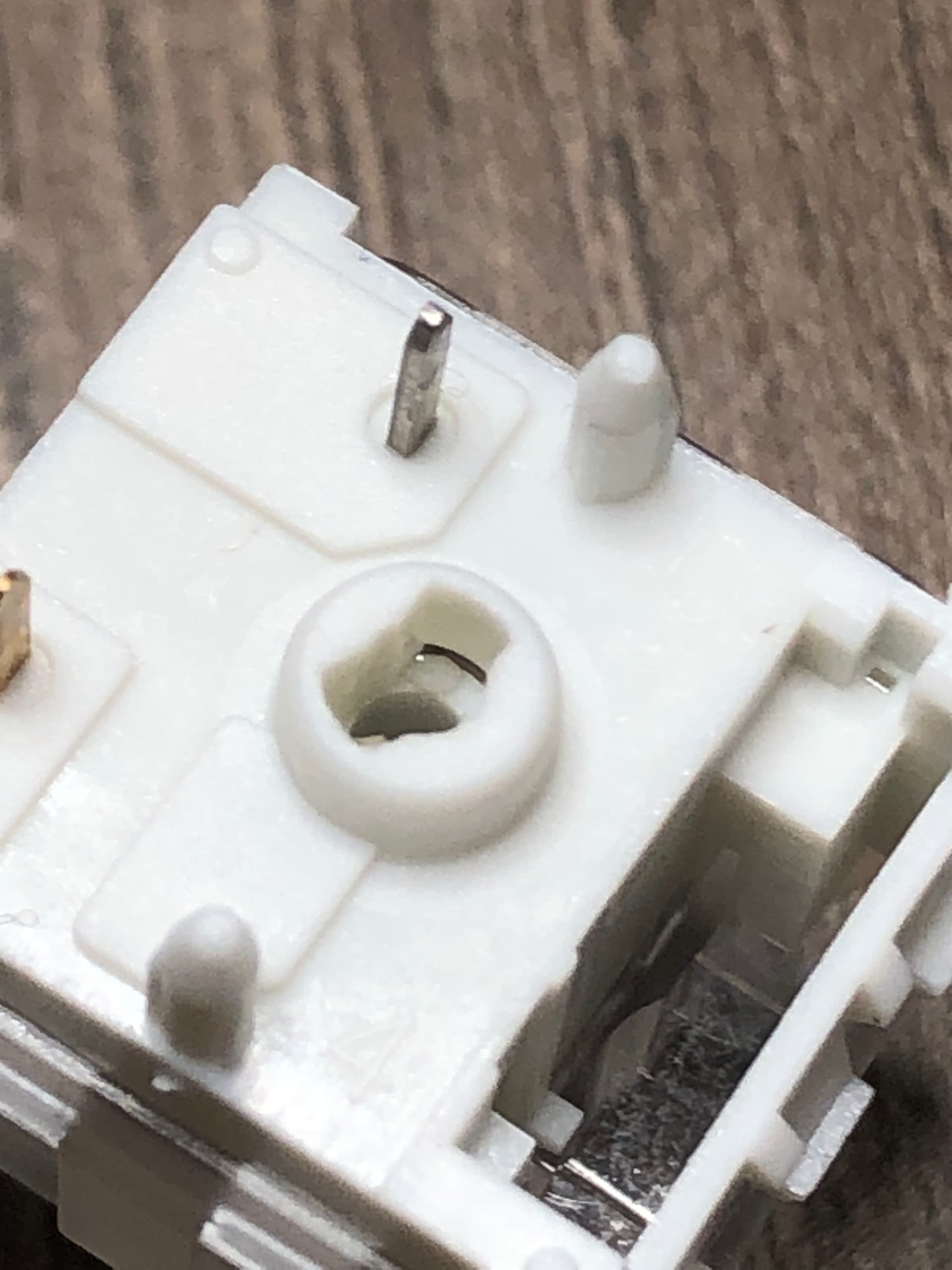

The other side; looks like drill shavings and such:

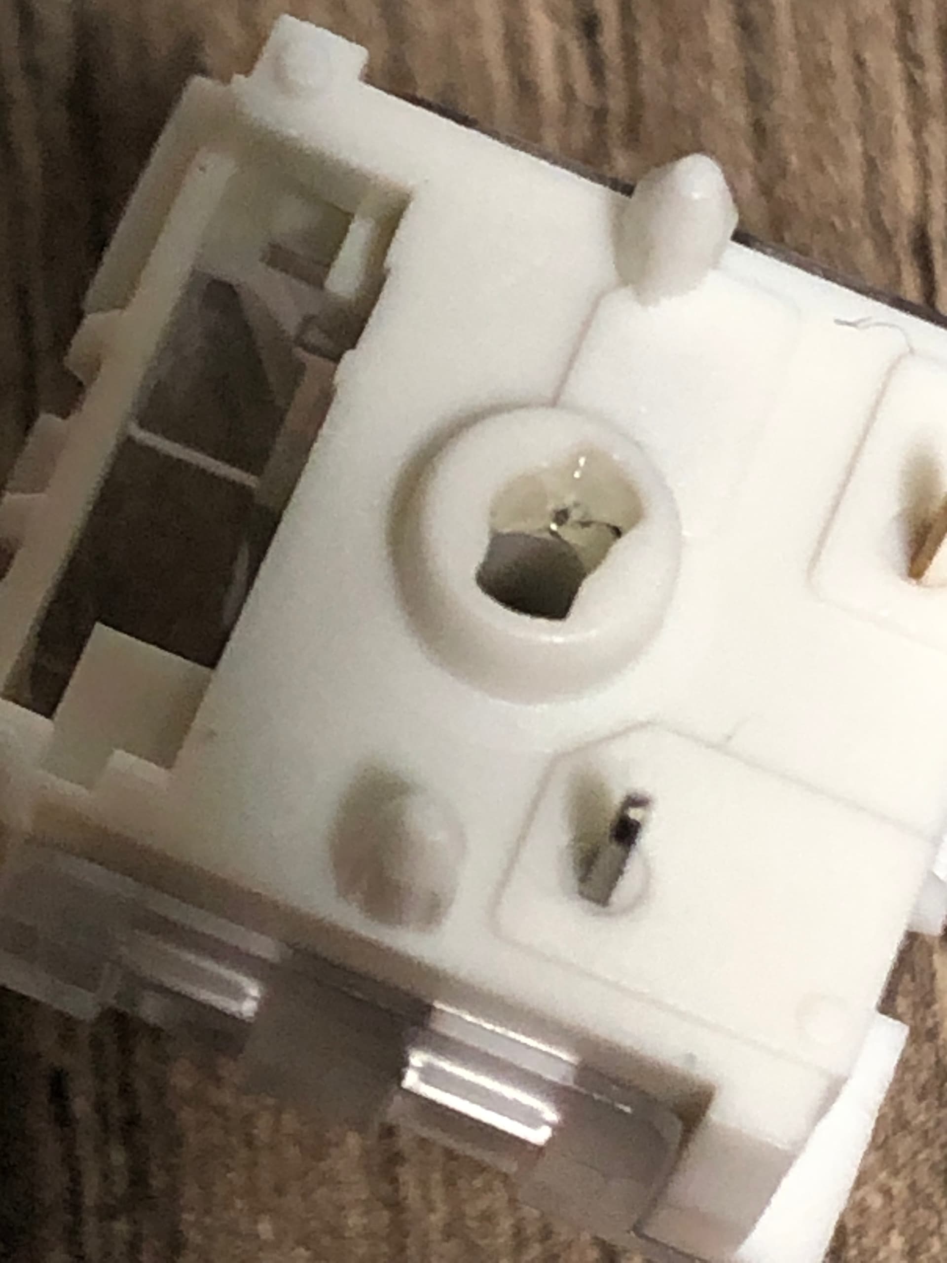

Moving the light, though, you might be able to see it’s just grease distorting the other narrow port:
Just beyond that greasy port is where the stem cam sits when the stem is depressed.

You can also see that on Gateron Cap series, they claimed that will make pushing down feel better, while there is an extra amount of grease accumulated around the stem. They have updated the mold and there are some older versions with a clear mark of the hole being filled at the bottom, but after that version, the hole was completely gone.
