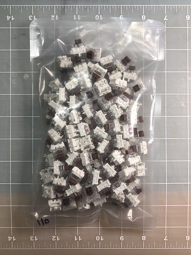

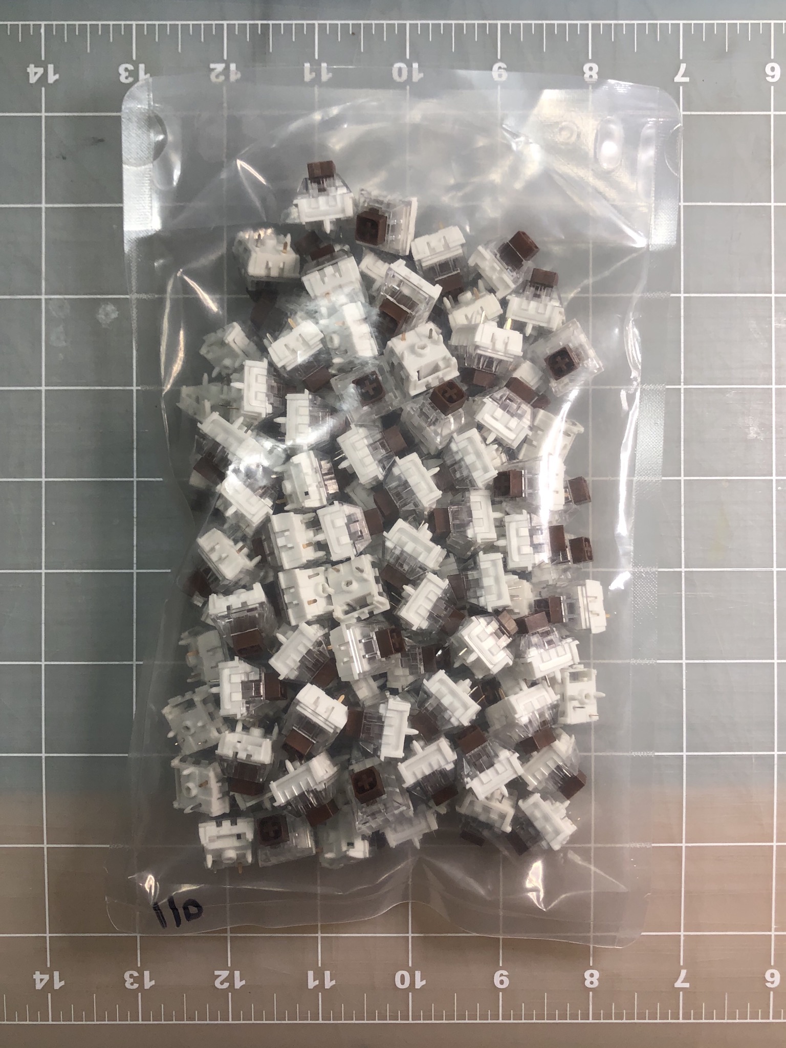

Here they are. @insolentpotato - I’m not surprised they made it, but I am surprised how quick they got here. I got shipping notification within 24 hours of ordering and it only took a few days to arrive - definitely a quicker turnaround than I expected, especially since they aren’t a direct retailer.

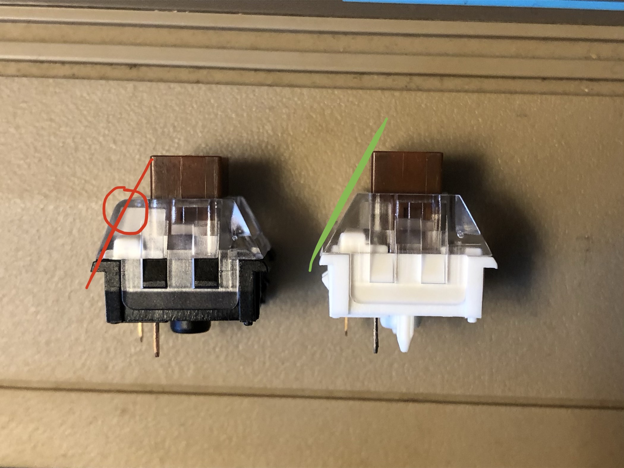

Slapped this image together while explaining clearance to a buddy who wants a relatively inexpensive RGB keeb with Cherry profile caps - figured it might be of use to folks who find this thread via search.
On the left is a standard Box Brown (black bottom housing because they were pre-installed in a black keyboard), and on the right is an Art Box Brown.
The doodley lines show where the clearance issue happens with the regular ones - which unlike traditional mx-compatibles, don’t have any functional parts in that space.
Very helpful, thanks.

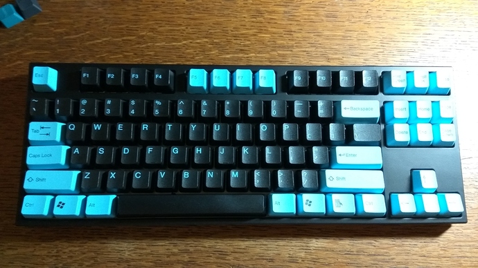

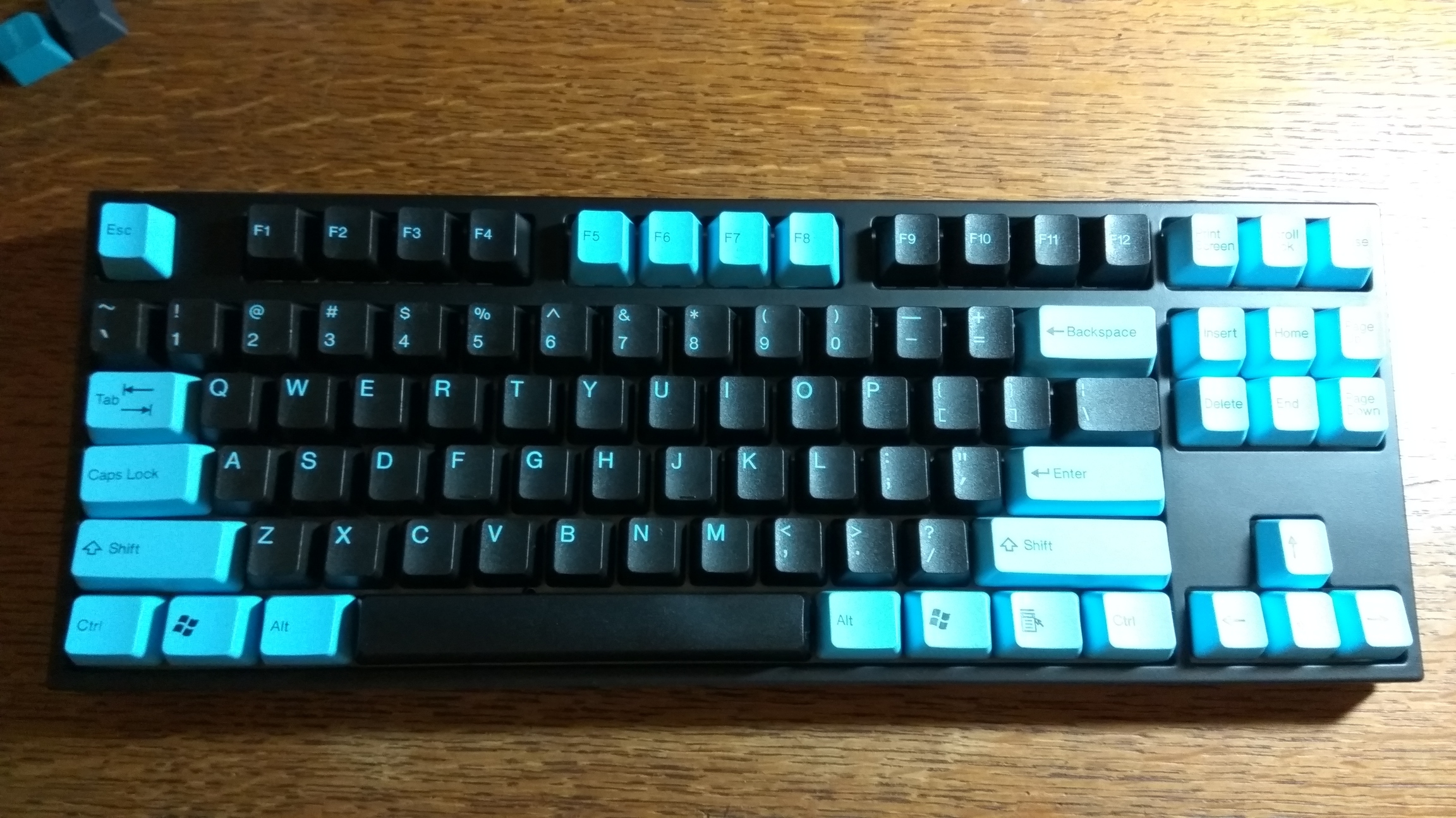

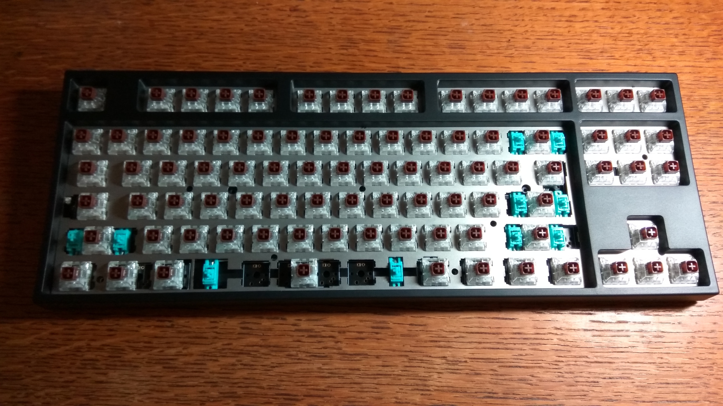

Okay, my XD87 with what should be ART BOX Brown switches arrived today:
You can see that the stabs are matched to the Tai Hao Pulse keycaps:
[This was unintentional, but awesome.]
You’ll notice that the Caps Lock key is crooked. I’m not sure if this is BOX being BOX, or if the Tai Hao stem is misaligned. Then again, it could be the board design, as that Caps Lock area looks strange.
With regard to the ART BOX Brown, I did not have the opportunity to test them before the build. They are clearly BOX Browns, and emulate its characteristics. The word “Kailh” is embedded in the side of the upper housing, IIRC.
One difference that I would note is that the ART BOX Browns appear to be a little grittier / sandier than regular BOX Browns. I have a batch of regular BOX Browns from Novelkeys in hotswap, and I would say that those are smoother. Both versions of the switch are very crisp, crisper than Cherry Brown. But I think the ART BOX may have some Cherry-like sandiness.
One thing I would note is that the Art BOX Browns crash down pretty hard on the XD87’s metal plate. It seems harsher than usual. I’m not pressing hard or anything, but these switches do slam. You might want to think about that before putting BOX switches in an XD87.
That’s a beefy looking TKL. Very nice.

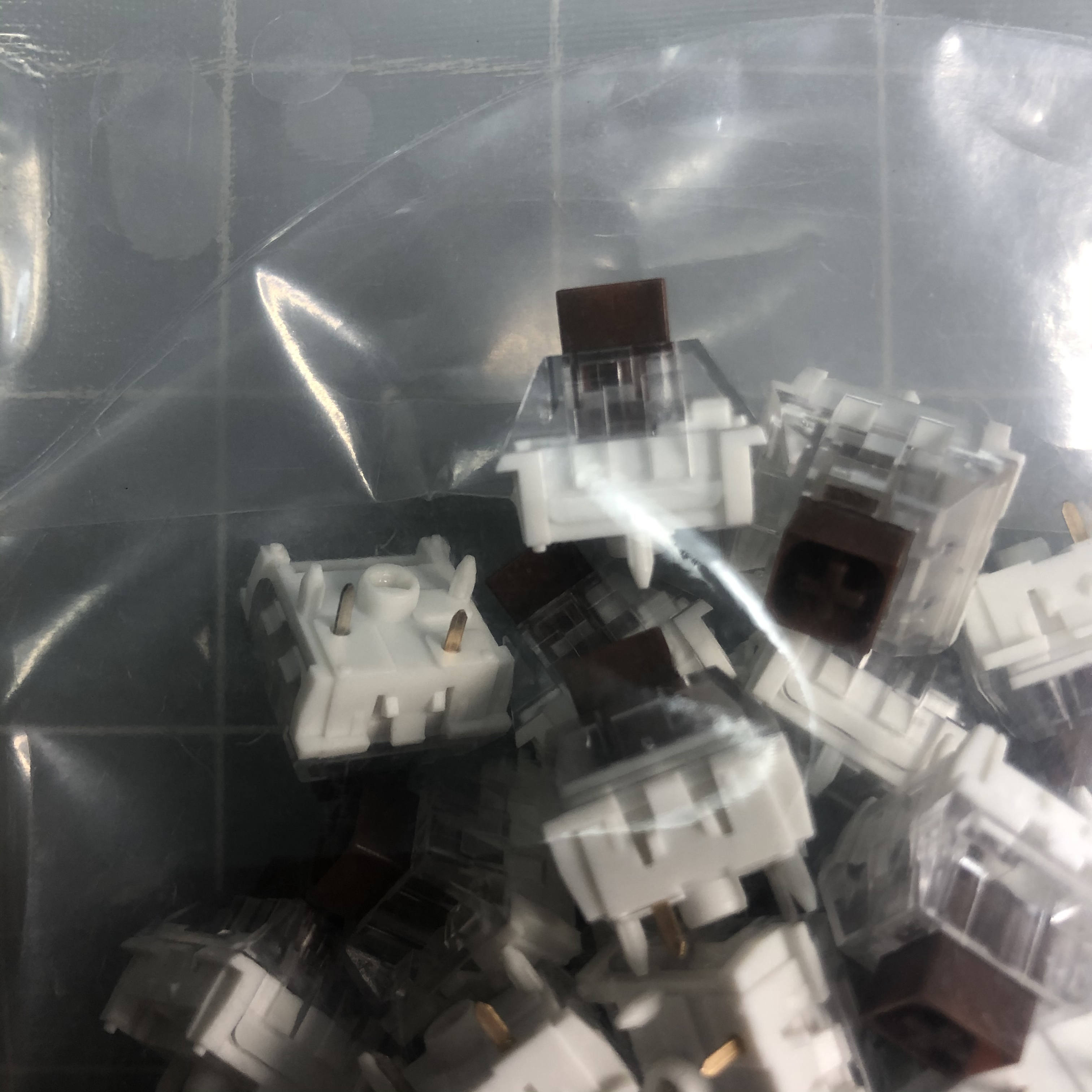

Can confirm those are Art Box switches; they have the branding on the side instead of the back / front. (Silent Box Browns are also like that, but they have a round stem and only come in the 3-pin flavor as of now.)

Edit: About the crooked cap - try sticking another cap on that switch and see if it is similarly mis-aligned. I’ve had cases where the whole switch was rotated a tiny bit, I’ve had others where the switch stem was slightly flawed and twisted (the Box switch thing), and most commonly, I’ve had twisted stems on keycaps.
Yes, there are reports of people lubing BOX Browns with 205g0. Thanks for the lubing tips. I find that BOX Browns don’t always need lubing, but maybe it could vary by batch.
Yes, I’m going to test different caps eventually on the Caps Lock, to see if the keycaps are causing it. I have another set of Tai Hao here, for instance.
