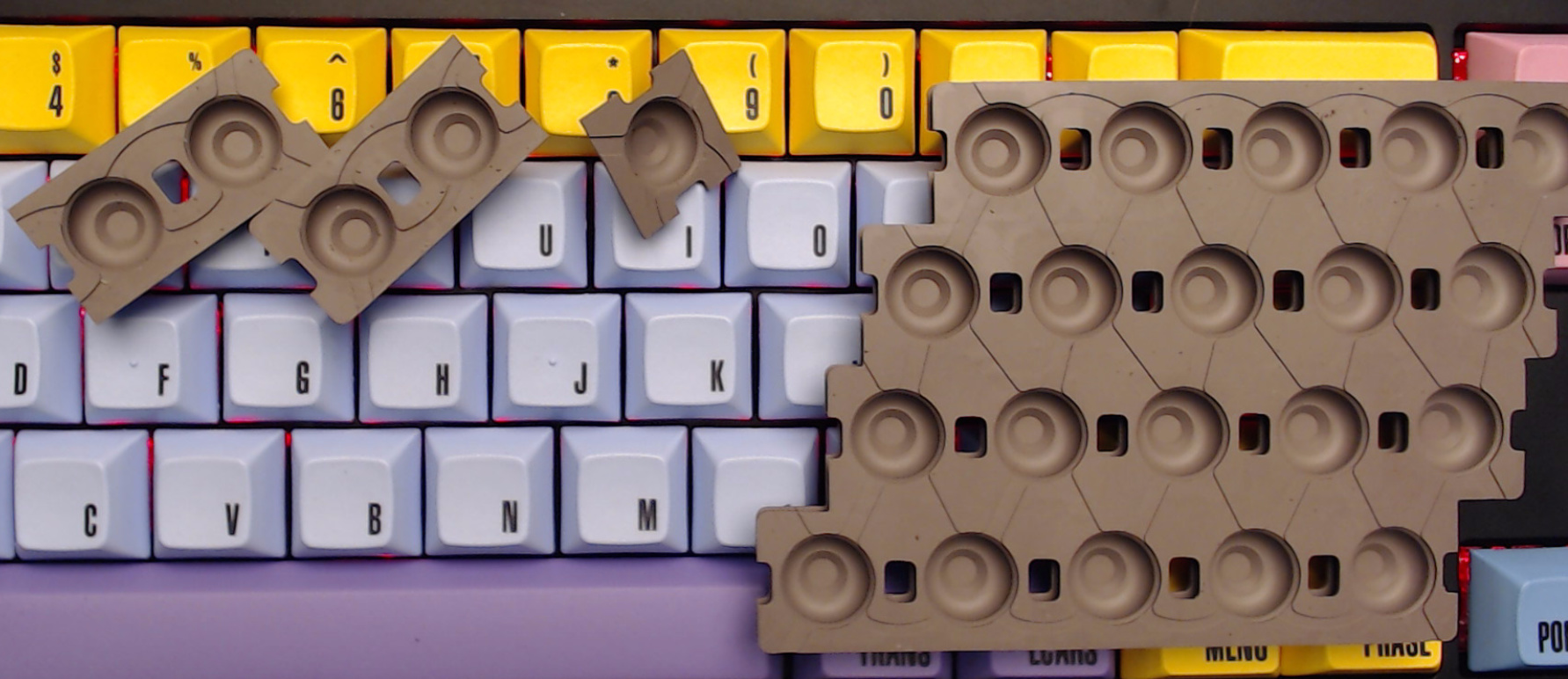

Are these stock topre domes?
Hey there, I’m completely new to the Topre world, so forgive my ignorance, but are these stock domes?

The /r/mm post says it has BKE lights, and I ordered and replaced what was there with BKE heavies already, but the pictured domes are what came off of it. As far as I can tell, these are stock Topre, not BKE lights… can I get a sanity check from someone else who knows better than me?

Pretty sure they are stock domes, they come in sheets/pairs/threes/singles like that. The BKE domes only come as singles as far as I’m aware, both the Lights and the Ultra Lights that I’ve had came in packets like that anyway.
I guess that’s not as advertised, which isn’t great, but TBF you can’t really buy stock Topre domes separately so perhaps it’s better that way? Means you can give the stock experience a try if you feel like it. And you can buy the Lights from somewhere if you wish at a later date.
I used to have Lights in my FC660C, but eventually realised that the stock domes actually suited my light typing style more. The sound ends up being a bit lower in pitch too, I think due to the closed tops of the domes unlike the BKE’s open tops which lets more of the spring noise out. I still have the Lights though, and might switch back at some point if I feel like my typing style changes much, I use some of the Lights in the Esc and Insert/Delete keys anyway, where they work well.

I have no desire to use the stock domes since I prefer heavier tactility, but it is what it is… I suppose I could contact the guy and ask wtf that’s all about, but maybe I just got ripped off for the increased resale value of the domes.

Definitely stock 45g Topre domes, pretty messed up of the seller if this was done on purpose. Although at the asking price of $250 it wasn’t a huge ripoff thankfully. 980Cs go for $250 brand new & you got MX sliders + silencing rings with it for that price so it wasn’t a terrible deal. Still that doesn’t excuse the seller from not being truthful about the domes.
For future reference, the BKE Redux lineup all come as individual domes, not sheets like in your picture. That definitely looks like stock 45g Topre to me. Stock 45g is that color, while stock 55g is black. :slight_smile:
Yeah I figured that was the case since my heavies came as individuals, and like Rob27shred said, it sucks that I didn’t get what was advertised, but I got a good price on what I got either way. I am only bummed I unexpectedly didn’t get the opportunity to try the lights… I type heavy most of the time anyway, so it’s all good for the times I decide to use this board anyway.
