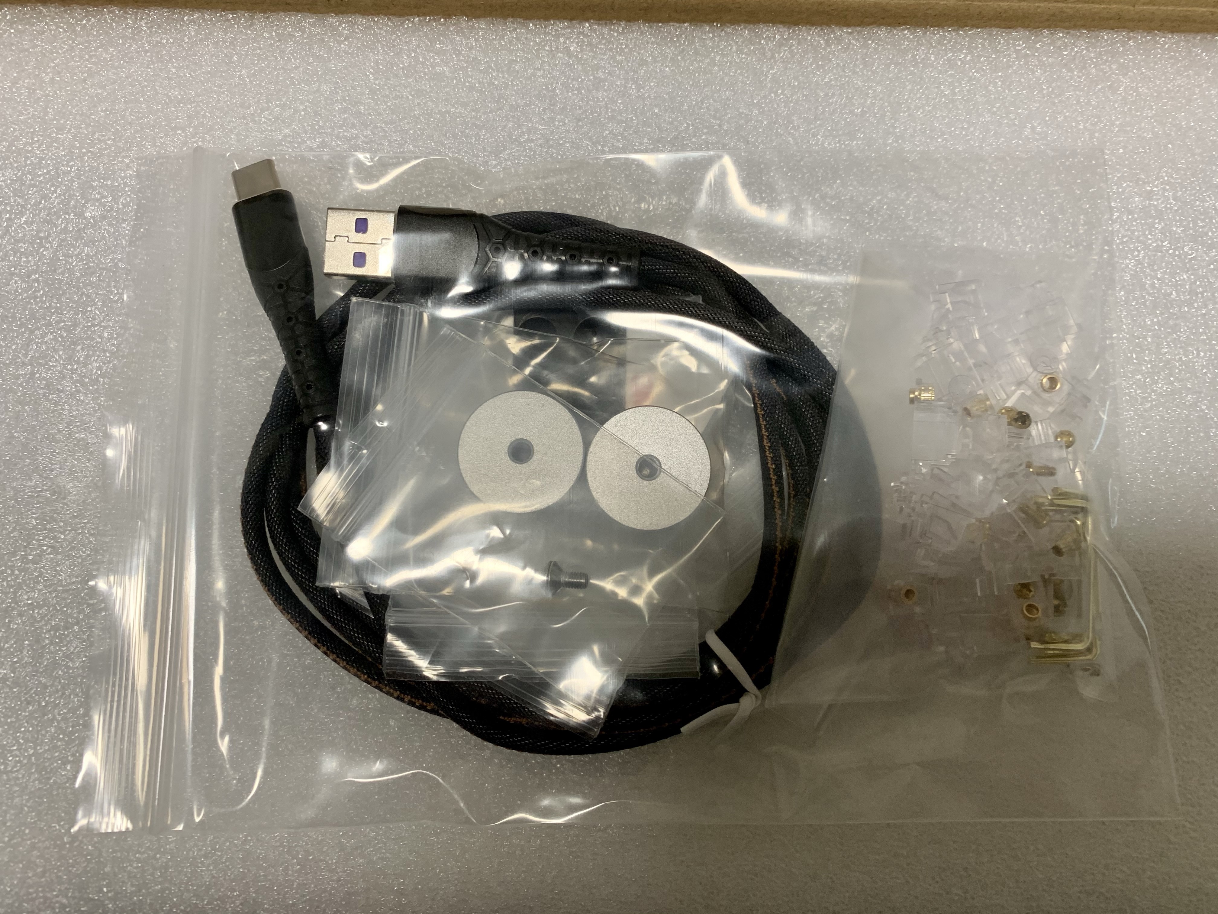

The YMDK Wings got here very quickly, it even included a cable, conical metal feet, and what I think are stabilizer parts:

The included cone feet unfortunately had the wrong size of screw, but I had another pair I could use. The bottom of the board also has very clean countersinking for the feet screws.

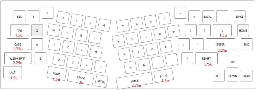

The default firmware is mystifyingly odd,
just look at that bottom row, and the top-right modifier area where one key is another space key. The good news here is that unlike many Arisu and Alice layout boards, you won’t need a second B key.
I remapped m0 to be on capslock using the YMDK configurator site that just compiles their fork of QMK for you. but that is a constant reminder that this board isn’t in stock QMK.
