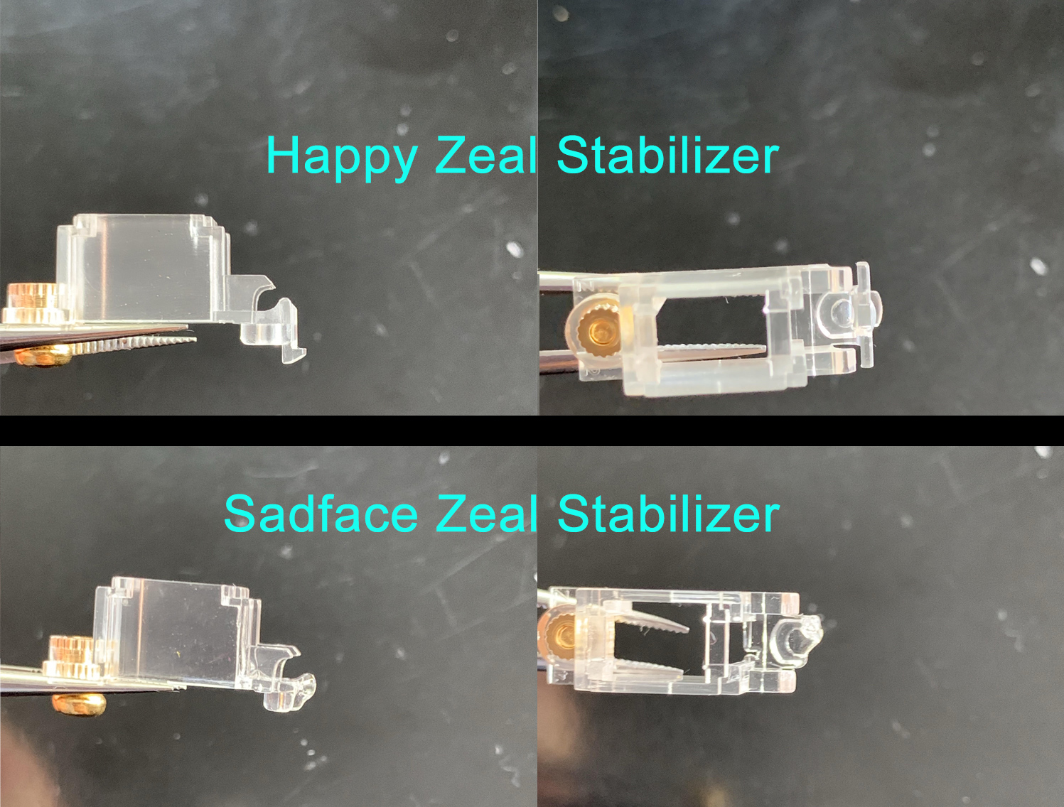

So, this is a thing. It’s probably a very small thing but I was unlucky enough to have 3 stabilizers that were defective in my last batch I ordered from zeal. I have spoken with another community member who also had the same defect.
You would think after building dozens of keyboards I would have noticed it in advance, but I managed to build a keyboard a few weeks ago with one of these on the space bar. DOH. The wire pops out, and will not stay in b/c it lacks the proper supports to lock it into place on the bottom. Guess it’s time to get the desoldering iron out.

I’ve always been able to get them popped back in, but in this case the support is missing… so they don’t actually every fully pop in from the start. Again, you think I would notice, but alas…

I hear you, but you would’ve had to really look close at them to notice from what I can see in your pics so I bet I would’ve went ahead with using them also. I think something similar was up with the original stabs I built my acrylic Clueboard with, well at least the 2u ones that were originally on it. I could always get them back in place, but they never would stay there. Finally I just replaced them with GMK screw in stabs when I swapped the switches from MX Whites to retooled MX blacks.
