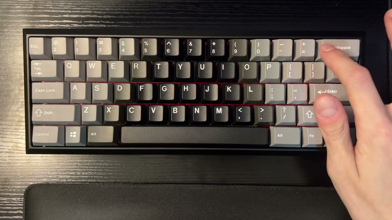

Here is a sound test of an MX Brown board with some rumble:
In terms of quietness, you really shouldn’t have too many problems with any regular full travel switch. IIRK, plateless keyboards tend to be on the more quiet side, so as long as you don’t go for an extremely long pole switch (unless that’s what you want) you should be good on sound level.
In terms of silents, I wouldn’t recommend them unless you’re going for a full silent build. I’m typing on an open-bottom, integrated plate Minivan on top of a wooden surface with silents and it’s barely making a sound, so I would recommend going for some full travel switches instead of looking for silents.
This is totally personal preference, but I would go for something like MX Blacks, Gat Inks, or Momoka Frogs. MX Blacks sound great in anything, but most people like breaking them in (pressing them many many times to smoothen out any imperfections) and spring swapping them for a lighter spring. Gat Black Inks are a similar story, they are very smooth out of the box but the spring might be a bit too heavy for some. Momoka frogs, however, are quieter than other linears while being silent. I don’t really have any complaints about them from the few spare switches I’ve tried but maybe it’ll be different on a full board, who knows.
Here are a few vids of Gat Blacks Inks and MX Blacks on plateless:

Some recordings just to get a general idea of what some of these sound like:
Frogs (high-profile caps in the recording, so a bit more loud and deep than they would be with Cherry or OEM):
North Poles (Aqua King alternative):
Unholy Trues (an example of that fast-curve frankenswitch type I mentioned):
Silent Bluish Whites - in a Portico:
…and in a KBD67 Lite:
Frozen Silents - in a Portico:
…and in a BBOX 60 (hollow plastic tray-mount, really amplifies any switch mounted in it):
