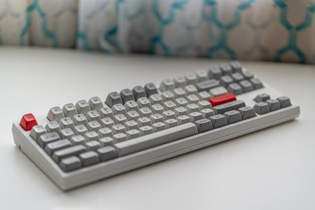

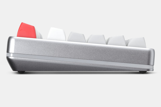

Here is what they show on their website:
This is what I got (this is not my photo, it’s from someone else’s board, as I was not about to install all the keys just to show how bad the color is when this photo does it justice).
Not even close. The red accent Esc button is shown as a bright, light, almost salmon red. What they sent is a dull, darker, dirty red.
Then it shows bright white alpha keys. What they sent me was a dirty, brownish tinged light grey.
And then it shows a very clean light grey or silver for the modifiers. What they sent was just straight up regular grey (almost veering into dark grey), with again, a dirty tinge of brown.

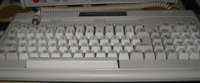

Regarding legends, I agree that they are often large. I wouldn’t mind something like a Tandy 1000 keyboard, but with smaller legends:
