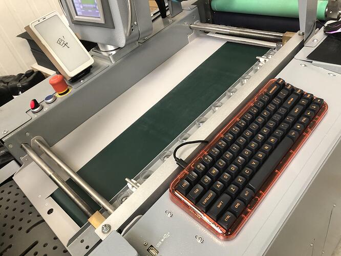

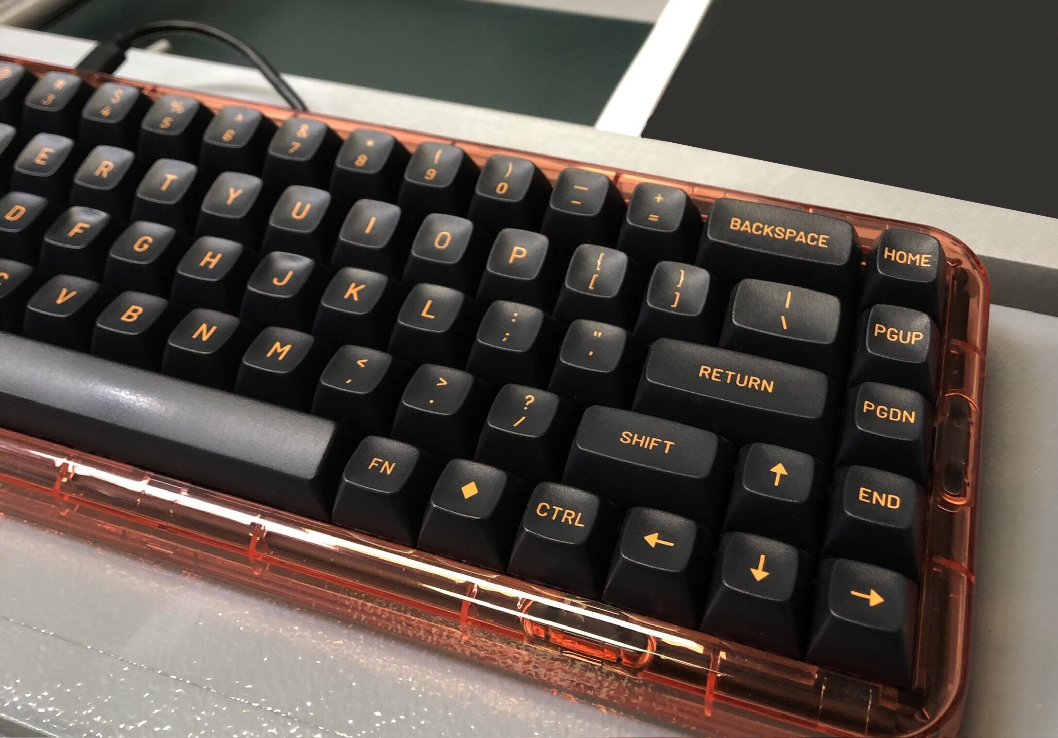

- MelGeek Mojo68, as configured on my desk today: this is an all-plastic prebuilt 65% hot-swap tri-mode RBG keyboard from a few years ago, and I have some dampened linears and those ABS MT3 keycaps I mentioned on it. I bring this one up because it’s a prebuilt that’s very easy to get a deep sound from, and if you really want one for less than the $200 MSRP I bet you can find one used. Here’s what mine sounds like, complete with stabs that haven’t had attention in years:
All the stuff I mentioned above plus a little more is helping this keyboard sound deep:
- Plastic, roomy case
- Tall, thick keycaps
- Dampened switches tend to make a deeper, if softer sound
- Like the other two, it has a plastic plate and dampened mounting
It looks like this - mine is the “pigeon” colorway, but it comes in a bunch of colors:
Here’s the “desk” I’ve been using it on, the control station of a print embellishment machine:
That thing that looks like a phone with my avatar on it is actually an e-ink Android device I use for writing - it’s like an endless notebook with a bluetooth connection to my keyboard. (A benefit of all three keyboards I mentioned here is that they can easily connect to devices like this, or your phone.)
