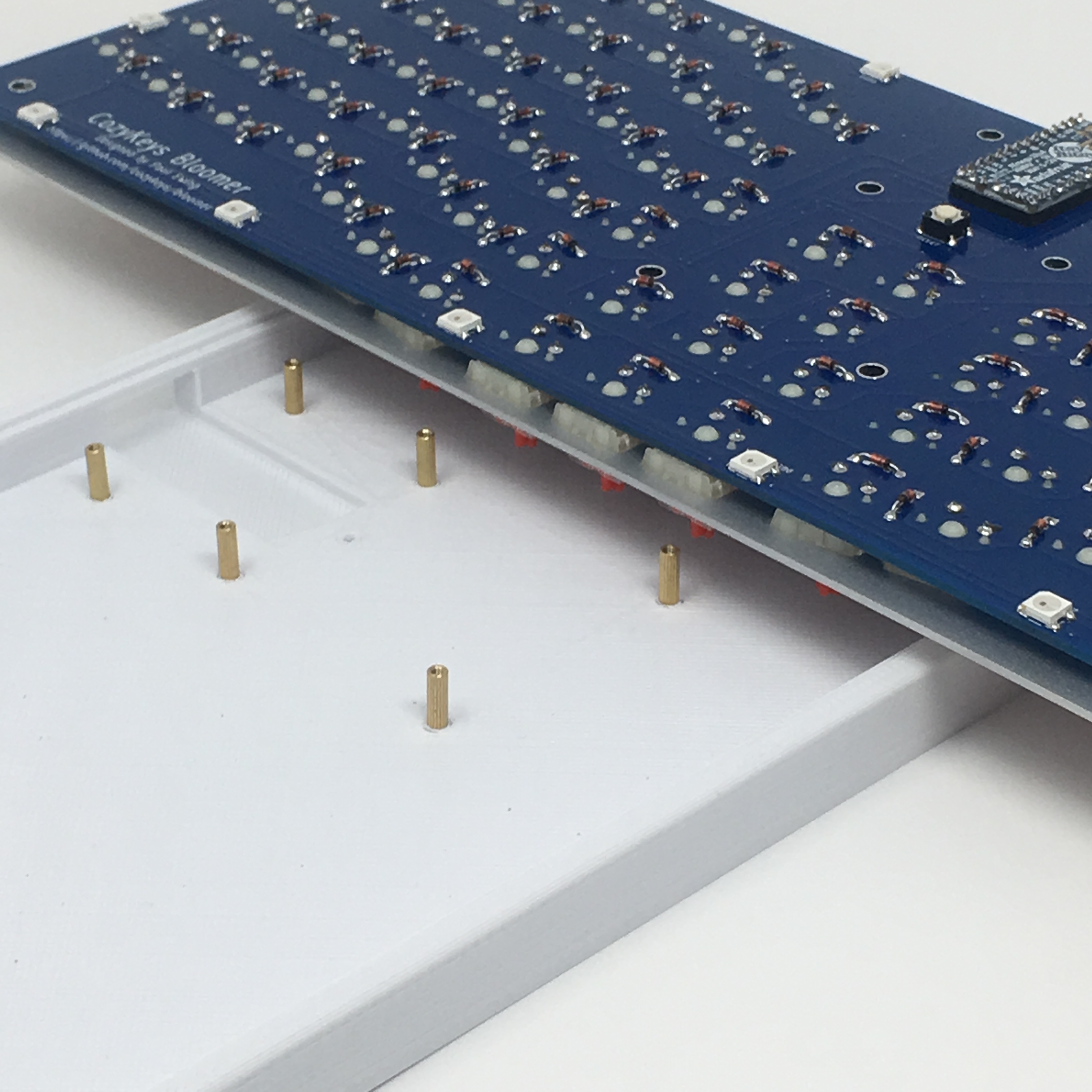

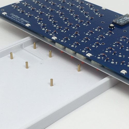

I did run into a minor issue with my case. I forgot to extend the depression in the case that allows the controller to fit past the reset button:

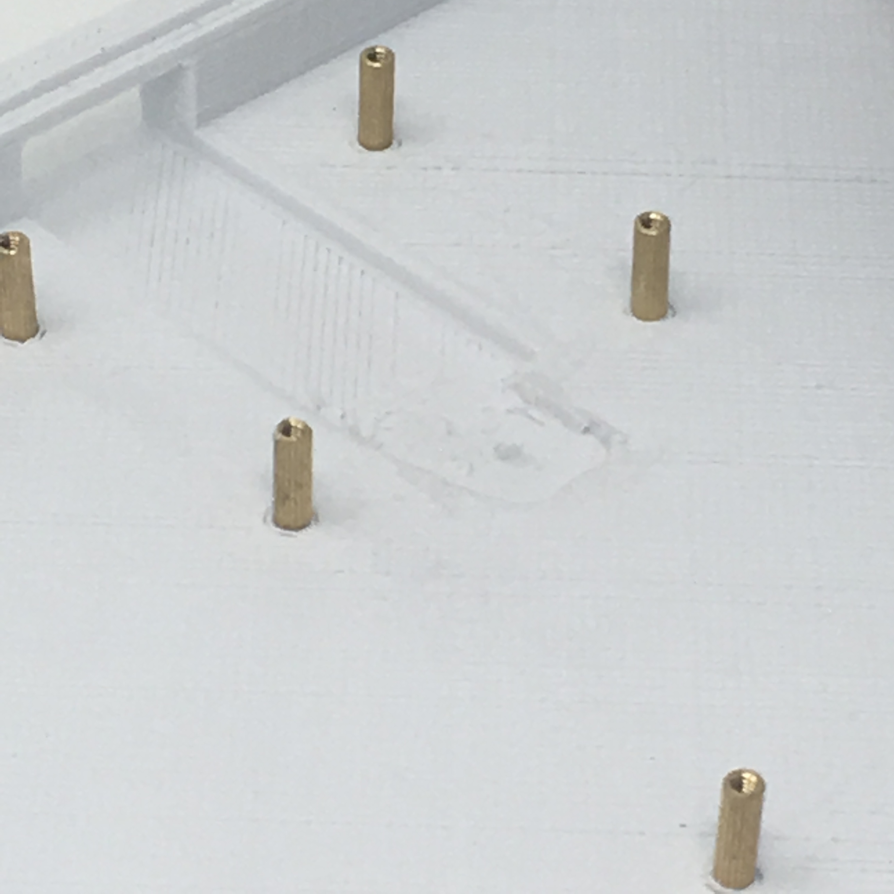

As a result, the keyboard worked when I tested it and then when I placed it in the case it was unresponsive because the reset button was held down by the case. This took me an embarrassingly long time to realize. To fix it I dremeled down the case which was a bit messy due to the nature of PLA:
It should be pretty easy to fix so I’ll make those adjustments to the case.

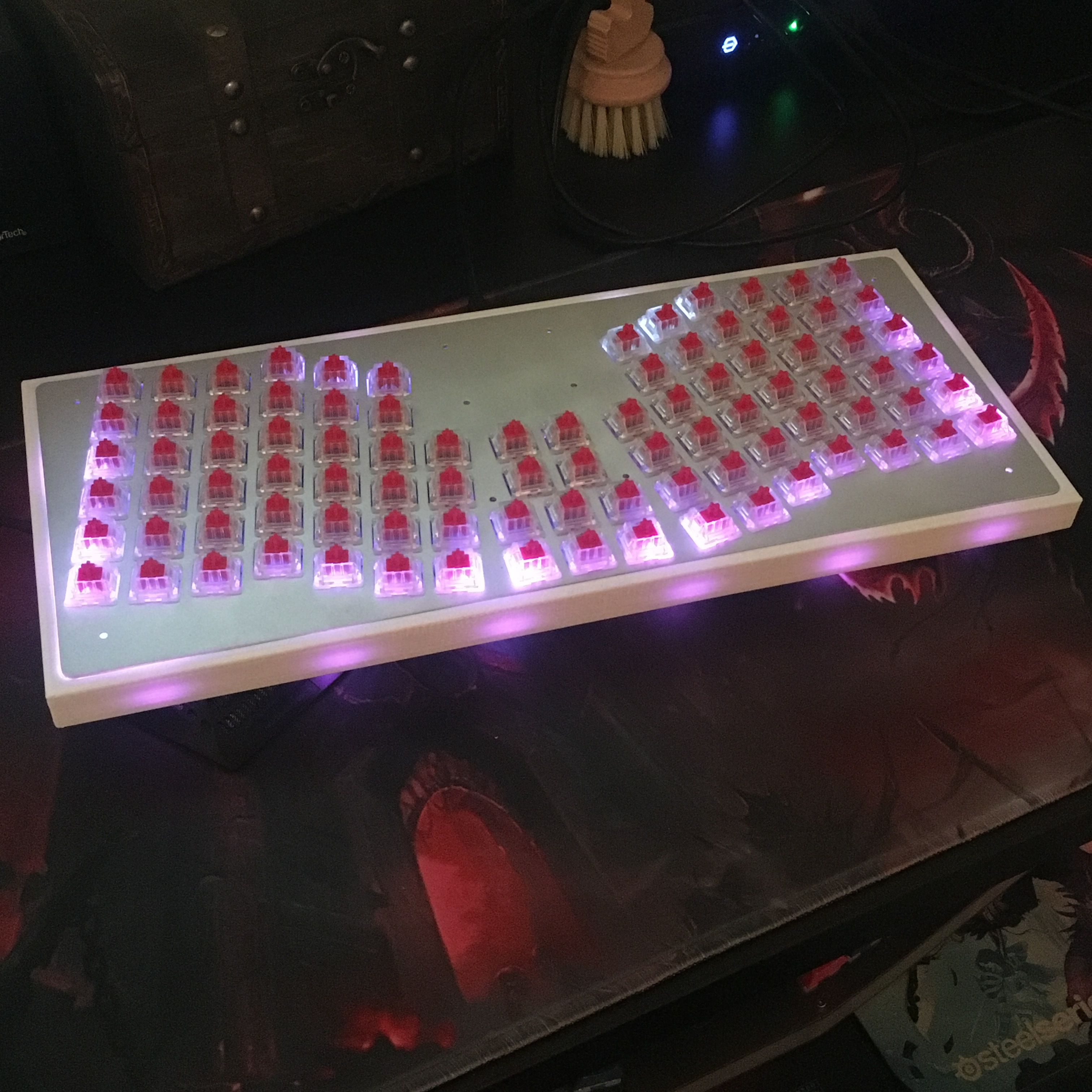

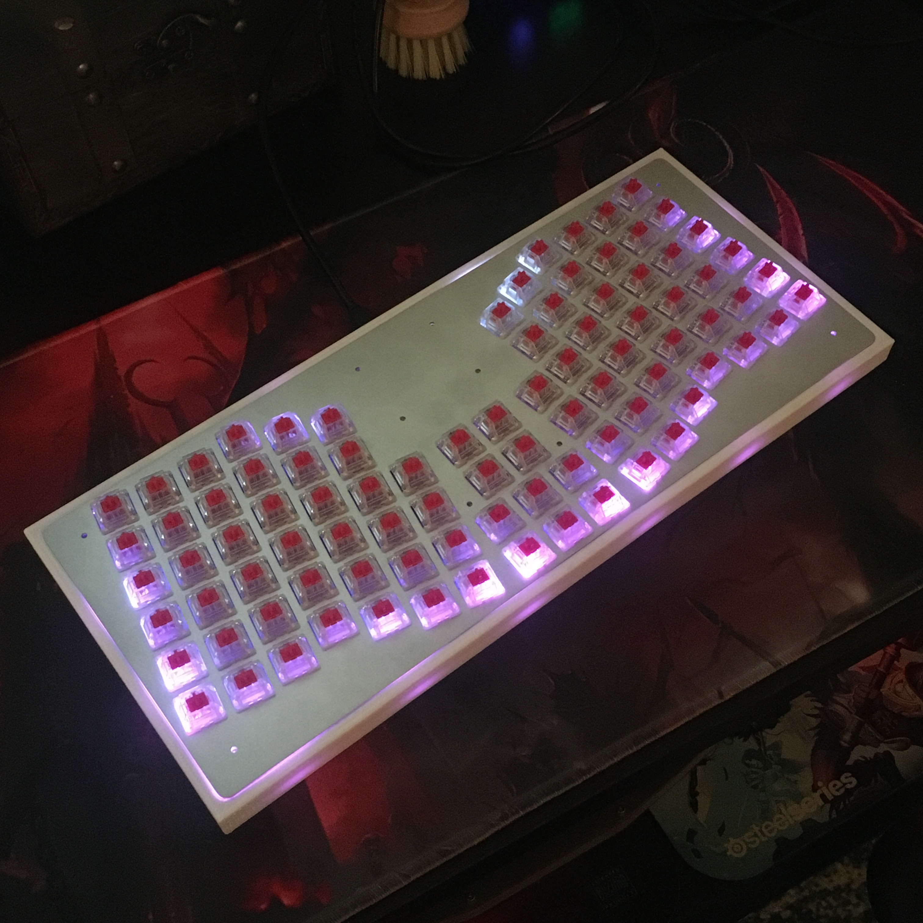

All in all I’m pretty happy with the results:
Sadly, 5mm of white PLA is a bit too thick to diffuse light so the RGBs aren’t very noticeable but if I ever feel like forking over more dough I might try a CNCed polycarbonate case.
