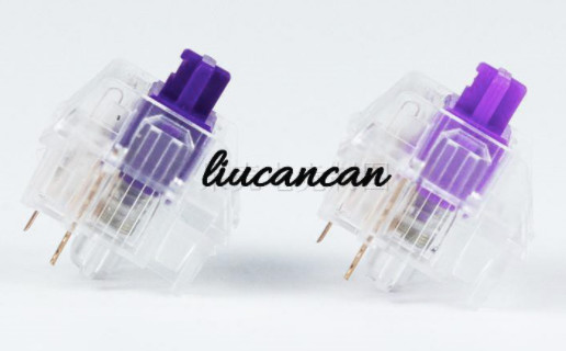

-The builder made the most interesting Pro Purple in a Boba that I have experienced so far. It is a Pro Purple Stem in the white Boba housing with a 65 G TX spring. Lubed with 205g0 and also filmed.
This Boba makes a deep, muffled sound. Pro Purple is not a silenced stem, in fact is very loud, but actually sounds almost reasonable in this arrangement. Tactile force and weight is like a heavier Brown, kind of like what BOX Burnt Orange is to BOX Brown.
I could almost see myself typing on this. I’m not sure there’s any real reason to build it, but this is the best Pro Purple in a Boba housing.
