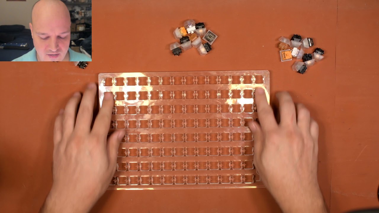

Brown Switch Blindfolded Shootout!
Competition between 8 different mild tactility mechanical keyboard switches: Cherry MX Brown Gateron Brown JWK Pewter switch Razer Orange (made by Greetech) Razer Orange (made by Kailh) Kailh Pro Purple TTC V2 Brown switch (orange housing) Which feels and sounds best? Let’s find out! P.S. - You can buy Gateron cap switches here: https://dangkeebs.com/collections/swi… Not sure if pewter switches are currently available anywhere

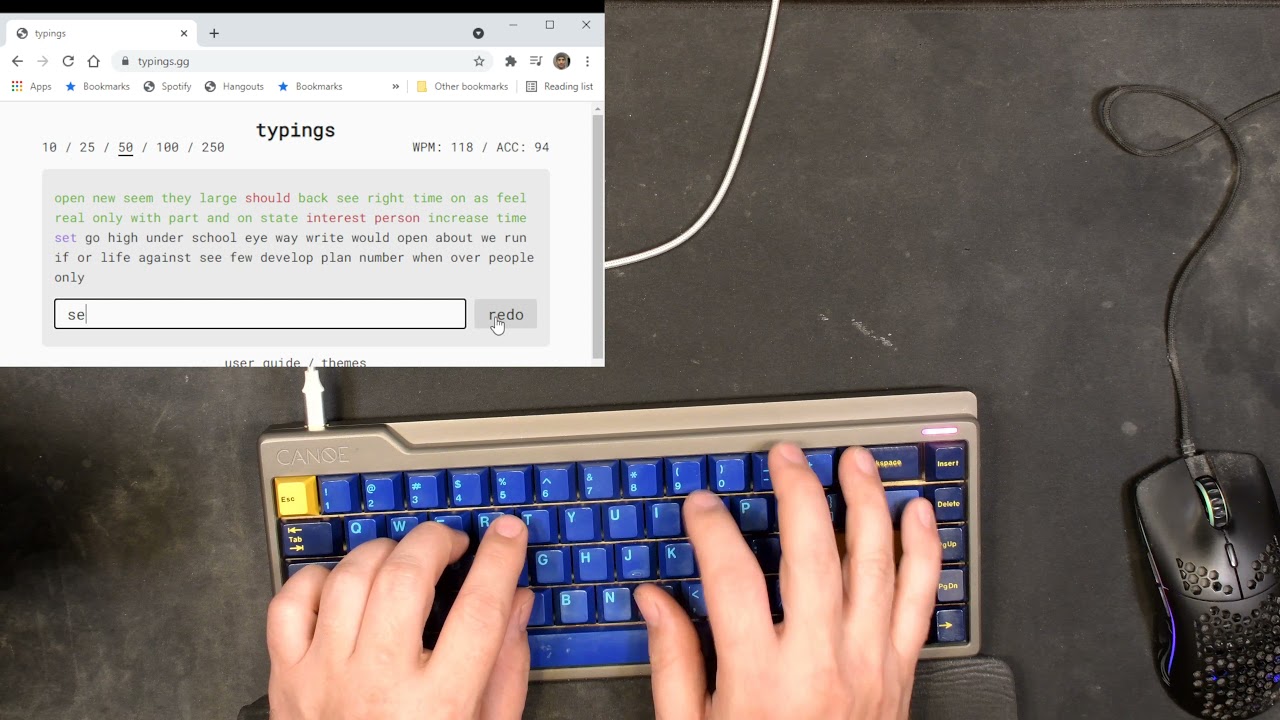

Here’s a typing test with the Gateron cap switches
Interesting concept!
That’s one way to address the scratchy housing.
I put Pro Purple stems in Boba housings. They fit and function, but it wasn’t anything special. Let us know how the Ink’s work out!
Those Gateron Cap switches sound very pleasant and subdued for a Gateron. Did you mod them?
I have not modified them
