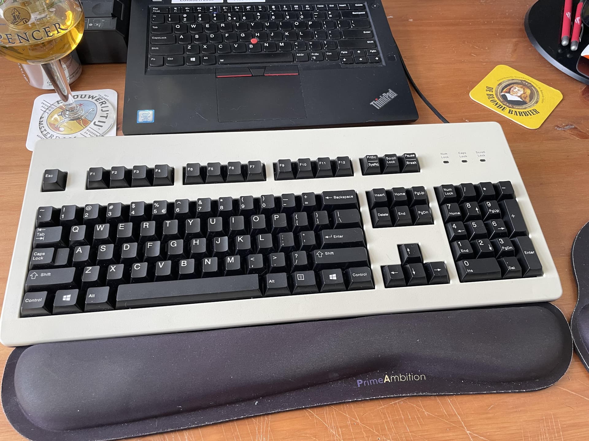

Saw this posted over in r/mk but the person who posted it hasn’t given any info, so I figured I’d share a picture of it here and see if someone recognizes the model.
Just looks like a Cherry G80-3000, possibly repainted original case or with an Alu replacement case.

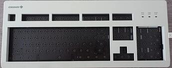

I think ventamora is right, it’s a Cherry G80-3000, either with no logo or the logo painted over. Here it is with the logo - the LED area is identical.
Yep the two posts above me are right it’s just a modern Cherry G80-3000. They’re actually pretty nice boards with a little elbow grease & the switches + stabs can be modded without desoldering since they are plateless.
