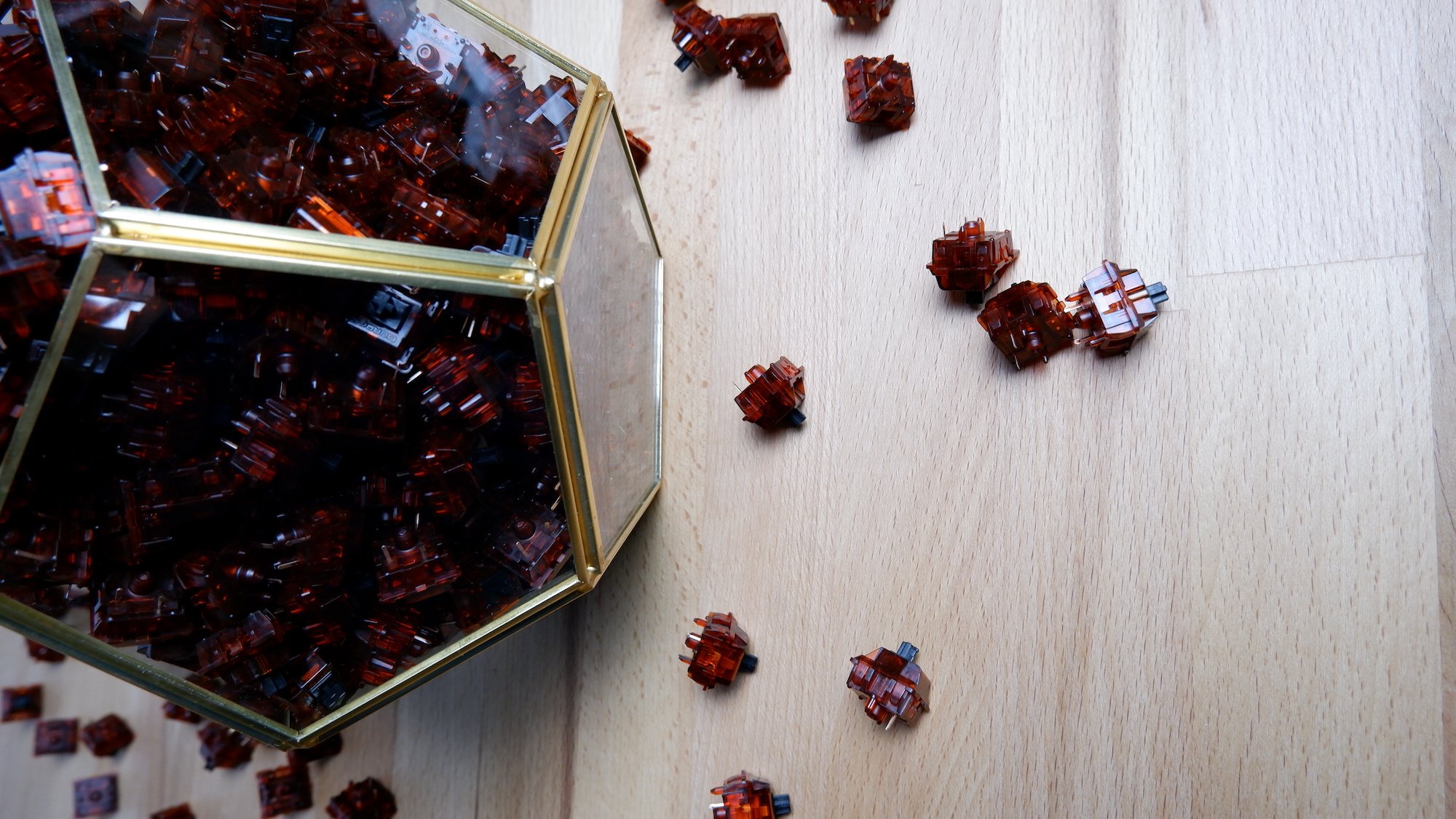

I really don’t need any T1s.
…but I need these T1s.
I know I said somewhere sometime that I wanted keyboard parts that look like Bakelite - well. These definitely cover the switches.
