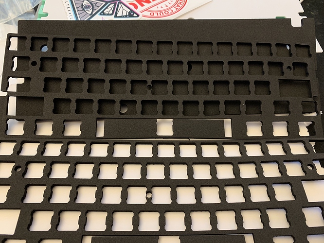

Just got my foam in. It’s as good as you can imagine. Big time saver and huge sound changer. Just thought I would drop the link here for others interested. I’ll be ordering more.

MINI REVIEW
Installed 4mm Tsangan foam between 1.5mm brass plate and KBD6X PCB and a white 2mm black 4mm bottom foam between the PCB and Tofu case (read tray-mounted).
Installation: Very easy. No problem at all.
Feel: Feels softer, as if the foam between the plate and PCB is offloading some of the force when bottoming out.
Sound: Pitch seems a bit lower. Sound is subtly rounder and cleaner. What’s far more significant is that sound of keys on tray-mounted keyboard are much more uniform with the foam. Variations in pitch and volume still exist but not as much as before.
BOTTOMLINE:
- Highly Recommended for tray-mounted keyboards.
- Recommended in general for cleaner rounder sound and feel.
UPDATE1: Switched from 2mm to 4mm bottom foam to address echo from the ~1mm gap between PCB and case. Needed to use longer screws as well as add bottom screw, which usually leave out, to reduce height of the bottom row. It’d be nice if they offered 3mm bottom foam. I’d also be interested in 5mm sandwich foam for plateless build.
