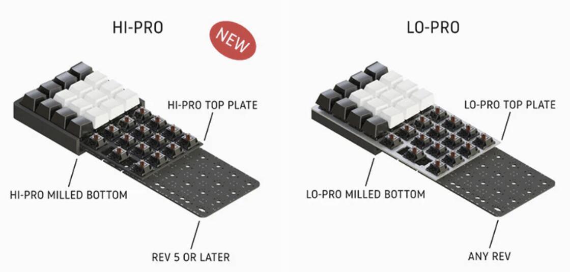

I think you may have the “lo-pro” case based on your description of the plate sitting on top of the case:
The only one that Drop sells (to the best of my knowledge) is the “hi-pro” variant, which is a traditional tray mount design:
Yes. I have the original “lo-pro” version.
