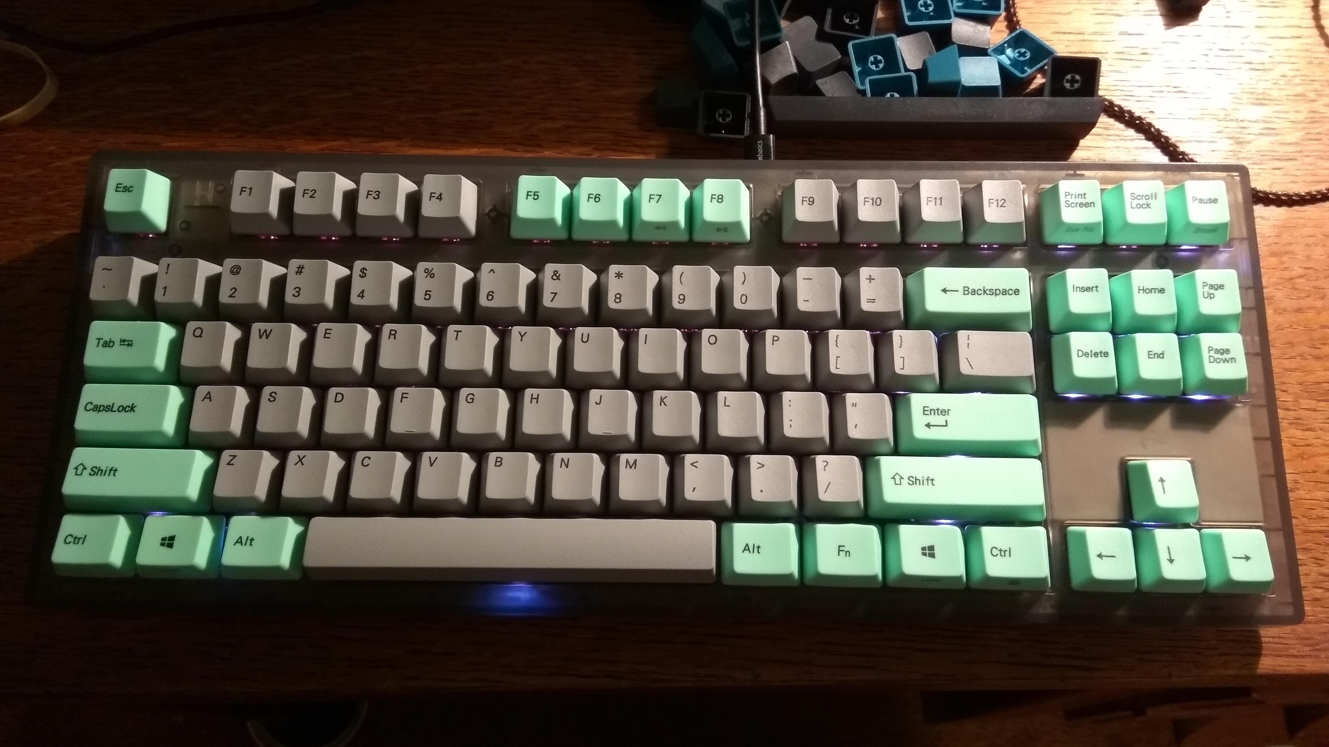

Mine has the polycarbonate plate and was recently finished. It has Zeal PCB-mount stabilizers. Honestly, if you install the polycarb plate and PCB-mount stabilizers, and do some kind of ‘gummy mount,’ you almost have what a KBD8x Lite would be.
On the other hand, there is a disadvantage to the MK870 with polycarb plate, and that is the hotswap sockets are extremely tight. I am not sure about going through too many cycles of removing switches, given how it puts pressure on the plate and case.

Just a few words of warning: 1) again, the polycarb plate makes switches fit very tight, so probably not good for repeated hotswapping. Put in the switches you intend to type on. 2) you may have to download drivers from the Chinese website to adjust the LEDs. 3) Taking it apart to put the plate it can be annoying because housing uses tabs to hold together. This is more frustrating than dealing with screws.

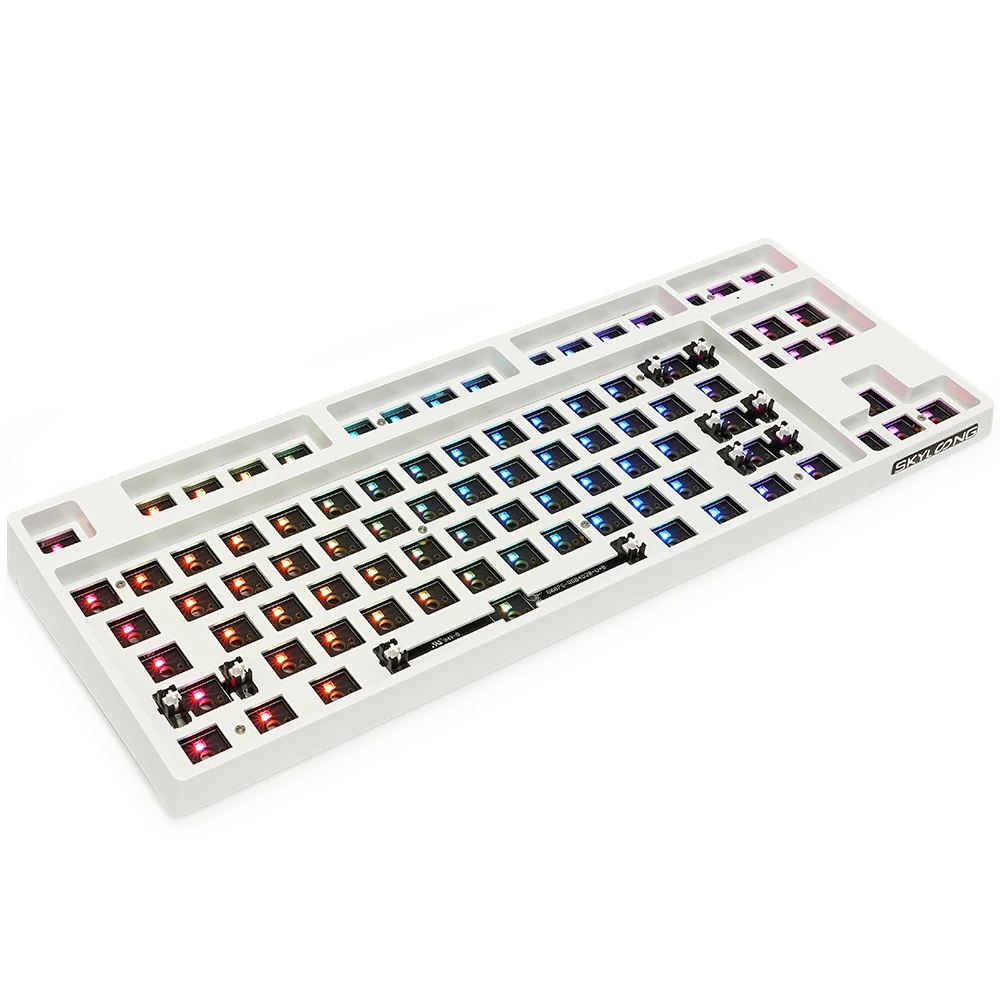

I can’t find the unbranded RAKKs currently on AliExpress, but they have other popular hotswap TKLs that you can often find reviews for on Drop or similar websites.
GK87:
and SK87:
https://www.aliexpress.com/item/1005001527564131.html
MK870 for around $70 USD or so:
