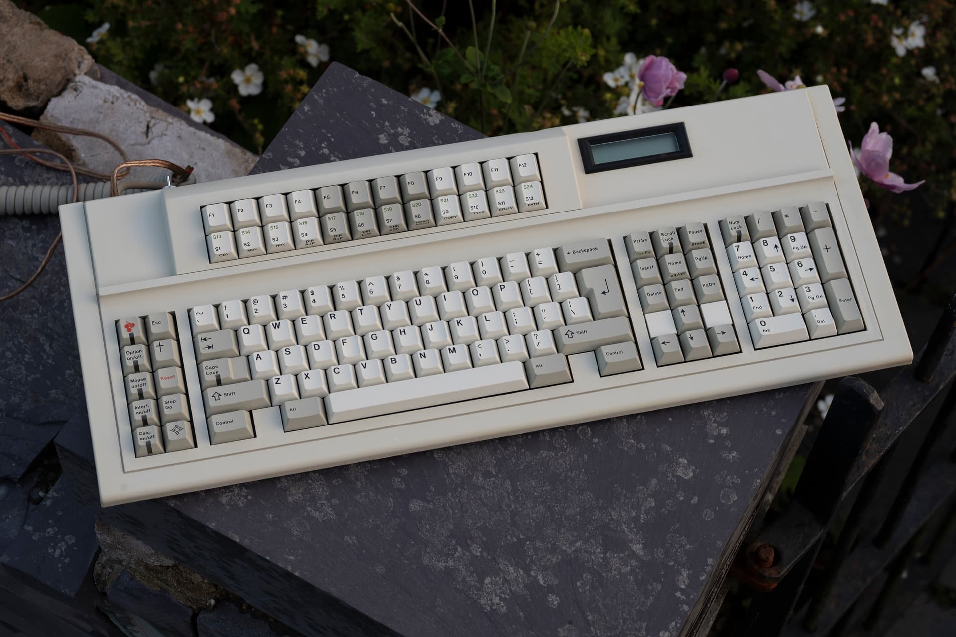

Posting this here for anyone who happens to come across a G80-2000 like these in the future - specifically, with an extra molex power connector and switch.
I was fortunate enough to get one of OP’s boards, and I was able to get it working with my PC in the end.
I think a company or individual purchased and modified these, and then sold them on as a new product - I’ve never seen a molex power connector or toggle switch on any other G80-2000, and there are additional “TAS/G80-2000HAU” stickers with barcodes on the bottom, which are not Cherry-style stickers.
The keyboard doesn’t work via DIN in this state. Basically, they replaced the +5V wire in the DIN cable with the molex power cable, so DIN no longer provides the keyboard with power. The toggle switch disconnects this +5V source when pressed. They also added a capacitor (presumably for shielding) in the one I got.
This is a simple fix - desolder the molex cable and toggle switch. Then locate the original +5V DIN wire, which they thoughtfully tucked away instead of cutting it off completely, and solder it onto the pad that the +ve molex wire was soldered to (it will be in the same area as the other wires that lead into the ferrite core and DIN cable). I also removed the capacitor while I was at it.
After doing this, the keyboard works through PS2 with full functionality[x]. That said, I wasn’t able to get it working properly via a Soarers - I had to connect it directly to the PS2 port on my motherboard to get it fully operational. Further to that, I have to specifically plug it in AFTER my PC’s already fully booted up, and I have to ensure that no other keyboard (PS2 or USB) is connected on power on.
[x] I am still having one small problem with it though - the caps/scroll/num lock LEDs don’t function when toggling the lock states, despite the keys working normally. And weirdly, if I press the lock keys more than a few times, the keyboard stops transmitting text to the PC. I have to replug it to fix it. The LEDs themselves aren’t the issue, as they flicker without issue when booting up the PC with the keyboard attached. It’s very strange.
