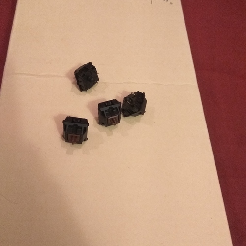

I received my sample of 10 Cherry MX Brown Hyperglides:
So far, they are easily recognizable as Browns.
They’re a tiny bit smoother than the retooled Browns in my 2019 Leopold, but not by much. Stability doesn’t seem wildly different either, they’re not as stable as Bobas, for example.
Although these have garnered some praise in some quarters, I’m not sure they’re such a big deal. It doesn’t motivate me to buy a keyboard full of these.
OTOH, if this treatment were given to Clears, it might smooth them out a bit, and increase their tactility. Hyperglide Clears would be a nice addition.
Update: I tried them with GMK Oblivion V2 keycaps, and it was marginally better.
The heavier GMK keycaps reduce the scratchiness of the switches somewhat, which removes most of it.
The Hyperglide switches are definitely smoother out-of-box than the pre-tooled Browns on my circa-2016 Majestouch.
I would say that they are probably comparable to the freshly-retooled Browns in 2017. But they are still Browns. If you’re not happy with your existing Browns, you probably won’t find these much of an improvement.

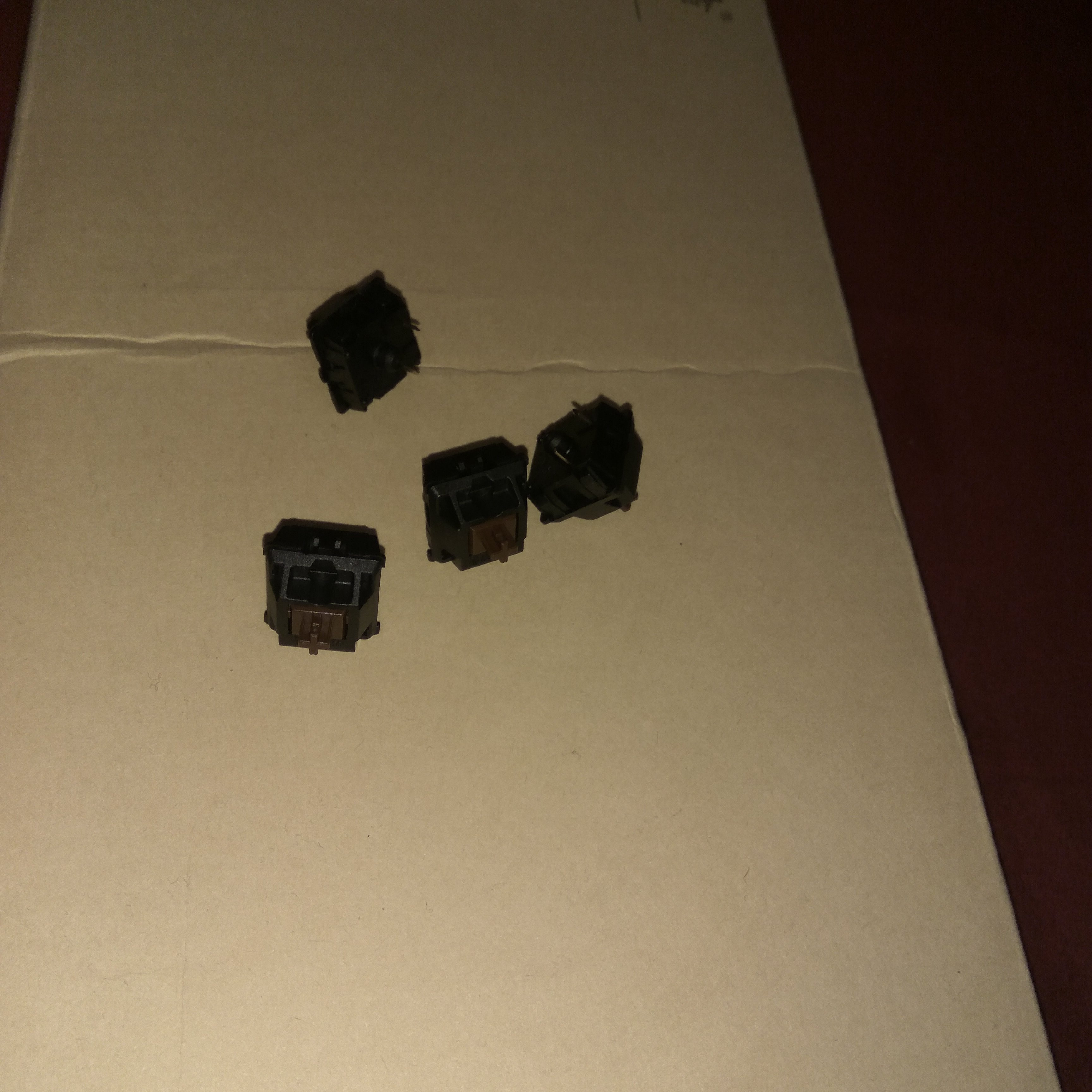

What’s the difference between retooled and hyperglide in those pictures? All I can see is small differences in texture.
From what Cherry has said, the differences are supposed to be on the front side of the stem (opposite of TLS side) and on the inside of the top housing (eight guide rails).
It’s a good question. My ‘hyperglide’ Browns don’t look much different than the regular retooled ones.
Maybe I should open one up and compare it visually to a regular retooled.
Perhaps they just reduced the distance between the stem and guide rails. Does Hyperglide have less wobble than retooled?
I need to do more comparison of these supposed ‘Hyperglide’ MX Browns I bought from the U.K. directly alongside pre-Hyperglide Browns.
One thing I can tell you, from some testing in hotswap vs. pre-Hyperglide, is that these Browns are actually quite nice, by Cherry standards. I plugged in the new keyboard and was ready to criticize these, but they were very gentle and relatively smooth. The pre-Hyperglide Browns desoldered from my Leopold are scratchier and … worse.
