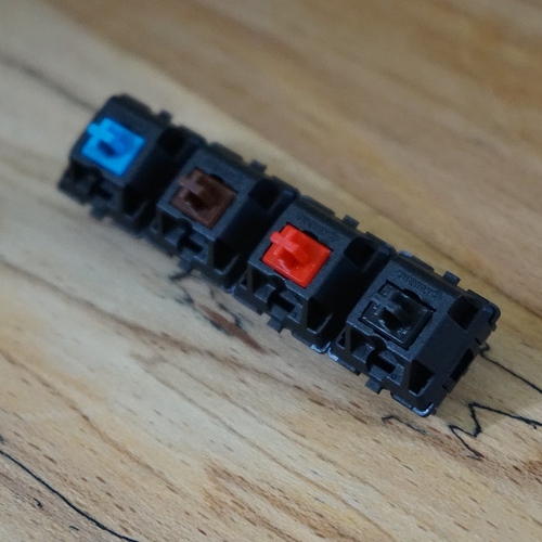

Saw that earlier this year cherry released an update to their MX switches called “hyperglide” and upped their rating to 100 million actuations. The press release indicates the new switches have extra guide rails for wobble-free operation and durability. (This was the same time they released their Viola switches)
seems like increased contact surfaces or “glide rails” would equate to more friction and more scratchiness. But I’d be interested to see them reviewed at some point.
I’m all about Linears, so if these are a positive development, I’ll more than likey keep some of these on the side. But I’d sooner explore a different make, then to return back to a switch make that I know well.
I agree Cherry is not super relevant in the enthusiast community. But they did create the base design that was cloned out. Its possible they could make a come back. I heard that they were recently sold as well.
I think ‘hyperglide’ version is not a special version but just an upgrade to the mold of 4 Cherry switches, meaning all new Cherry MX Red, Brown, Black, and Speed Silver switches will be like this. That said, I don’t think NovelKeys carry the new version yet.
Bizarre thing is that there are now typing test videos of the new version but no teardown images nor videos. Weren’t they even curious enough to desolder and open up those switches? Weird.
This 100%, I’m in the same boat as you thinking more contact points will lead to more friction & a overall scratchy feel. If I had to take a guess I’d say Cherry is probably adding some factory lube to all of them sans blues.
Stumbled across this on r/mk. It’s a comparison between vintage, retooled, and the new hyperglides. Visually, huge improvements on those side rails for sure. Sound test included.
Thanks for the link to photos and sound test. Glad they haven’t thrown out the best feature of Cherry blacks: sound. It’s hard to tell what changed but my guess is the change is mostly in the housing instead of the stem. It appears they reduced the gap between stem rail top surface and housing.
Based on my polishing experiments, top stem rail top surface was not always in contact with housing, at least not as much as stem rail sides and edges. Top part of stem leg sides also seem to be more in contact with housing now. Assuming this is what they meant by increasing the surface area, I think the benefit is not in the sound but in the feel of the switch, making it feel tighter and more solid.
I am going to get a batch to polish. Maybe they don’t need polishing at all which is best for everyone.
