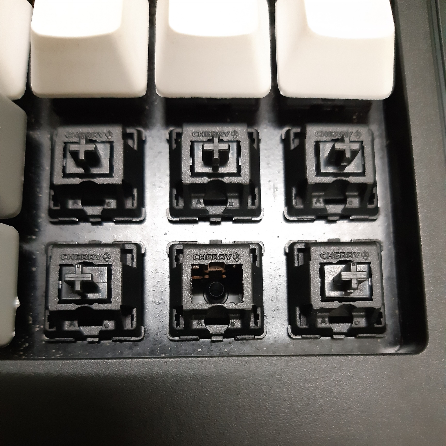

In recent Cherry MX switch, the stem is smaller than it was previously.
Indeed, previously
and recently
Therefore, when the keycap is removed e.g. for cleaning, it may accidentally pull out the stem underneath.

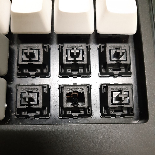

Indeed, previously
and recently
Wow. And there are reports elsewhere that the MX Clear housings have been retooled such that they are less tactile, and become very inconsistent with lubing.
I think that’s just the way retooled stems look. They now have a filet at the top of the switch. That’s not dead space really. Just a slope where it used to be straight.
Oh yeah, I read that in a hurry. Yes, the retooled Browns I’ve seen have that filet, and it’s fine. No problem with keycaps. It’s a nice change that helps identify the retooled switches.
And the situation with the Clear housings may be a false alarm. Clears have been getting worse, but very slowly and gracefully, so there’s no immediate action to be taken.

That is actually from overly tight keycaps, not the switch itself. That can actually happen with any switch if the cap is tight enough IME. To keep it from happening either use different caps or lube the cruciform mount on the switches.
It’s true that the keycap is overly tight. But that’s not its fault, so long as it fits the stem.
The stem and the switch housing both stay unbroken after the stem was accidentally pulled out. So no, this is a design error in the switch.
By the way, this never happens to me with older MX switches.
Actually MX clears are notorious for doing this. If you search the issue up on GH or r/mk you can find posts from years ago of people having the same issue. I’m not arguing that the retooled design does not contribute to it. MX blacks never had this issue before AFAIK, so the changes obviously have had an effect. I’m just saying people pulling the stems out of a switch because of an overly tight keycap is a well known & fairly common issue.
I dunno, just because you can jam the keycap on there doesn’t mean it fits, would you rather it rip the top housing off the switch? I’ve had that happen as well with keycaps that we’re too tight.
Have you tried these specific caps on other switches.
I don’t think the keycap needs perfect fit. The stem is supposed to be kept inside by its shape and size, not by friction. So it’s design error if it can be pull out unbroken. Similarly, in your case, if the upper housing was pulled out unbroken it’s another design error.

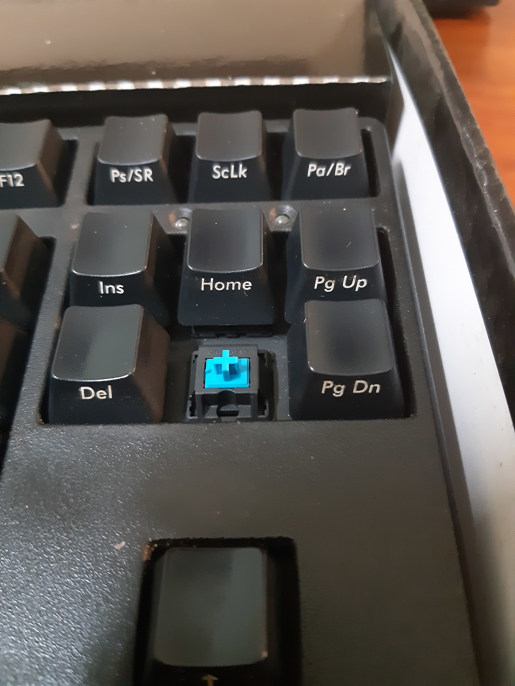

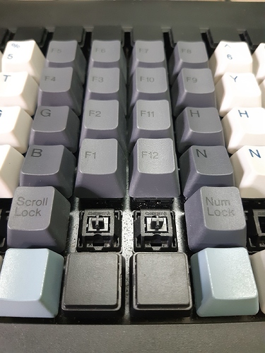

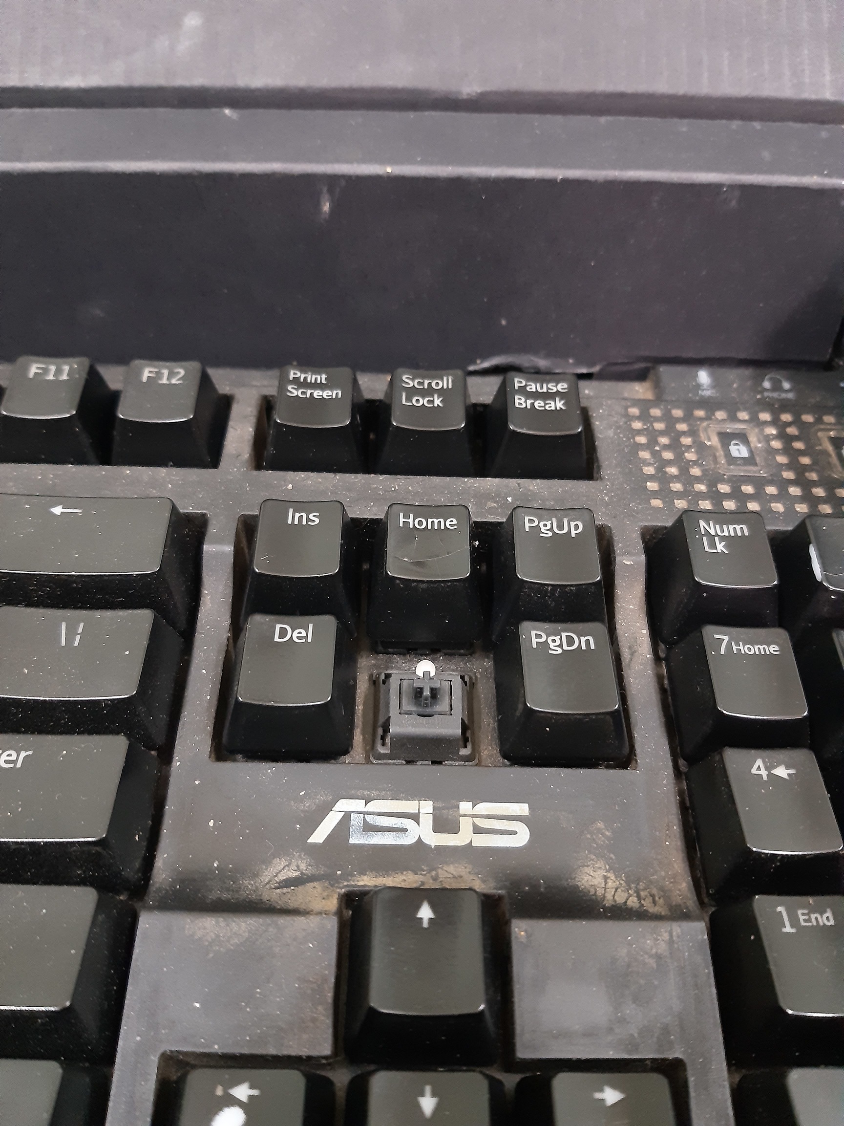

I haven’t tried the overtight keycaps anywhere. I have no other keyboard with similar switches. But I’ve tried two (stock) keycap sets from older Cherry MX boards to the new board. The stock sets fit their original boards perfectly, but on the new board, they’re… loose.
One older keyboard was shown in my initial post. Here is the second one.
