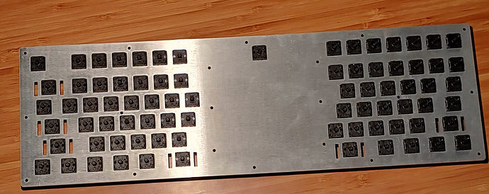

If you were going to have a switch plate cut intending to use Costar stabs, would you create it for Costar only or would you do a Cherry/Costar combo? I’m using Plate & Case Builder.
Costar only

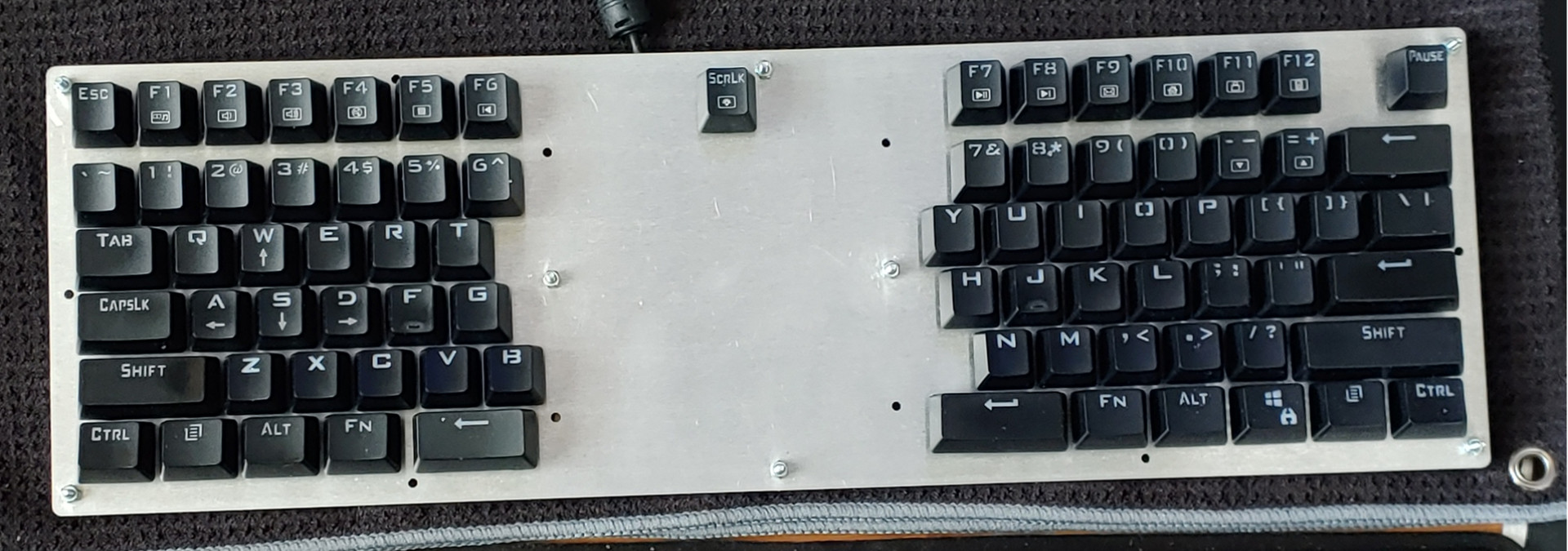

Here’s the somewhat end result. Still want decent keycaps, and I’m not sure how I’m going to finish the case (complete sandwich or standoffs with bottom acrylic plate). Right now I’m working on the QMK configuration and making sure that a split board is for me as a daily keyboard.
.@Lesbian or @pixelpusher do you have any strategies for stubborn Costar stabs? 2 of the 6 stabs work great…one lubed, one not. 4 of the stabs will not work consistently even with lube. They work properly a couple presses, get stuck and pop up, get stuck down and stay there and everything in between.
I’ve made sure the insert is always in the correct direction…the holes appear to be the same size as the 2 that work, the keycaps in play are the same thickness and the those that work, and the caps are all thin plastic. Definitely not thick caps.
Is it possible that the quality (no obvious physical issues) of the stabs could be part of the problem?

Two things:
One, it could be the keycaps. Are they warped any?
Two, try mixing and matching inserts - see if that changes anything.
