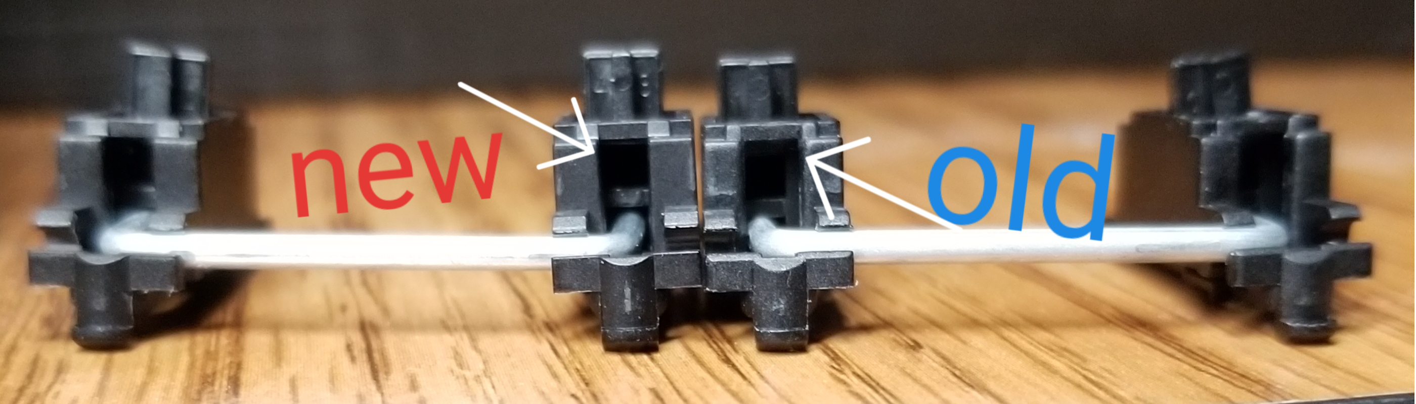

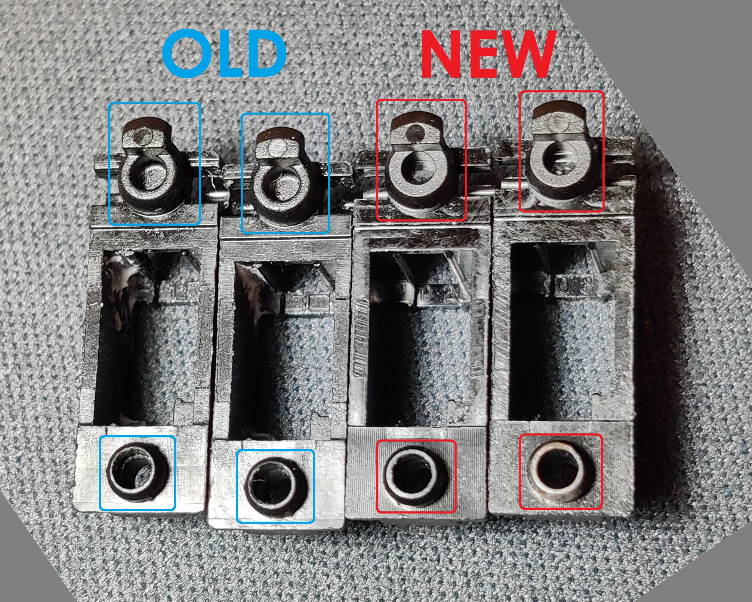

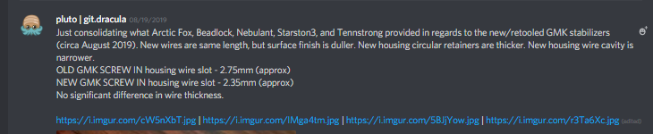

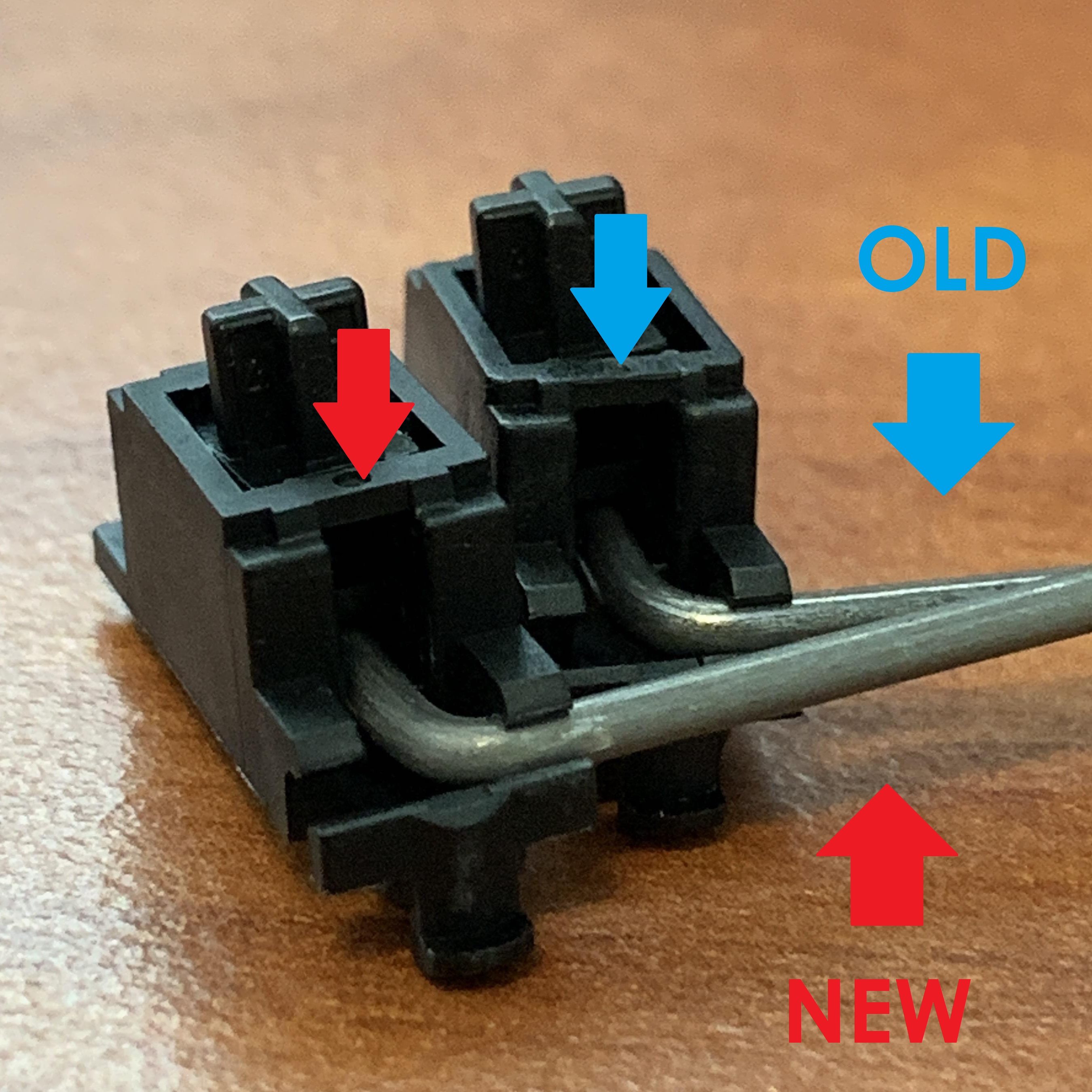

Has indeed been a tooling change for GMK’s screw-in stabs. From the TopClack discord:
IIRC it’s also mentioned somewhere that the 7u wires are slightly different length/size now and that’s causing some issues as well.
Thanks for the heads up @donutcat! On paper they all look like changes for the best, but I wonder if the tighter tolerances are causing them to feel scratchier than old design? I also wonder if the changes cut down on rattle?
