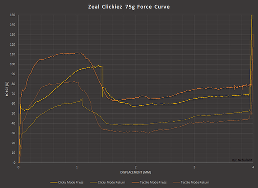

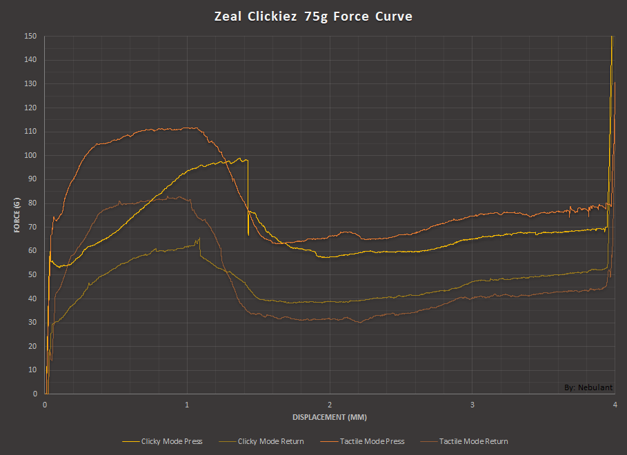

Anyway the new force graph looks awesome, that spring is very linear, super explosive and the tactile mode looks even heavier.

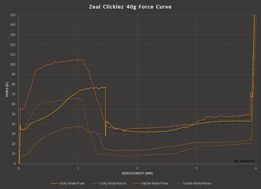

Though one thing is odd to me, Matias click force graph shows a similar peak force to the 40g Clickiez yet the switch feels weaker in my hand, and compared against even a BOX whites, the Matias switch depress first even though it’s supposed to be much heavier.

I have my reservations about the tactility force needed for these switches, and I’m coming from Box Jade’s. Those tactility graphs make it look really quite different from any of the other MX switches on the market… And I know that I haven’t had good experiences with 65g tactiles before.

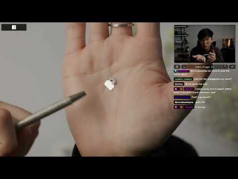

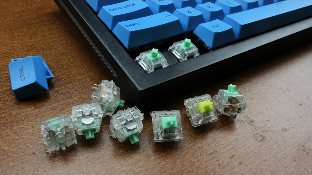

The cool thing about these is that they don’t even use a jacket; the same metal leaf acts as either a click-leaf or a tactile one depending on which position it’s placed in the housing.

Leaf also seems to sit loosly and it’s very easy to damage it when moding the switches.

I watched the Apiary twitch stream yesterday. I’m not sure when/if she’s planning to do a full switch review, but she said she was surprised by how much she hated Clickiez. I guess these will be the new Box Navy in terms of polarizing opinions.
