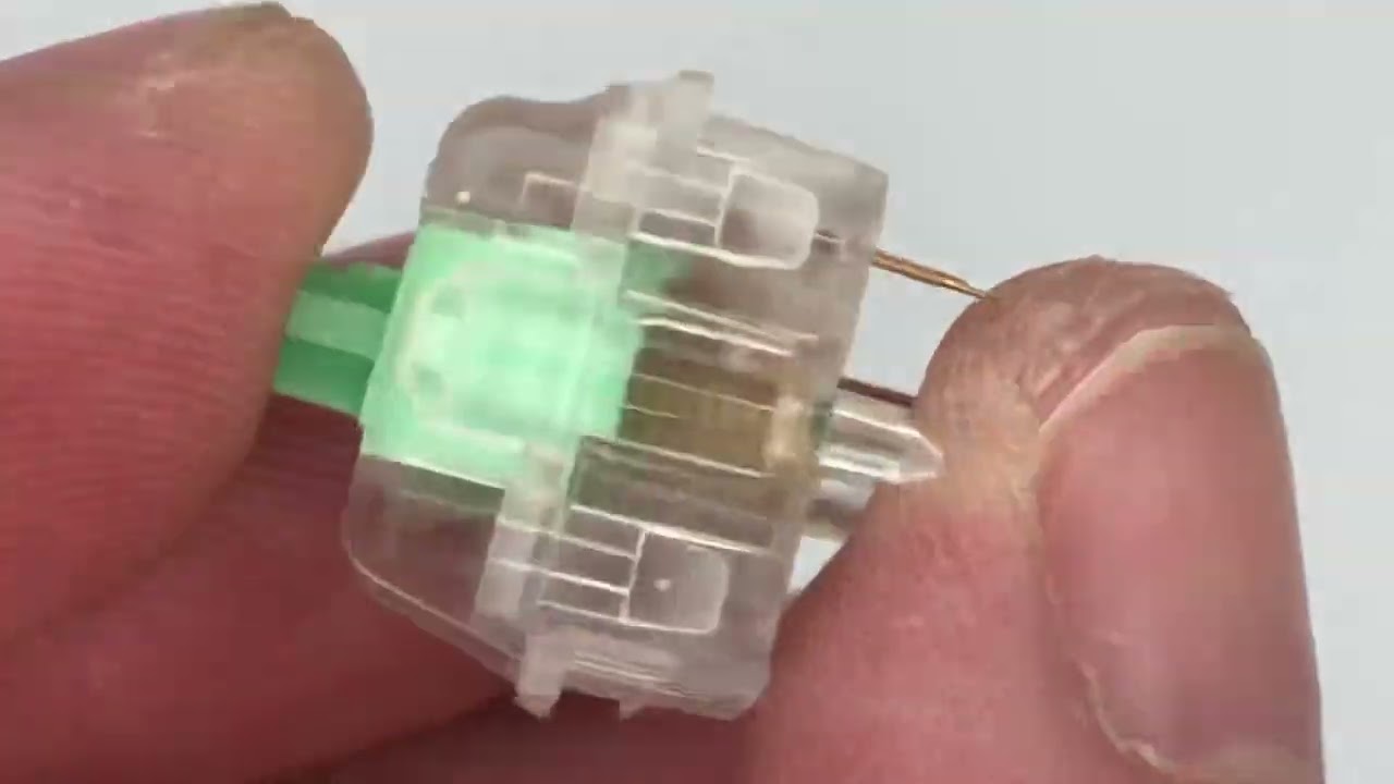

A quick close-up video to show the click-leaf in action:
Don’t mind my yardwork hands and ZZ Top in the background…

These have become my favorite switch (in stock 40g click form).
Has anyone experimented with lube and other mods aside from the tactile conversion?
What did you do and how did it change the switch feel and sound?
So far the only other mod I’ve tried is putting a little pad between the leaf and the housing in “click” mode; this gives a sort of in-between configuration with about tactile strength of the click without as sharp a sound. I saw someone inline use an o-ring; pretty much any small soft bit of something you can stick in there should work.
