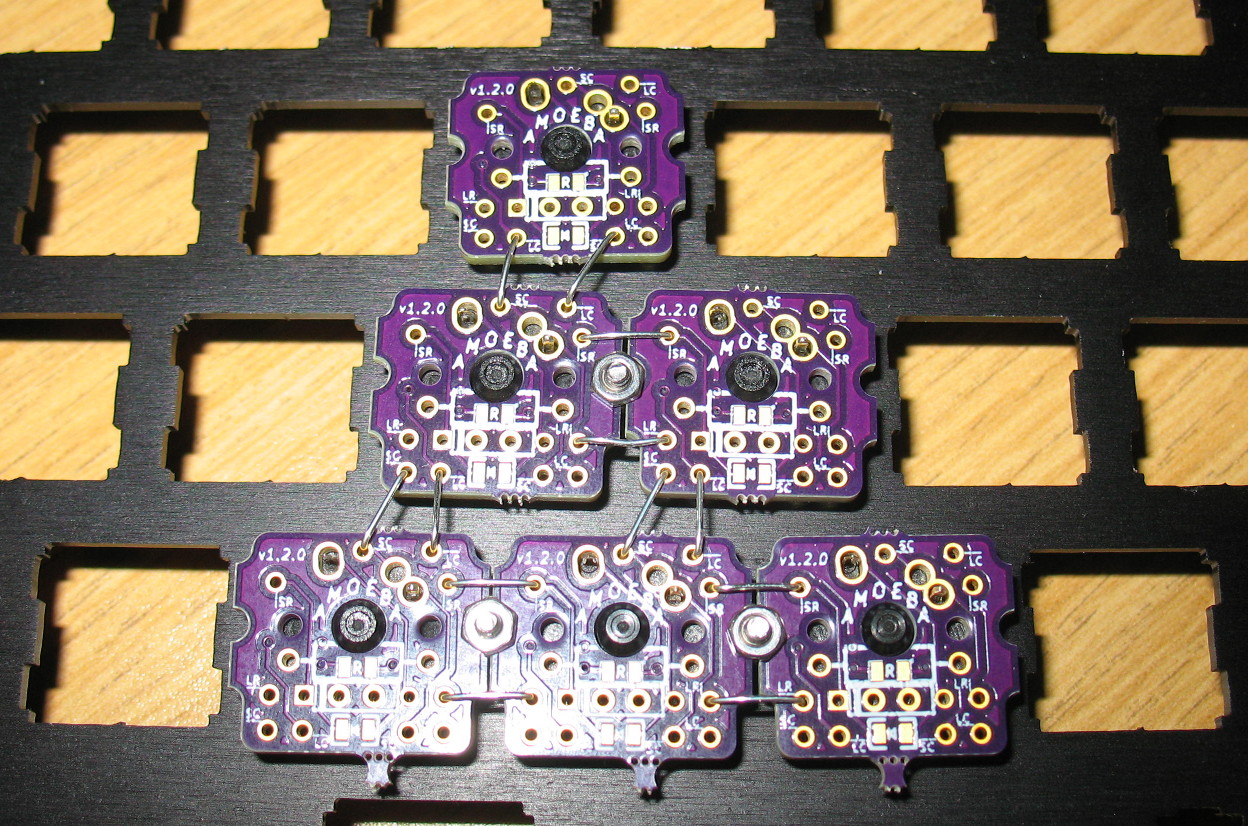

I see now, this image from the Amoeba thread made it much clearer
This also makes in-switch leds actually possible for (pseudo-)handwired boards.
Having handwired a board before, even if it is with a plate that’s good. I have to say that the amoeba is a great little tool for doing it yourself. It definitely makes it a lot easier and troubleshooting is a lot easier as well. it takes the guesswork out of diodes and wiring while not having a ton of wires snaking around and potentially getting disconnected easily.
