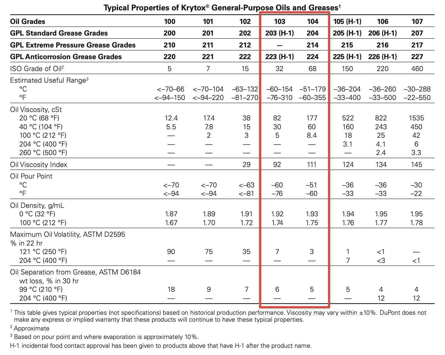

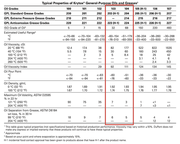

Comparison: Tribosys 3204 vs 3203

Here’s the difference in detail - same properties at NLGI 0.
