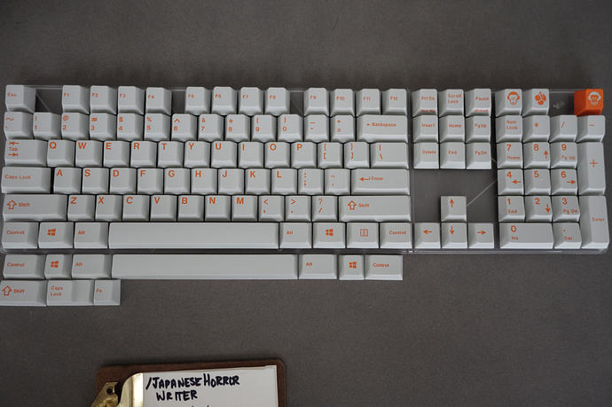

I leave you with a picture of DCS Sleeper (with two, very old SP novelties, not the standard accents) and a picture of an old GMK set that has the same weird num row legends:

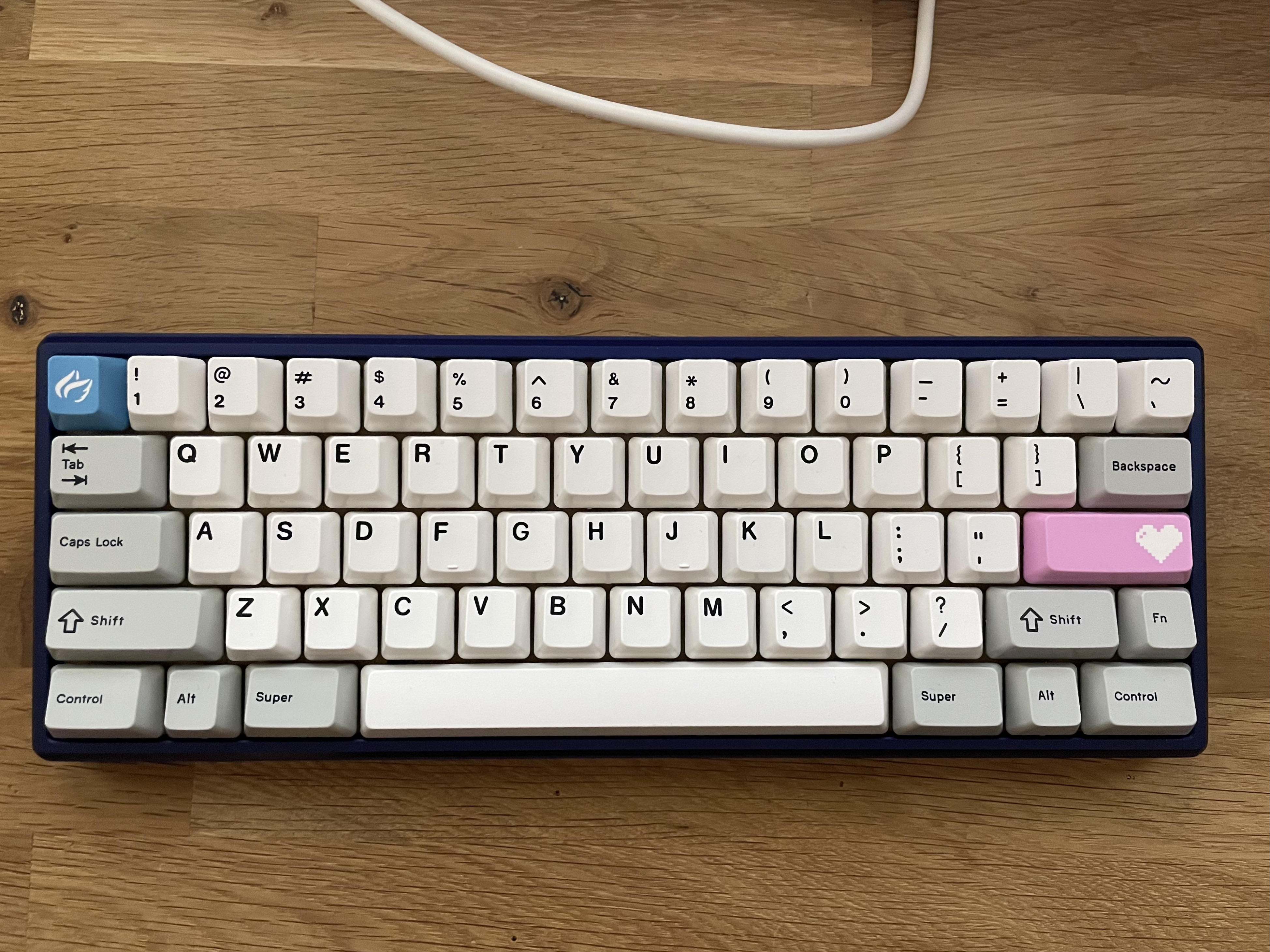

I’m typing on this right now, mixed with a GMK set. The accents are very nice.
And they line-up well with and almost colour-match an ePBT spacebar.

I was wondering if the mods were a gray like GMK Muted or a beige like Cherry OG doubleshots or CRP mods (or somewhere in between)? Every picture seems to vary with the lighting used so it’s hard to nail down from those alone.
They are most definitely gray in person.
