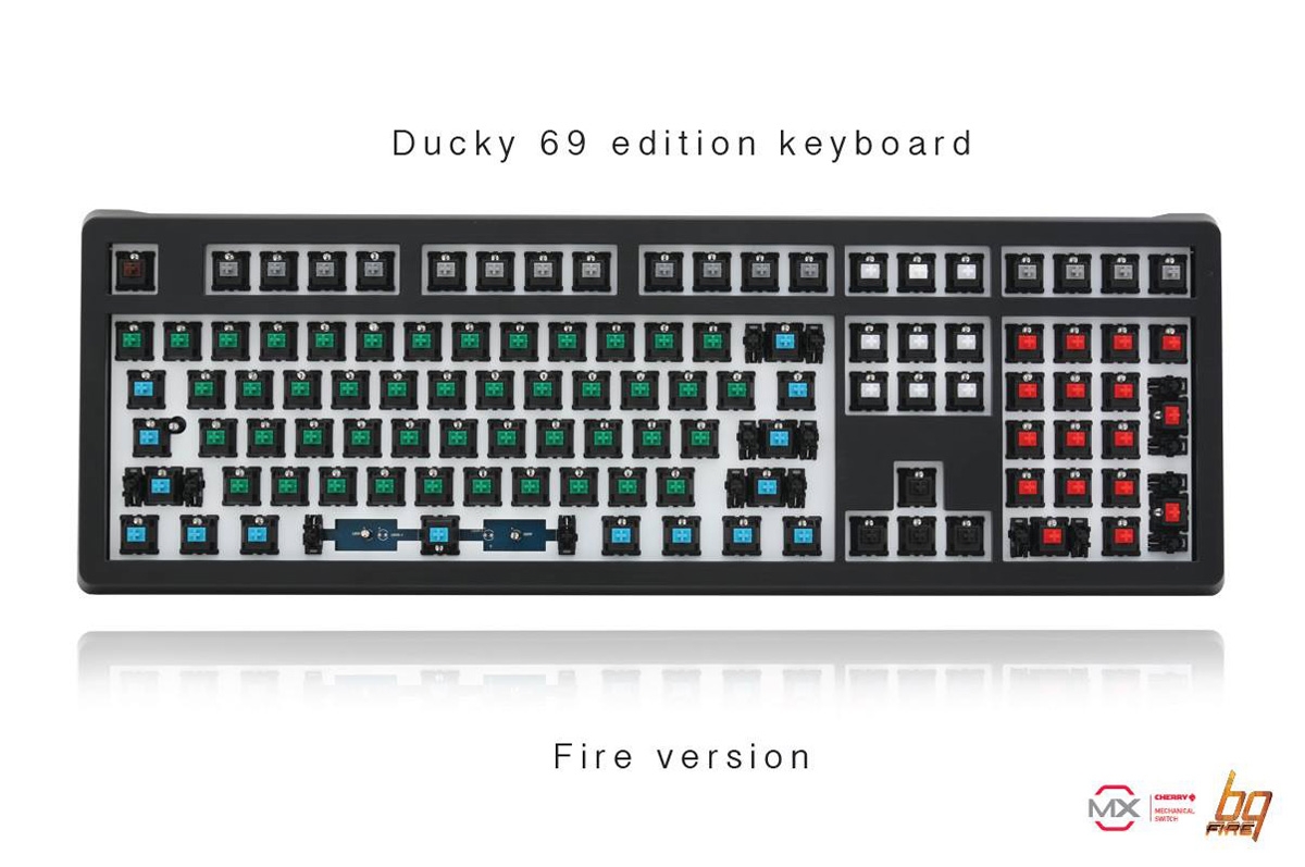

I remember Ducky tried this a few times…
Ducky Shine 4 69
Thanks, I hate it.
