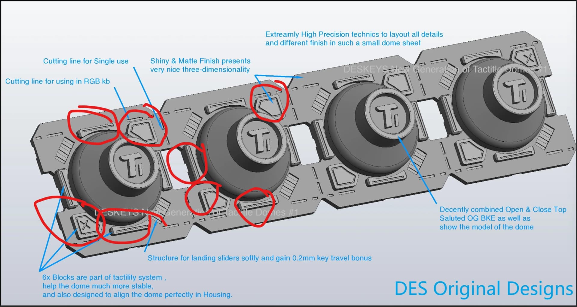

Hello! How did you even use the T1 domes with dynacaps? From what I’ve seen on the discord everyone says they’re incompatible due to the indents around the dome and they don’t fit in the housing properly. Maybe that’s what was causing all the issues you experienced with the wobble. From what I’ve seen on reddit on discord everyone has been saying they have much less wobble, especially on the 2u housings, than deskeys. OG Sony BKE domes also have the same issue as the t1s(they come in strips and singles, the singles also have indents around the dome) so be careful if you want to try those too or any other dome that has indents for that matter. Leaving a pic as a reference. Basically you need to make sure the area around the dome is flat.

Out of all the above astrodomes will release first I think so that’s your best bet. Sorry for not posting links. My account here is new and it won’t allow me to post links, but you can find ICs for astrodomes and metapulse on geekhack. You can also join the discords I mentioned if you want more info.

Like primus said, I believe all of your issues stem from using T1 domes. All those random shapes and lifted areas interfere with the housing of DynaCap and do not allow them to seat correctly. DynaCap housings are by nature smaller than others, so because of this the walls of the housings end up right on top of those random shapes on the floor of the T1 domes.
If you use any domes with standard flat dome floors, you will not have these issues. DynaCap is made to have much tighter tolerances than any other option on the market.
