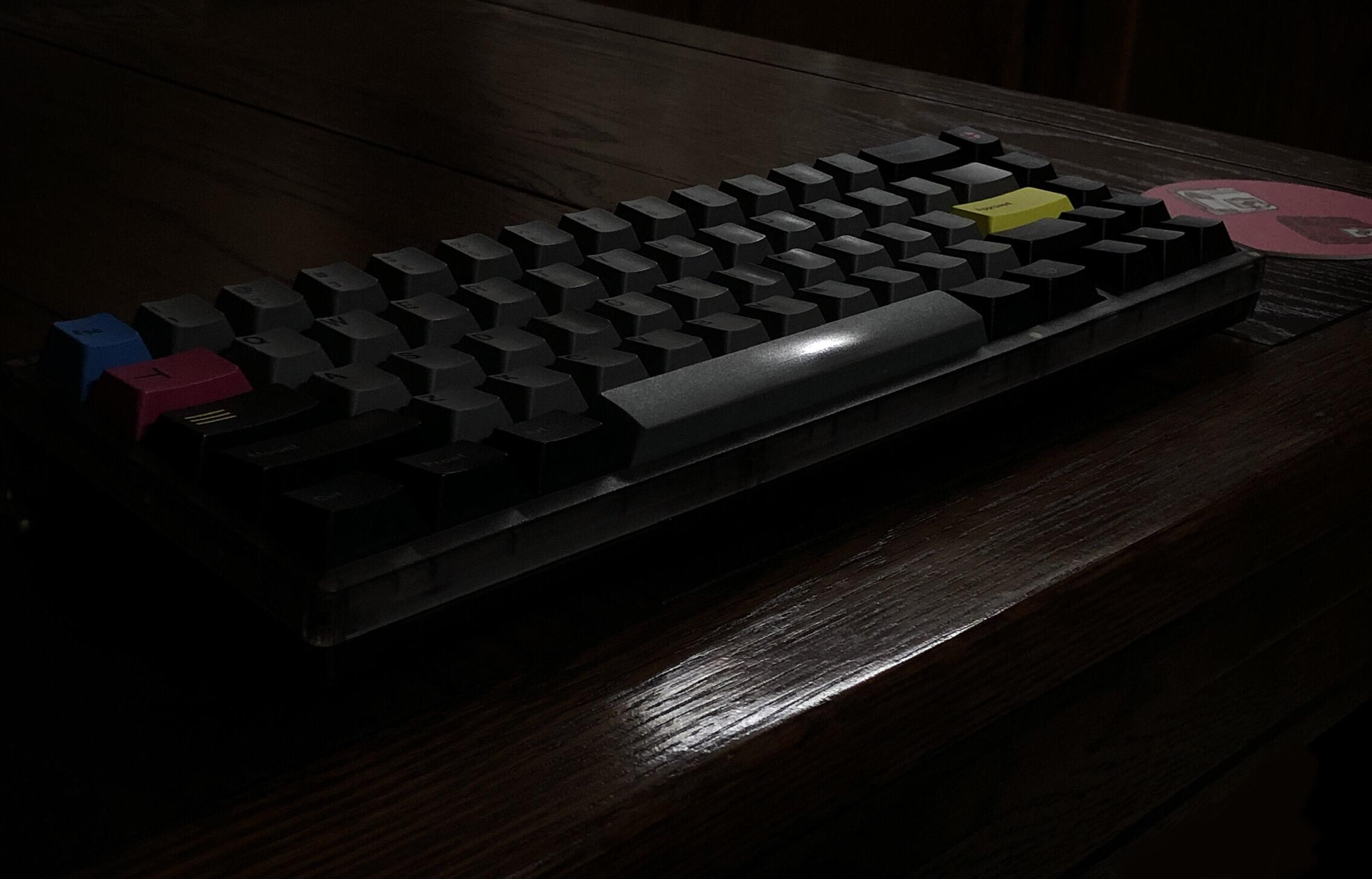

ABS keycaps will most likely start to become shiny, specially with cheap Sets that use cheaper materials and blends. That’s just how the material behaves, sadly.
PBT is way more resistant to it and it will take a lot longer as it’s more durable, but it’s not really possible to get colors as deep and dark as you would get with ABS. Doesn’t matter if Dye-Sub or Double-Shot, it’s just a characteristic of the Material itself.
Personally i would go for PBT over ABS because i just hate shiny keycaps and how they feel, but people swear by the sound and feel of ABS. ABS being usually higher in pitch but more muted than PBT. But it’s all preference, of course.
It also depends on the keycap profile, which affects weight. For example Signature Plastics SA keycaps are heavy, despite being made of ABS (double shot, very crisp, expensive too…) and will affect the feeling and sound a lot. KAT keycaps are made of PBT and have a very refined sound, in good part because they are quite tall and thick too, and the internal shape has been made to optimize sound propagation. MT3 is another interesting example, additionally because you can find them in ABS or PBT and they do affect the sound a lot (in similar ways, but not exactly like SA).
SP SA caps are shiny by default so they wont pick up shine like textured tops (Cherry or DSA for example).
Apparently yes, ABS can shine.
