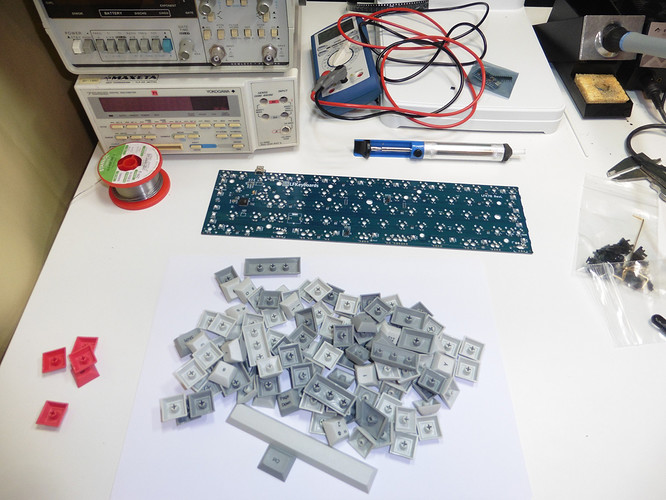

First, the caps, to give you an idea of their original colour.
The picture was taken with cold white light on a white piece of paper, with flash.
(Those are kbdfans DSA caps)

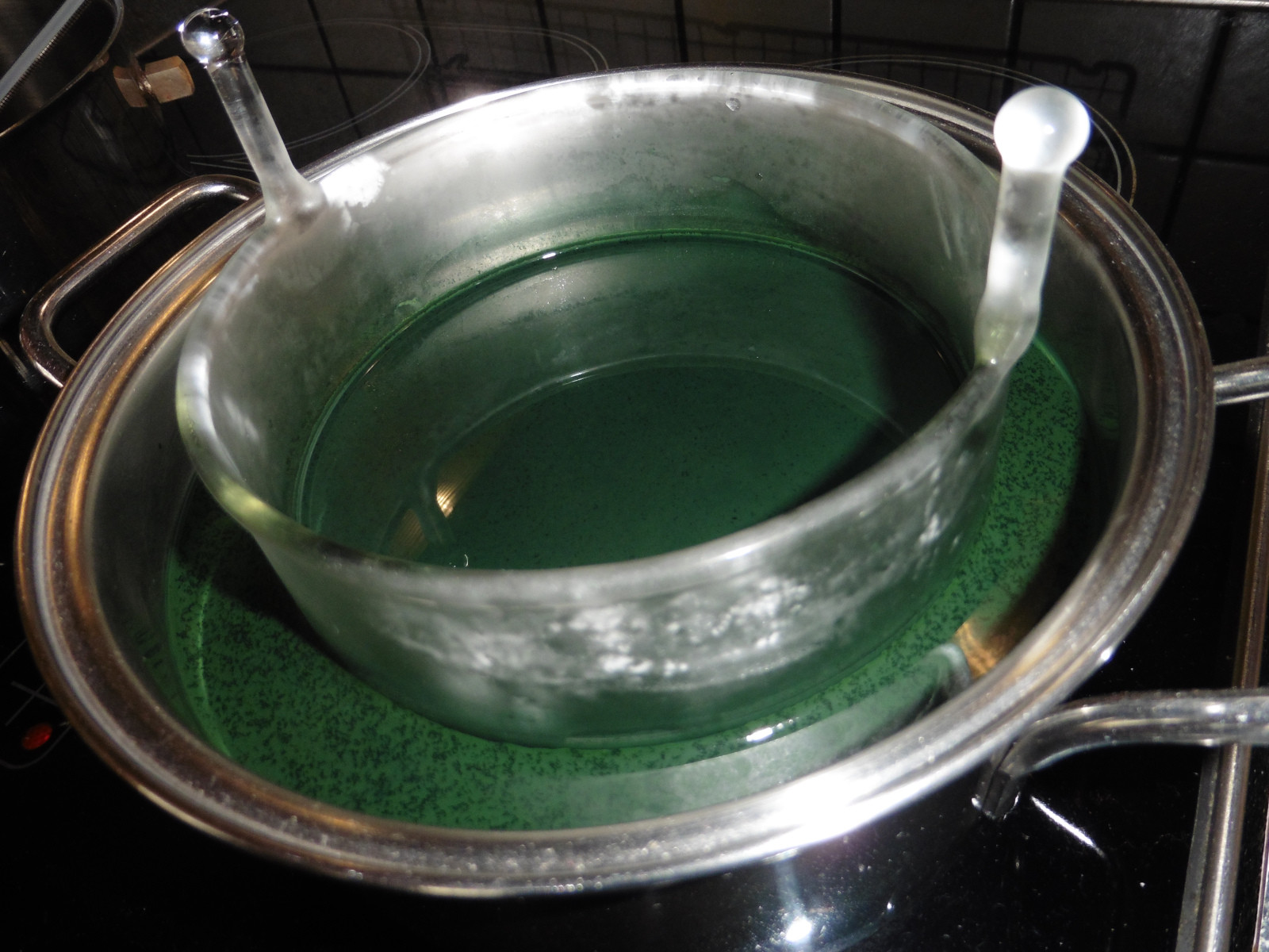

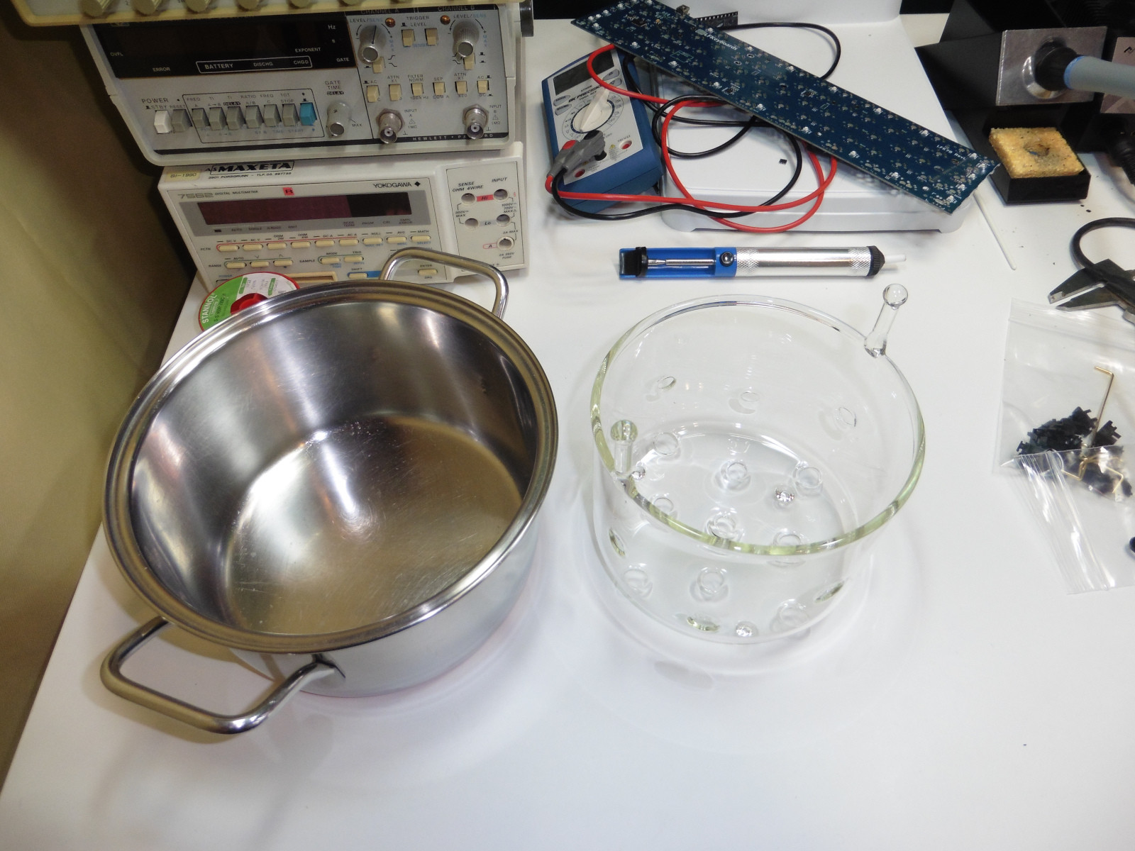

I use an old stainless steel pot for the dyeing solution.
Don’t use aluminium, as you would also dye the pot :wink:
I made myself a special glass “strainer”, just for caps-dyeing.
It’s cylindrical to make better use of the volume, thus needing less liquid.

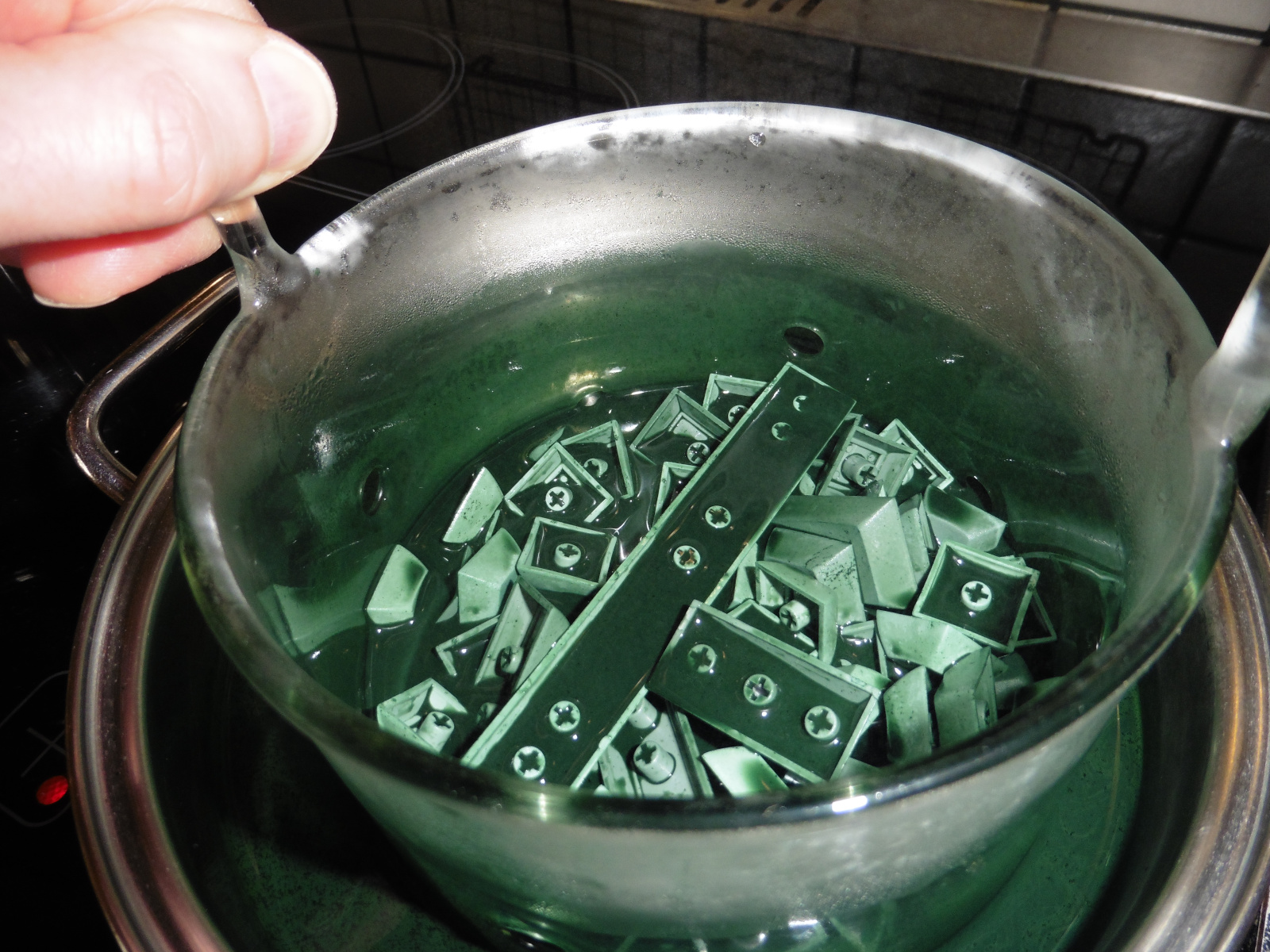

The holes in the glass strainer make it easy to agitate the caps in the solution, just by lifting it out of the pot, and pushing it in again.
By doing so, plumes of dyeing-solution will “stirr” the caps without scratching them.
The glass strainer is also extremely easy to clean.

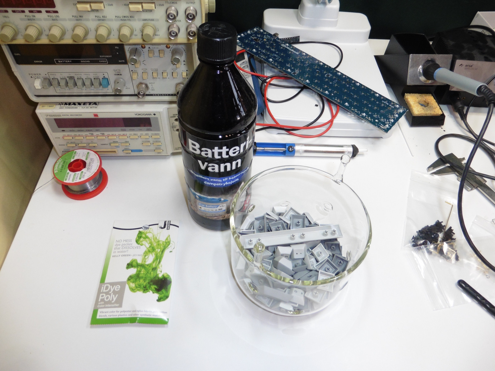

For this run, I use “Kelly Green”, as all the times before iDye Poly.
So far I always used destilled water, just to be sure.
Next time I will use tap water, just to try it.

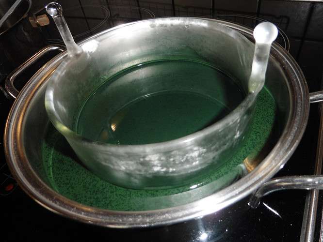

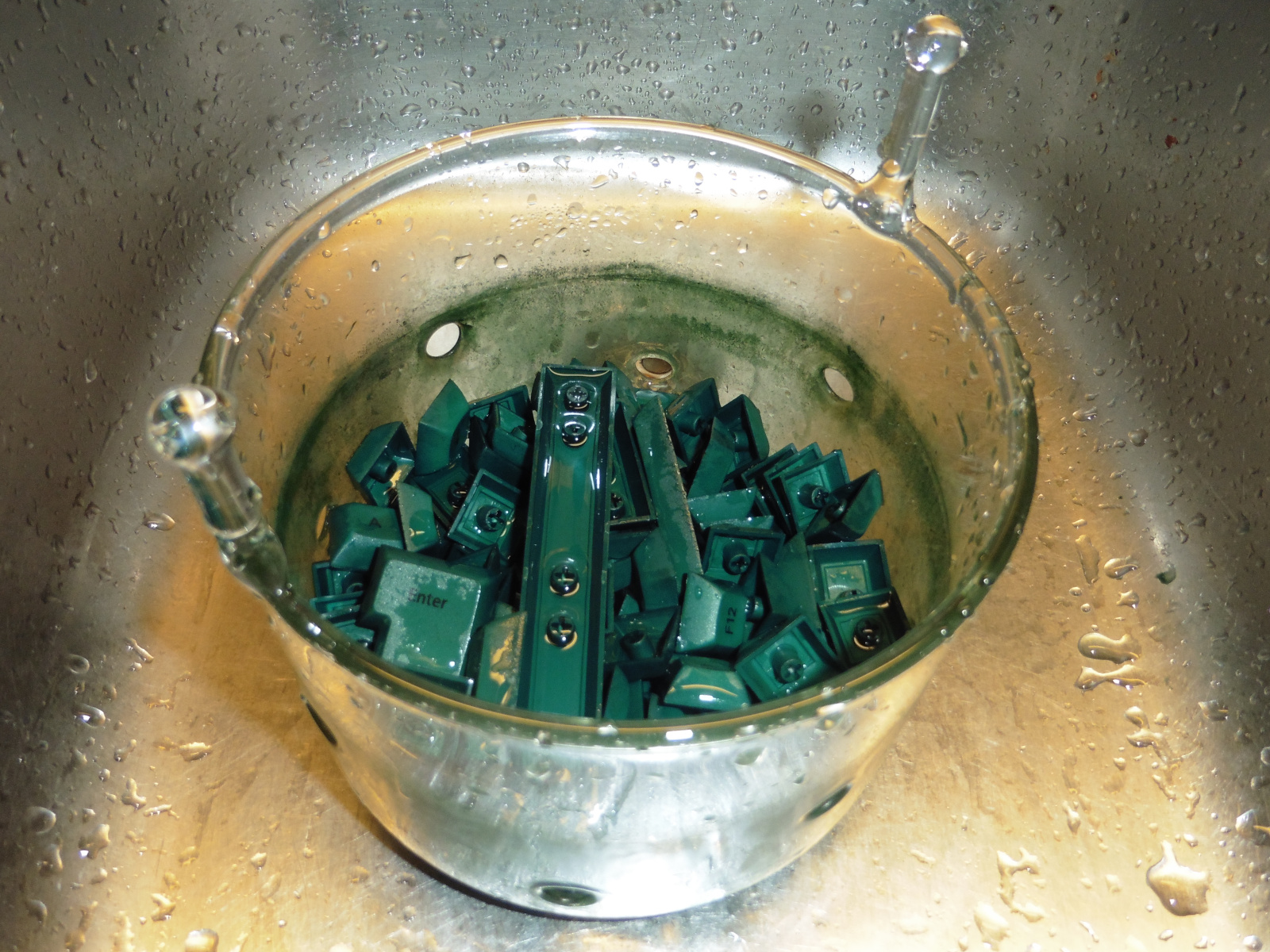

Two close-ups of the “soup”.

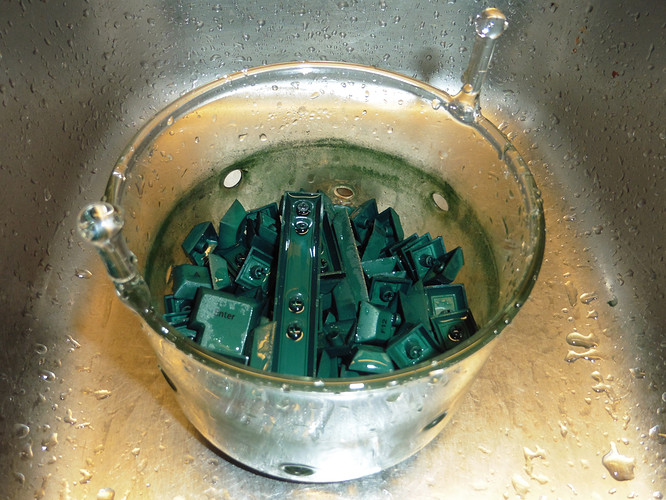

The caps after dyeing, before cleaning.

Actually I hoped the green would be a little lighter, but I am happy anyway.

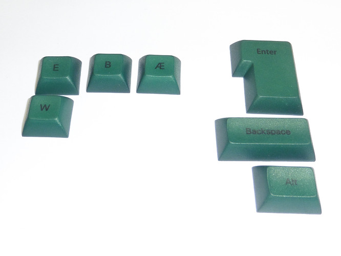

The results after cleaning* (see note below) and drying:
Alphas to the left were light grey, modifiers to the right were darker grey.
It’s impossible to see a difference between them in this picture.
With the naked eye, the previously darker modifiers are a slightly darker green.

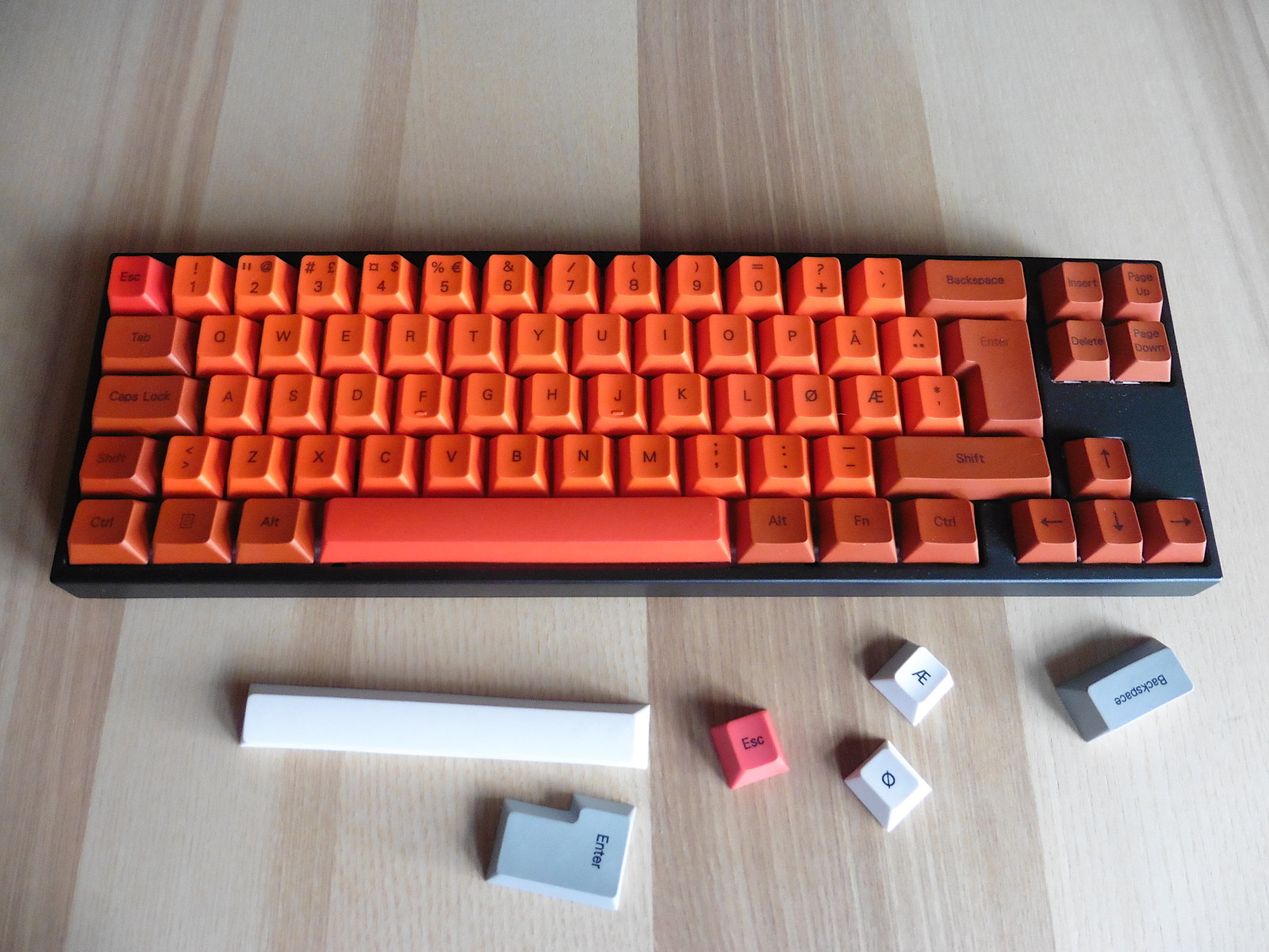

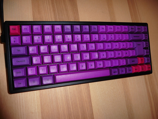

A picture of my results with orange. Some un-dyed caps of the same brand/type for comparison:
Those were kbdfans cherry profile.

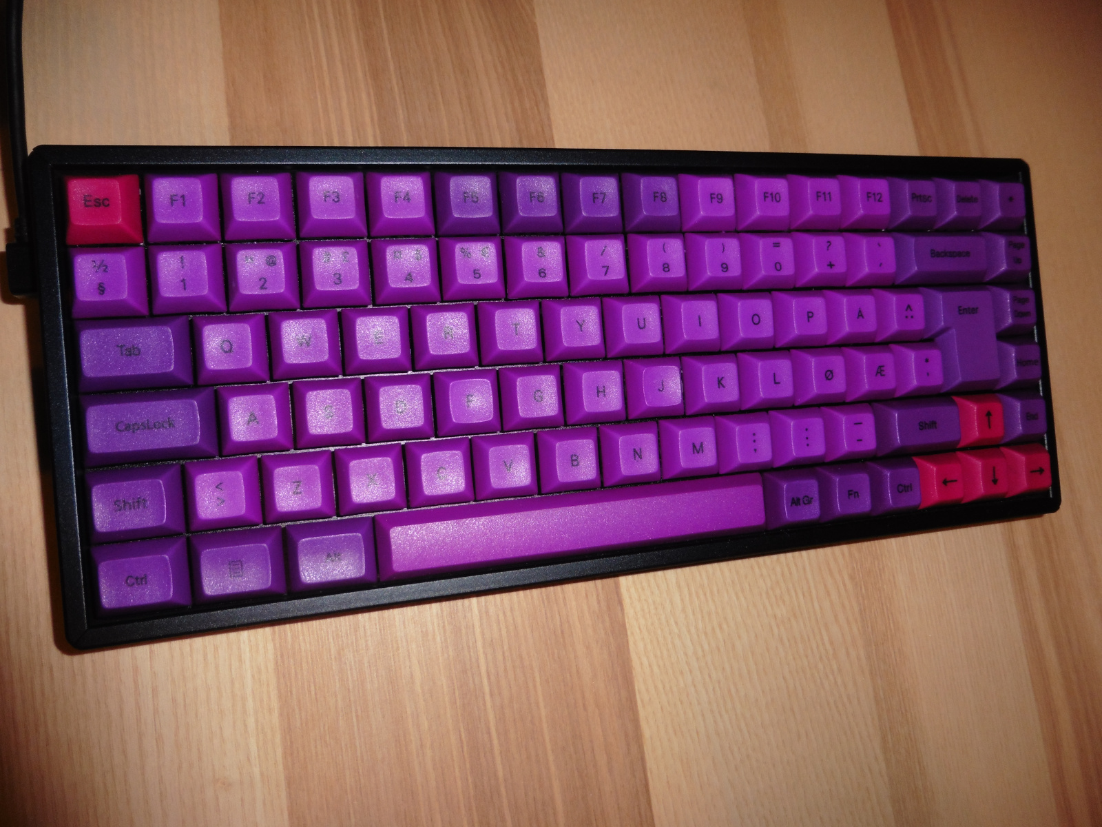

And some purple caps. Those were kbdfans DSA caps, same as the green ones.
So far the orange came out best, in my eyes the purple and the green got a little to dark.
