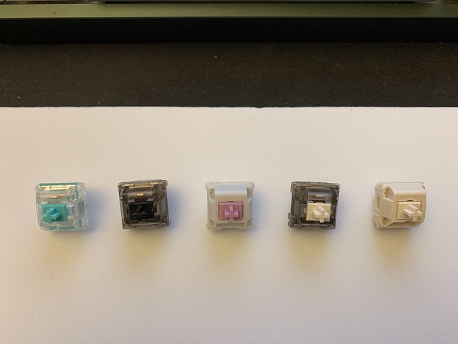

Sound of linear switches for fun. English is kinda limiting so also threw in Hangul versions.
From left to right:
  • Tealios - dhek
  • Ink - dhuk
  • Mauve - ddhuk
  • Creamy Ink - ddak
  • Cream - DDuk
Notes:
  • dd or ㄸ is clacky. Caps means more clack.
  • uk or 윽 is bassy.
  • ak or 악 is brighter tone.
  • I used POM plate + heavy aluminum case without case form
