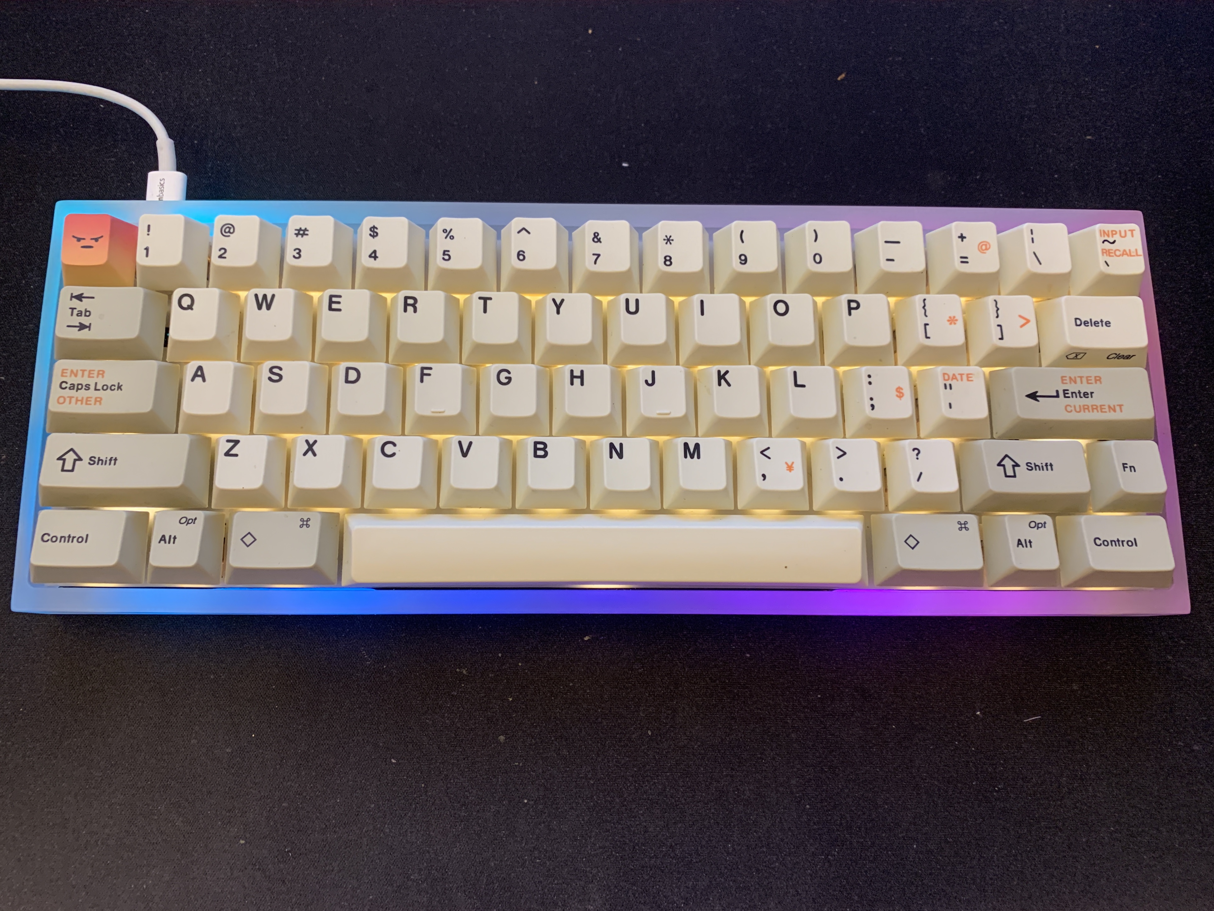

I finally found an Acrylic case combination I can enjoy:
  1. Acrylic Tofu 60% with tire balancing weights.
  2. NovelKeys Creams
  3. POM plate
  4. CRP PBT keyset
I’m amazed I have not tried this combo before but it sound very thocky yet bottom out is not as harsh as aluminum case.
