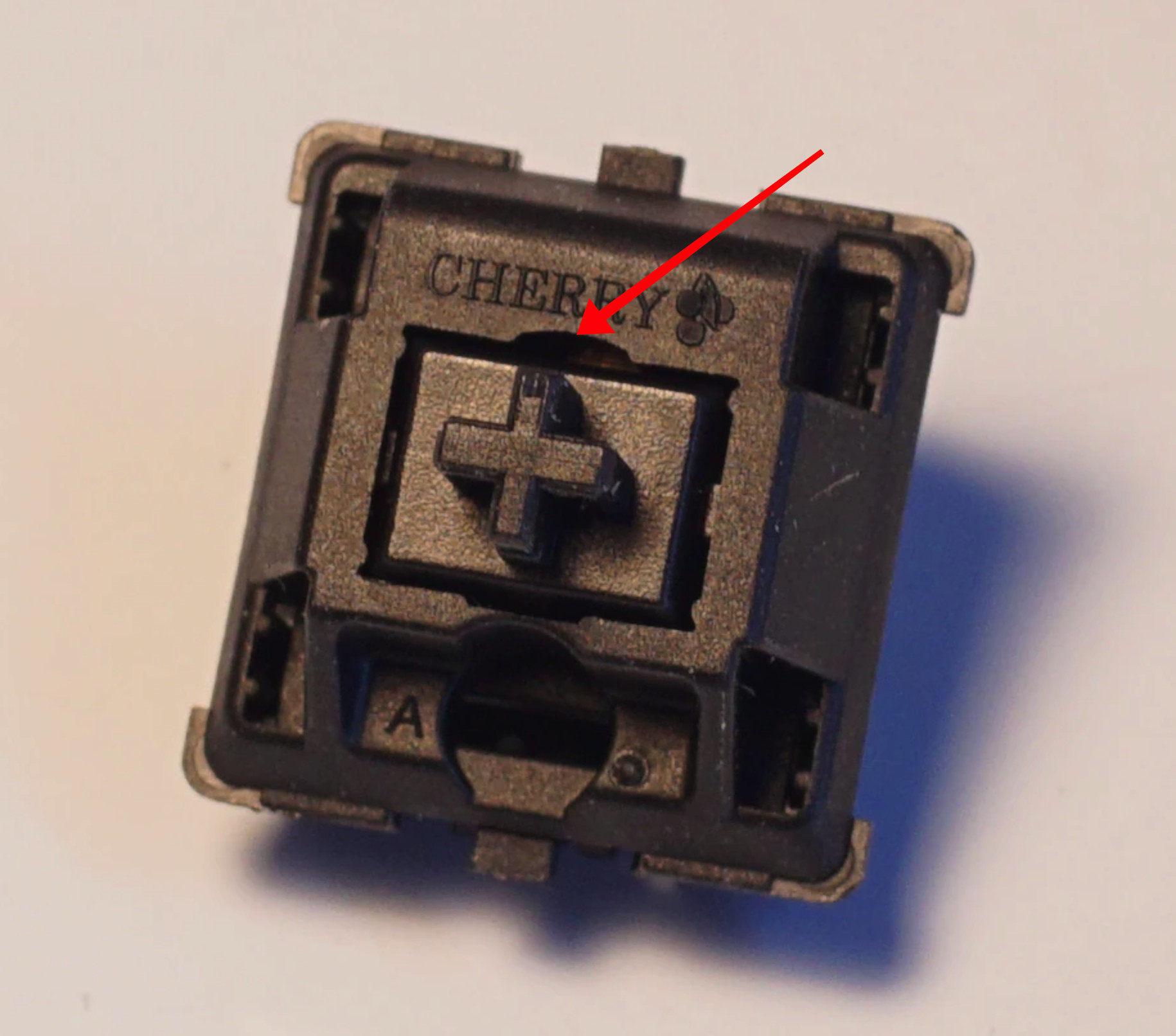

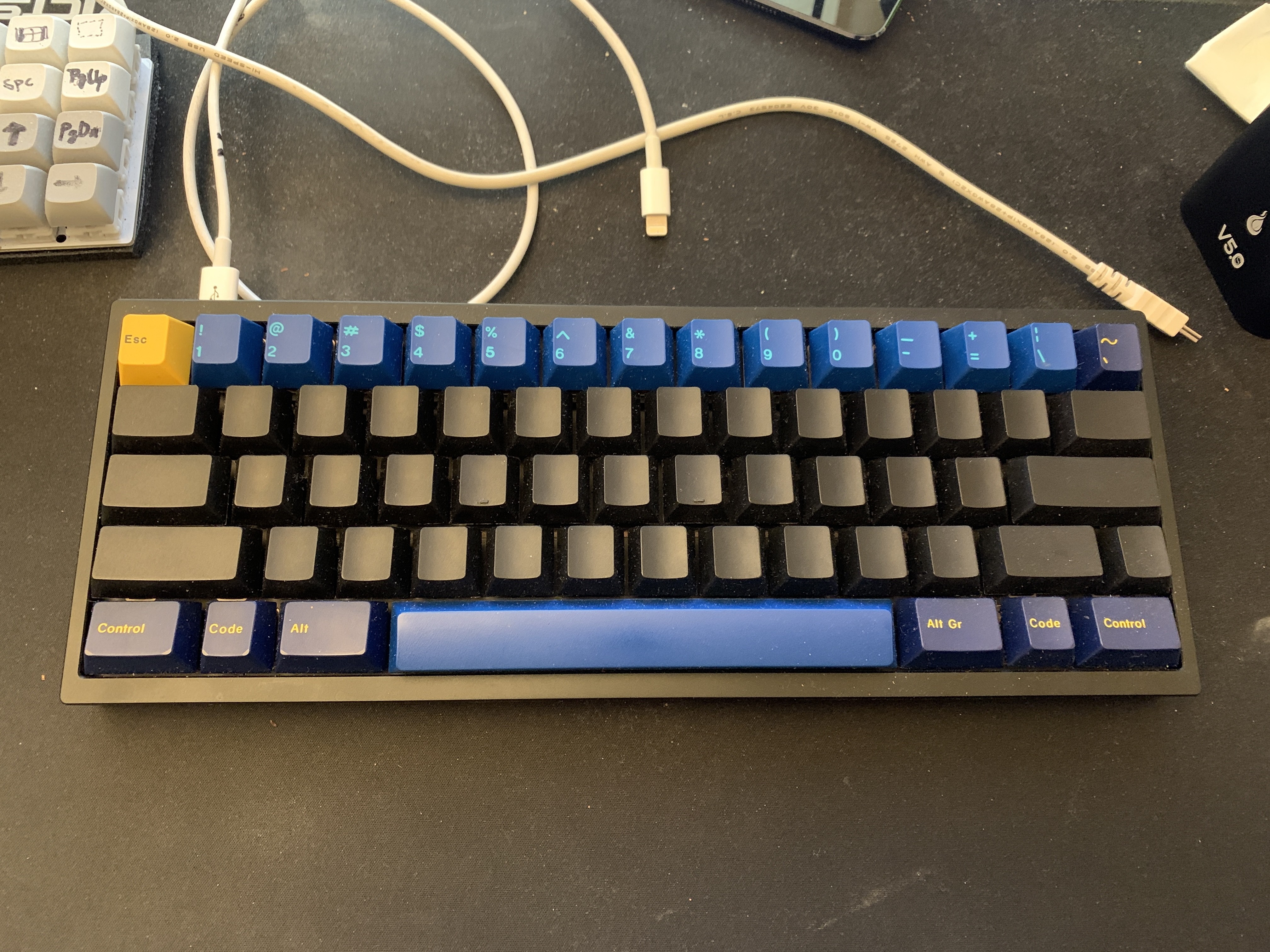

Sharing another oddball issue: I’ve wondered why Cherry MX switches had a curved cut-out on one-side of the top switch housing. I ran into a possible answer today when I tried to use CRP Desko keyset on a Cherry MX black board.
CRP Desko number row keycaps (tallest ones) interferes with North-facing Cherry MX black switches. When key is pressed, northern edge of the keycap stem hits the southern ledge of switch housing. This doesn’t happen when the switch is South-facing because northern edge of Cherry black housings has curved cut-out which is deeper than the flatter cut-out on the other side.
Note that CRP Desko was the only keyset that had this problem among all the keysets I have.
