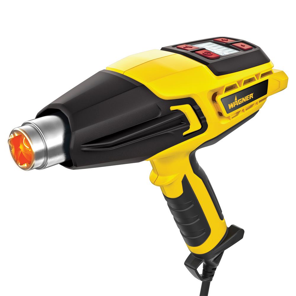

  2. A heat gun

Step 2) While using the speed square to hold down & flatten the warp out of the spacebar start blowing the hot air from the heat gun onto the exposed sides of the spacebar. Be sure to keep just enough pressure holding down to flatten out the warp throughout the heating.
Step 3) Once you have sufficiently heated the spacebar (it doesn’t take much I wouldn’t hit it with the heat gun for more than 30 sec.) shut the heat gun down, but continue to keep downward pressure on the spacebar until it has cooled sufficiently (about 1 1/2 to 2 min should be enough time). This is a very important step as letting the pressure of too early will result in the spacebar re-warping.

I too have a heat gun. Which temperature should I set it to before applying the heat to the PBT? It goes from 50 to 500 Celsius, aprox.
No problem! I used mine at full tilt which is 565C, but like I said I only heated it for about 30 to 40 seconds after letting the gun warm slightly so it was probably running around 350C realistically. The ideal was to hopefully shock it into position with a rapid heating & cooling, not sure how much difference a longer heating &/or cooling time would affect the process. I also held the nozzle about 15" away & was constantly moving the gun in a circular path around the outside of the spacebar. PBT melts at 223c & is fairly heat resistant up to 150C so you’d have to really overheat it bad to mess the cap up in anyway.

So… having no speed square at hand, I decided to try out my luck by first heating the spacebar with the heat gun set at maximum temperature, only for around 40 seconds. Immediately afterwards, I put a heavy book on top of my spacebar, and let it sit there for quite a few minutes (around 20).
It didn’t work. :disappointed: Spacebar remains warped and, what’s even worse, it now rubs against the wall of my high-profile case (a Klippe+) when I press it down. Looks like it got expanded by the heat along the “y” axis. I guess I’ll try to source a speed square, and try again.
I took a flat-bottom bowl and got some water going in my Keurig, and that did the job quite nicely.
Damn, sorry to hear that man. I think it is pretty important to keep the spacebar forced into the the position you want all the way through heating & cooling it. I also didn’t have any expansion of my spacebars I did this to, I think you may have overheated it a bit. Maybe give @Lesbian’s way of using hot water a try to get the horizontal warp out.

Revisiting this as I’ve got a 7u spacebar that is warped. Trying the heat gun method, and it feels like the plastic is beginning the melt (probably holding the spot too long) but the warp is not evening out, while using the speed square. Any other tips or anyone else experiencing the warp pulling back after this method? Nervous about ruining the key - though - it’s basically ruined as-is, so maybe I’m overthinking that aspect of this solution.
