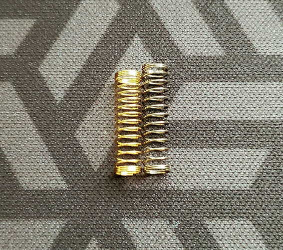

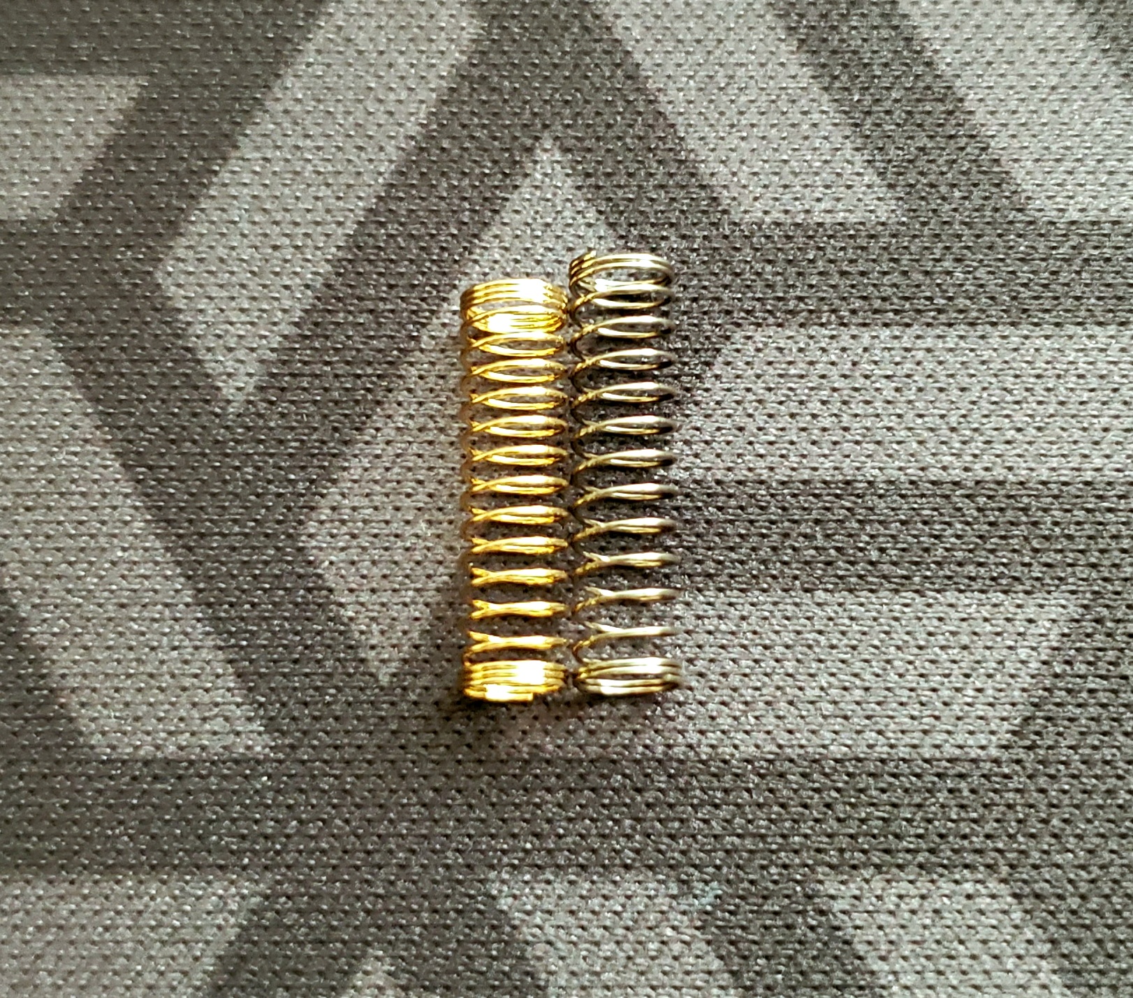

So i got my dry yellows in today & did some comparing them to Gat yellows loose. As far as the feel from the spring goes the drys definitely feel a little bit lighter than the Gats. Which I found kinda crazy, but after comparing a few different switches I’d say they feel almost weighted the same at the beginning of the press , but after that Gat yellows ramp up in weighting slightly making them feel heavier & also have a snappier return. You can feel more rebound force on finger with Gat yellows IMO. While the dry yellows have a very linear feel to the weighting, it feels pretty much the same throughout the whole key press. Here’s a pic comparing the dry yellow spring (left side gold one) & gat yellow spring (right side silver one), beyond the Gat one being a little taller I can’t see any super noticeable differences.
Beyond that, the drys are a good bit smoother & actually have tighter housings than the gats! It looks like at least for the silk/dry series JWK tightened up the tolerances & there is much less wobble than with Alpacas, Tangies, Marshmallows, etc. My overall take on silk/dry yellows vs Gat yellows is get silk/drys unless your budget just can not cover them. They are definitely a superior switch to Gat yellow IMHO.

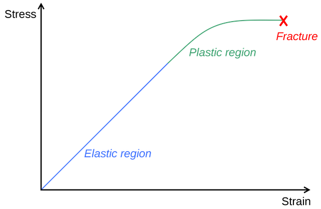

Weaken, as in the clip legs don’t fully restore to their original form once bent or something else?
You got it.
Yep, a good practice is to flex top housings’ legs back in towards each other before putting the switch back together. That seems to make the switches come back together more uniformly IME.
yeah, I do this on pretty much every switch i take apart
Thanks for the tip with the legs - I’ll be doing that from now on.
Aha. Plastic versus elastic deformation. I might need to start testing switch openers that don’t exceed the clip leg’s elastic region

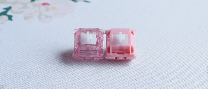

Speaking of linear, Pinoko GB is still on going. Kinda like the looks of the switch but reviews seems mediocre for switch that price.
Welcome to the party, @kinglau66
I hadn’t heard of the Pinoko, but after checking it out I’m inclined to agree. JWK switches are fine and with a little TLC can be fantastic - but whoo that’s steep for what’s essentially the Honda Civic of switches.
Gotta hand it to 'em though, the recent string of JWK recolored switches lately have all been pretty gorgeous and are great options for builds centered around specific aesthetics or colorways.
