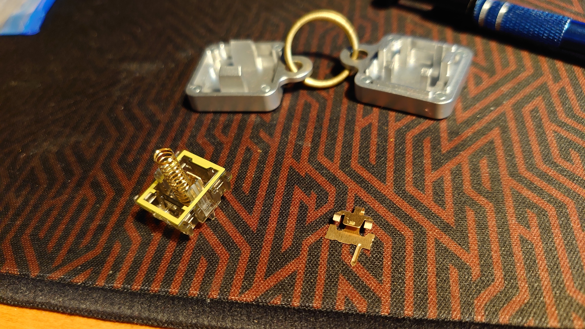

Is this the thing that happens to Ink v1?
Yes.
Happens to newly bought silent to =/
They aren’t too hard to put back in if you’re careful, but some can rattle. A small plus for modding is how easy it is to swap different leaves into the Ink housing - I did this with T1 guts and it was quite nice.
I have a few Tangies with loose, rattly leaves. Next time I do a lube session I plan to put some grease on them where they meet the housing - I’m hoping this will eliminate the ticking / rattle.
This is some of the most incredible silver-lining-spotting I’ve ever seen :clap:
Ye, I had no problem getting it back in.
But u mean u change it to make it tactile?
What I did in that case is essentially port all of the T1 components over to the Ink housing, and what I got out of it were switches that felt just like T1’s, but noticeably more smooth.
The interaction between stem and leaf is where a lot of switch feel comes from, so it can be fun to experiment with.
