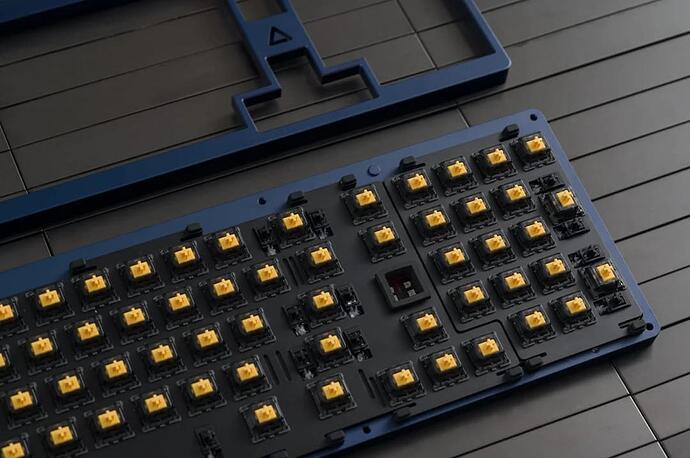

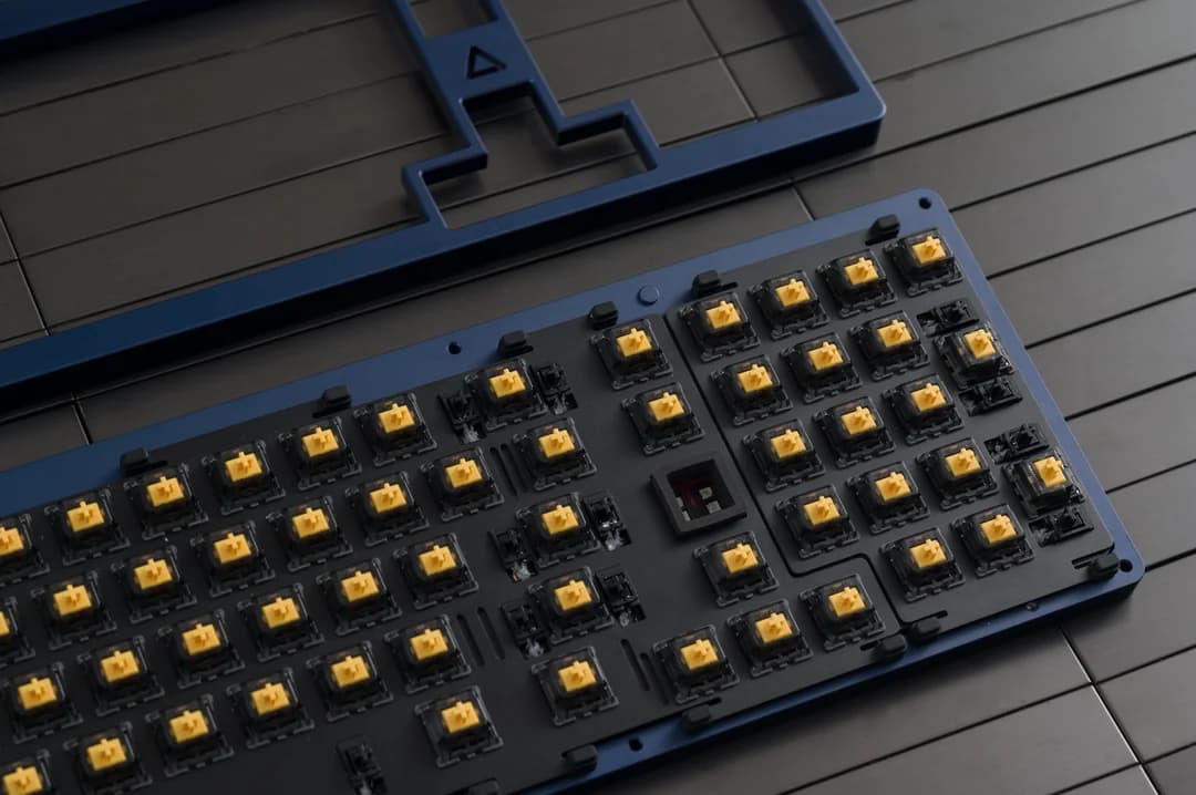

I don’t see a PCB image on the Tet page, but it’s safe to assume you need PCB mount stabilizers instead of the plate mount ones you have specced. That’s usually the case with customs. Cherry PCB mount clip-ins will work, as you mention. You could also try TX stabs; I’ve had good luck with them (rev 3). If you’re up for it, I’m sure you could clip and/or lube yourself. I’ve found TX to be forgiving.
I’d second the recommendation for TX stabilizers - rev 3 is great, and I think the latest one “AP” is even better - same theory, just developed a little more and with softer inserts. I’m pretty bad at tuning stabs and I’ve found the TX AP ones plenty forgiving. TX are one of a few brands that don’t need “clipping” - they just omit the little bits that most people clip-off these days.
TX does offer stabs for 1.2mm PCBs - alternatively you could get 1.6mm ones compatible with standard PCBs and use the shims d3L7r0n mentioned; here’s an example of those.
