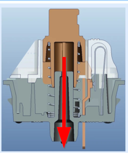

Okay… so I have some of these now. I bought the milky with yellow stems. I’m still not sure why they exist. The do sound good stock. That is the only thing that is great about them. I believe this comes from the generous oil lube on side rails and legs from the factory. Comically long springs. A lot of friction when pressed off center. This is especially noticable when you press on the north side of a keycap installed on these switches. However, scratch is present in every position except for dead center keypresses.
Pros:
Sound like a well-lubed switch without much lube drag (decent job with oil lube from the factory)
Packaging has built in acrylic switch tester/lube station
Cons:
Scratchy
Parts that don’t play with other switches: Bottom, stem, weird long spring
I guess they are nice when put to the purpose of typing. You don’t notice the scratch when typing quickly. I don’t understand the redesign. Is the new design what gives them a better sound signature? I need to clean the lube off of one of the switches and test to be sure.
TLDR:
New design offers no real benefits other than sound. Switches are scratchy with off-center presses but nothing drastic. Similar to cherry and other Gateron milky housings.
I’ve been typing on these for about 1/2 a day now, and I’m going to say that I recommend you guys try these just to hear them. They sound really nice. It might be the best sounding linear I’ve ever used. I’m not sure what causes it. I don’t konw if it’s the lube or the new design or perhaps a new type of plastic., but it’s very nice. Definitely a thud instead of a clack. Now, if they can just find a way to make them smoother.
It may be the sound of the housing pole’s flat top area (a circle) striking the bottom of the stem. With normal MX switch, it’s the stem’s bottom edges (two thin lines) that strikes the housing. And with Halo and Cream, it’s the sharp tip (one point) of the stem poll. So the striking surface area of this switch is much larger.
It is a nice sound with a softer yet more solid bottoming out feel to the fingers. Gotta say, I like them. I like them more than something like a normal gateron clear/black or milky switch.
But again, if smooth is your thing, these won’t fit the bill.
I did experiment with swapping out the top. Seems a LOT of the scratch comes from the top. It feels smoother with an ink top or a JWK top. But there’s still drag/slip-stick on off-center presses. Less scratch but still not skating smooth like a JWK.
If you do happen to get some of these, do yourself a favor and don’t judge them until you put them in a full board and type for a while. Something pleasant about this switch when typing.

Decided to throw these in my hotswap board & give them a try stock. I’ve been using them for almost an hour now & my impressions are positive so far! Slightly scratchier than most high end linears, but very similar scratch to any other Gat yellow I’ve tried. The springs feel a bit heavier than their stated 63g bottom out to me. Although a 63.5g progressive spring is the heaviest one I’ve been using lately so it may just be me there. The sound is great IMO! I have them on a CF plate right now & they have a nice thock to them, but still lean towards the more poppier side of the sound spectrum. With lube these will be a fairly deep sounding switch I think.
Not sure I want to put these in my 8X MkII now that I find they feel a little heavier than I expected, but will be lubing these up & keeping them in my test board for now. I’ll update this post after I do it!
Sounds great but scratchy makes this switch an ideal candidate for polishing. Tempting.
