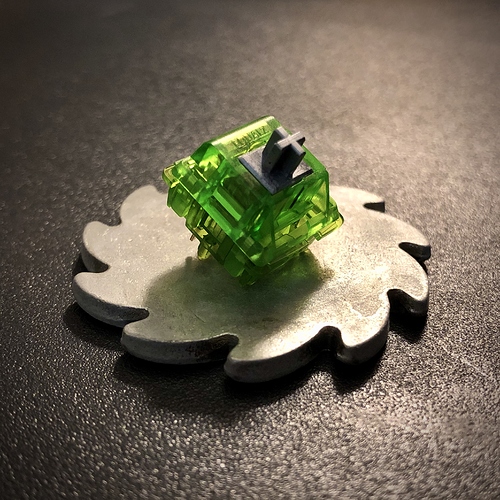

Ninja Turtle
- Kiwi housing
- YOK Panda spring
- Gazzew silent linear stem
- TX polycarb film & 3204 lube
- 90’s green shell
- Steel-silver stem
- Quiet like a ninja
Very quiet linear with a rad 'tude.
Flavor-text:
You can see what inspired the name and more photos in this thread.
These Kiwi housings are proving better homes for these stealthy stems than the YOK Pandas I had them in before - not that those were bad, but I think the tolerances are better for the stem here, leading to a bit more crisp feel.
Any switch with these stems is going to be very quiet, and of course these are no exception. The dampened bottom-out might be a turn-off for some, but the owner of these switches picked out these stems as an easy favorite because of it. The bottom-out feel is pretty unique, and definitely distinct from other silent linears I have tried.
Yes, that’s a POG slammer from the 90’s.
Now all I need is some pizza!
All I have to say is that they need blue, purple, red and orange switch-films for bandanas.
