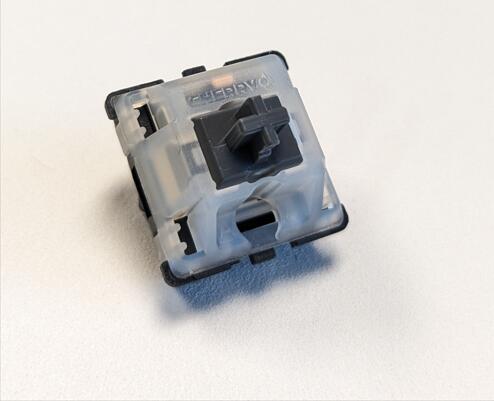

My contribution: a “Cherry Silent Nixie”. Clear top, bottom housing and springs from a new MX Black Clear Top. Stems from a Cherry Silent Black. While the switches were opened, springs lubed with 105g0 and rails / legs lightly with 205g0. Definitely not silent but very muted. Very little sound on strike, an nice soft pop on return. My daily driver is loaded with these and co-workers are happy :smiley:.
cherry silent nixie

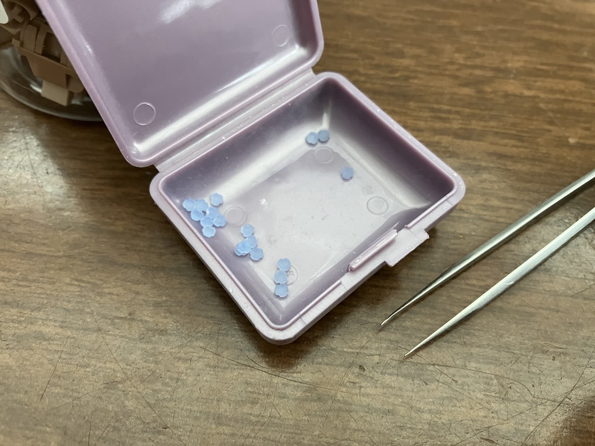

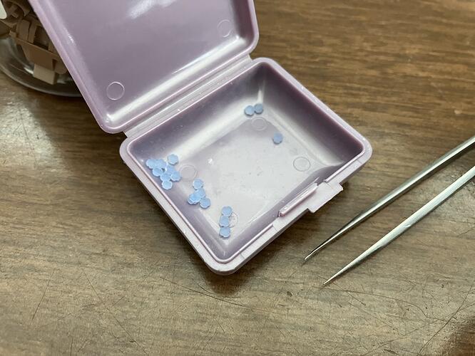

And I found a Solution for it! But, as it requires drilling, it’s not for the faint of heart. Or for those that mind destroying a bunch of switches for their stems, springs, and a silicone dampener. Also, the last of those, the silicone dampener, is a tiny dot of silicone at the bottom of the stem well, and it is a royal pain to extract, but it’s necessary to dampen the bottom out.

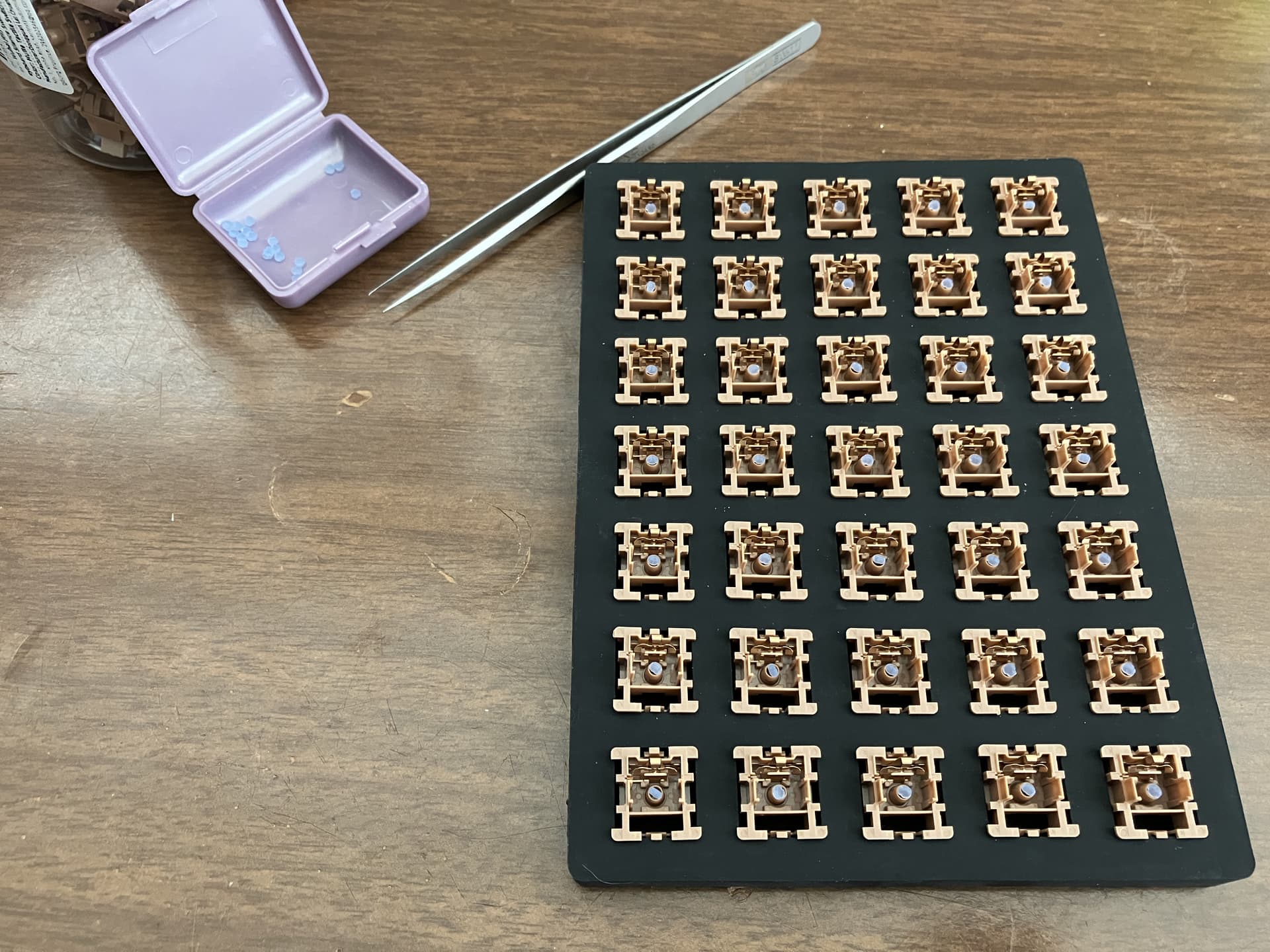

For the bottom housings, there are two ways to get the silicone dampener out of the bottom.
  1. The non-destructive but fiddly and time-consuming way: Use a toothpick or tweezers to turn the plug sideways, and then use a long wire with a tiny bend on the end to pull it out of the well.
  2. Drill it out with a ~2mm drill bit (any size that is smaller than the center hole will work).
I found the second method most reliable, especially when doing a lot of switches. Occasionally one would get a little damaged by the drill, but by and large the silicone used is very rigid (high Shore rating) and didn’t get damaged by the drilling.

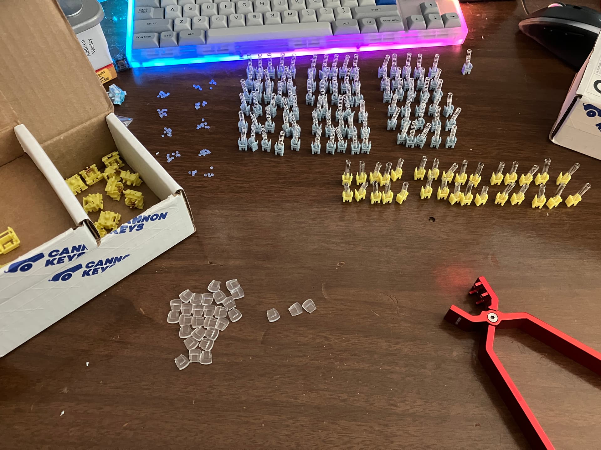

Once you have removed all the dampeners, you can begin assembling your frankenswitches. I recommend this order:
  1. Set out bottom housing
  2. Tweezer place dampeners in the stem hole (just needs to be in it)
  3. Ram dampener into place and verify depth
  4. (optional) Put films on bottom housings
  5. Add BWST springs
  6. Separately, combine the stem and top housing (make sure the legs point in the right direction)
  7. Snap top housing assembly into bottom housing assembly
  8. (optional) Insert LED condenser if donor switch had one
Of these, step 3 is the one I spent the most time on, as the dampeners have a tendency to get stuck sideways in the hole and can take some convincing to lay flat. I used a stem with the actuation legs snipped off as my ram. To be the most useful, put your ram into an empty donor bottom housing and mark where the stem clears the stem rails. This allows you to judge whether the dampener is flat or not–there’s a noticeable height increase if it’s sideways.

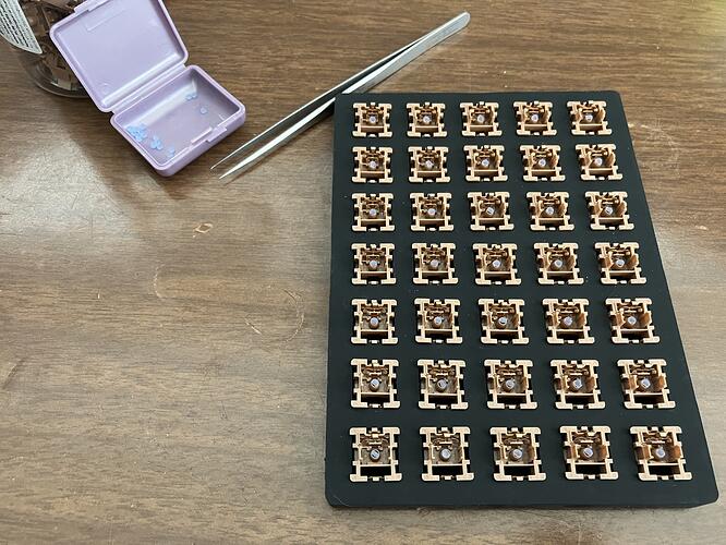

Pix
Finally, here are some pictures, as my description is probably not enough here.

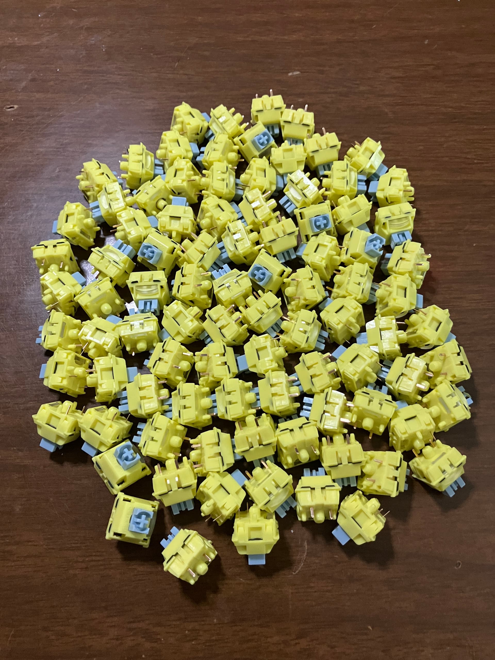

Here’s ~90 complete BWST+Outemu Pears. I’m calling this combo Slava Ukraini because of the colors.
