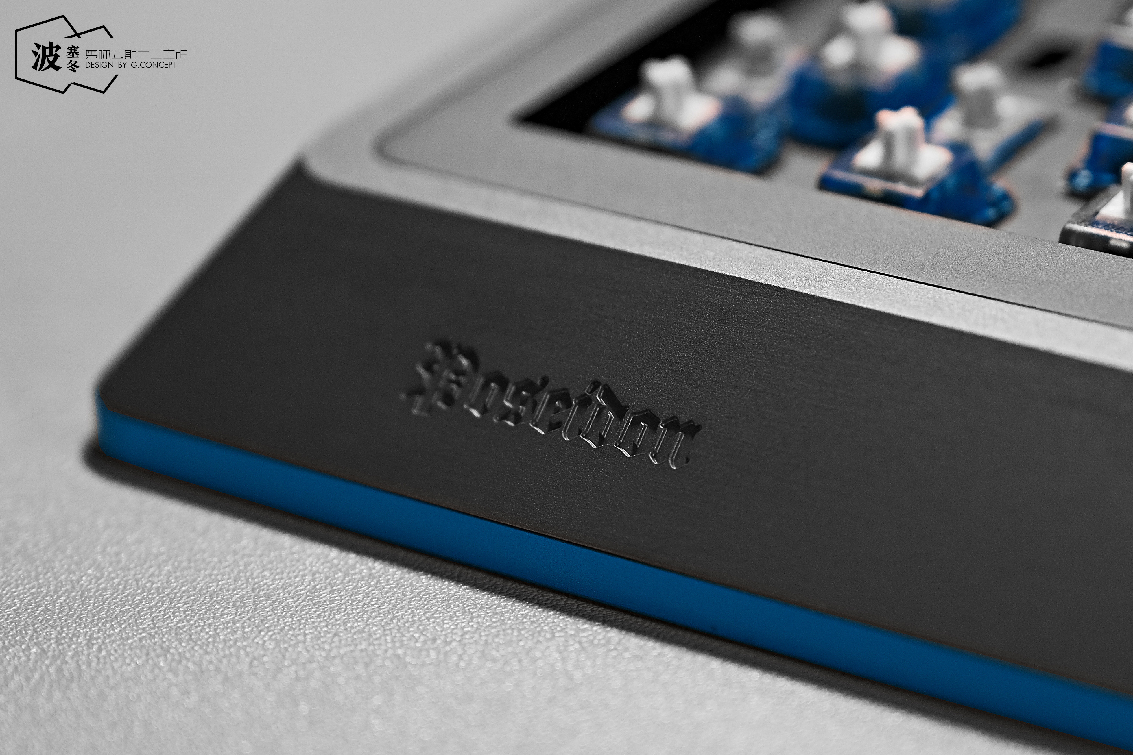

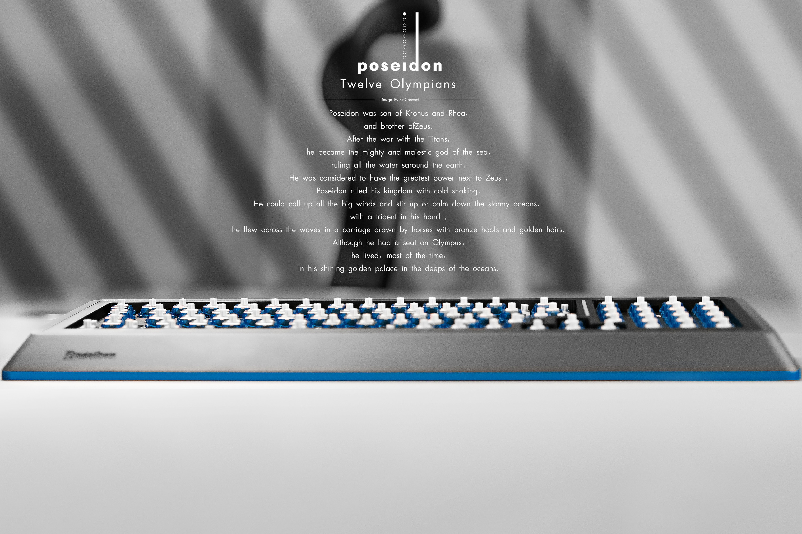

Long time no see to everyone! After Space Trek, I had started my new project, I called it Poseidon. The reason is I used the ‘Trident’ as the logo, personally I think the 'Trident looks really cool. But in case someone doesn’t like it! I also do another simple version without logo.

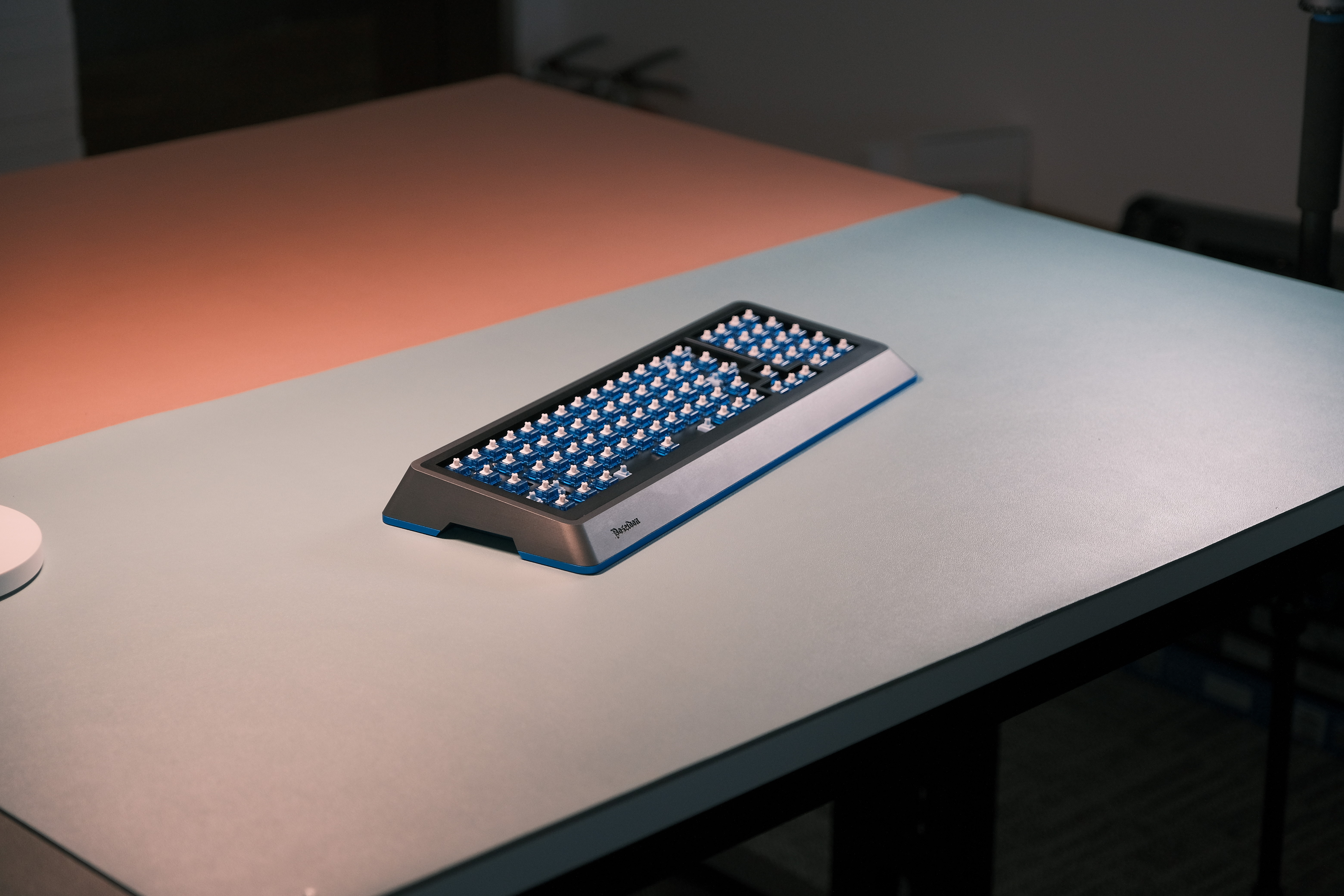

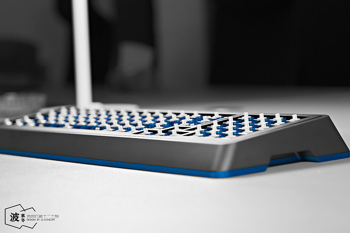

The details as follow:
1)Bottom mount attached to the middle case
Magnetic top plate
Copper counter weight attached to the bottom plate
Poron anechoic pad between pcb and positioning plate
EVA anechoic pad at the bottom plate
1.5 mm aluminium positioning plate and PC positioning plate
Full cnc aluminium case

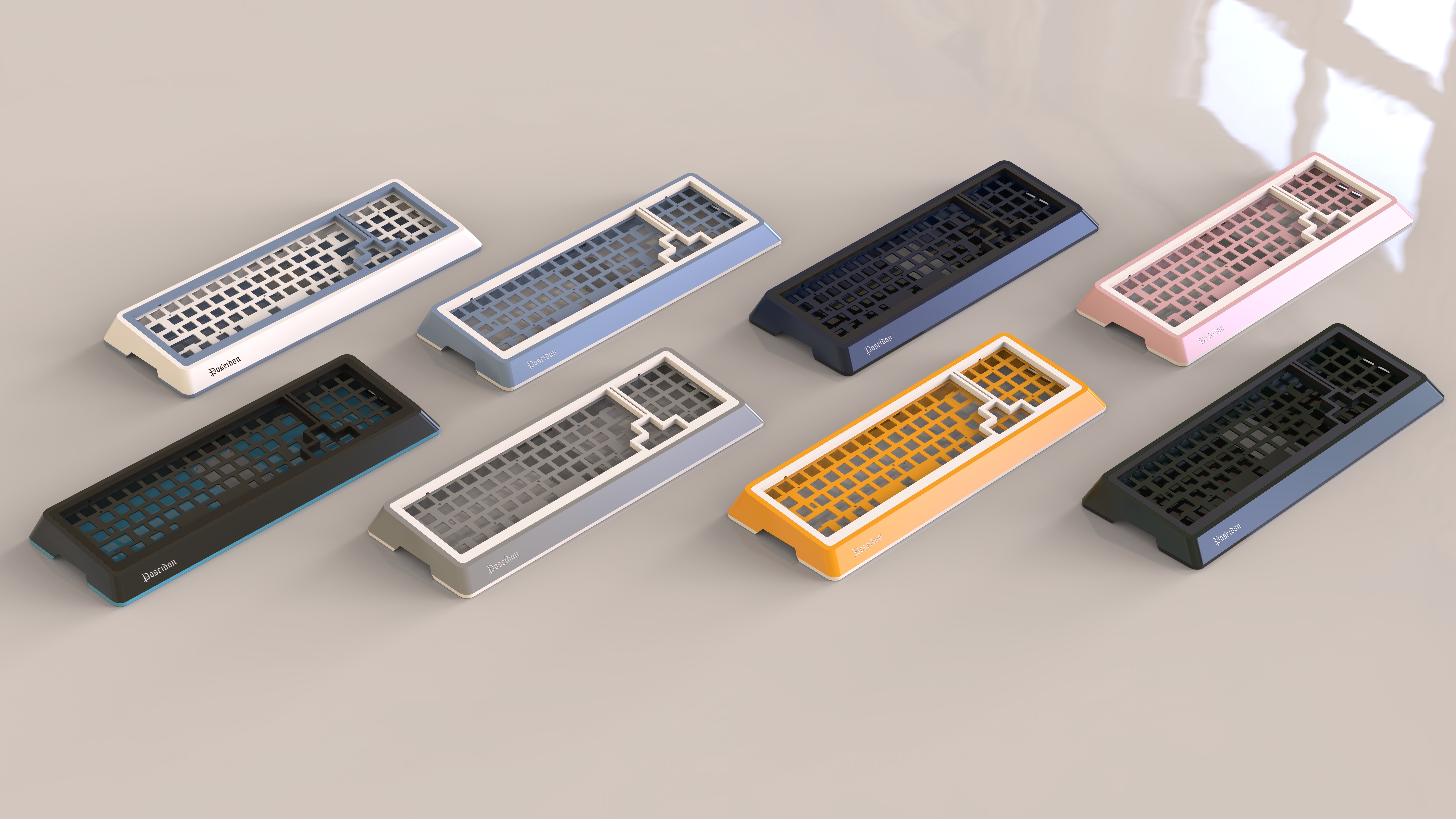

Electrostatic coating with 8 different colors
Logo coloring by plastic molding

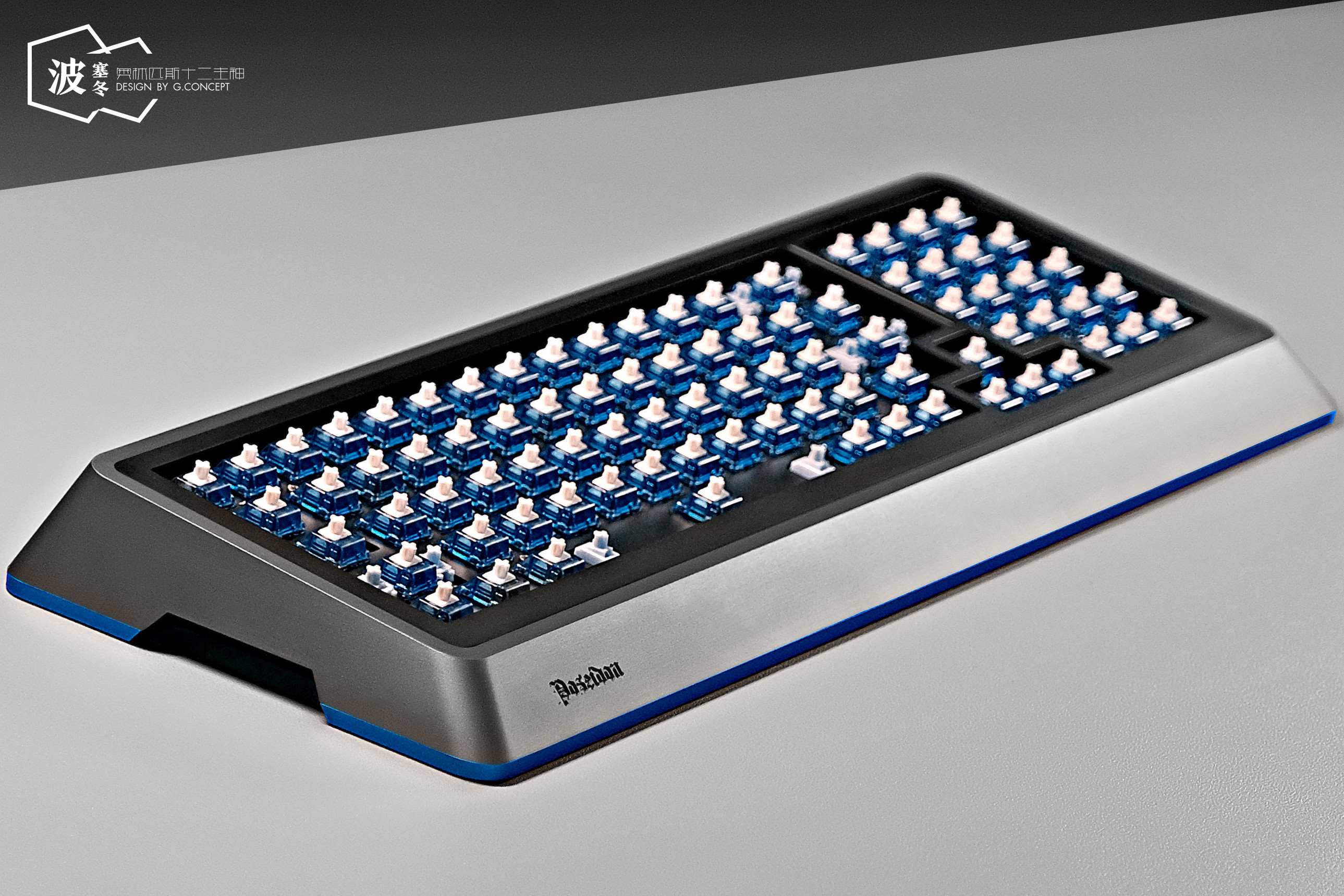

6.5 degree

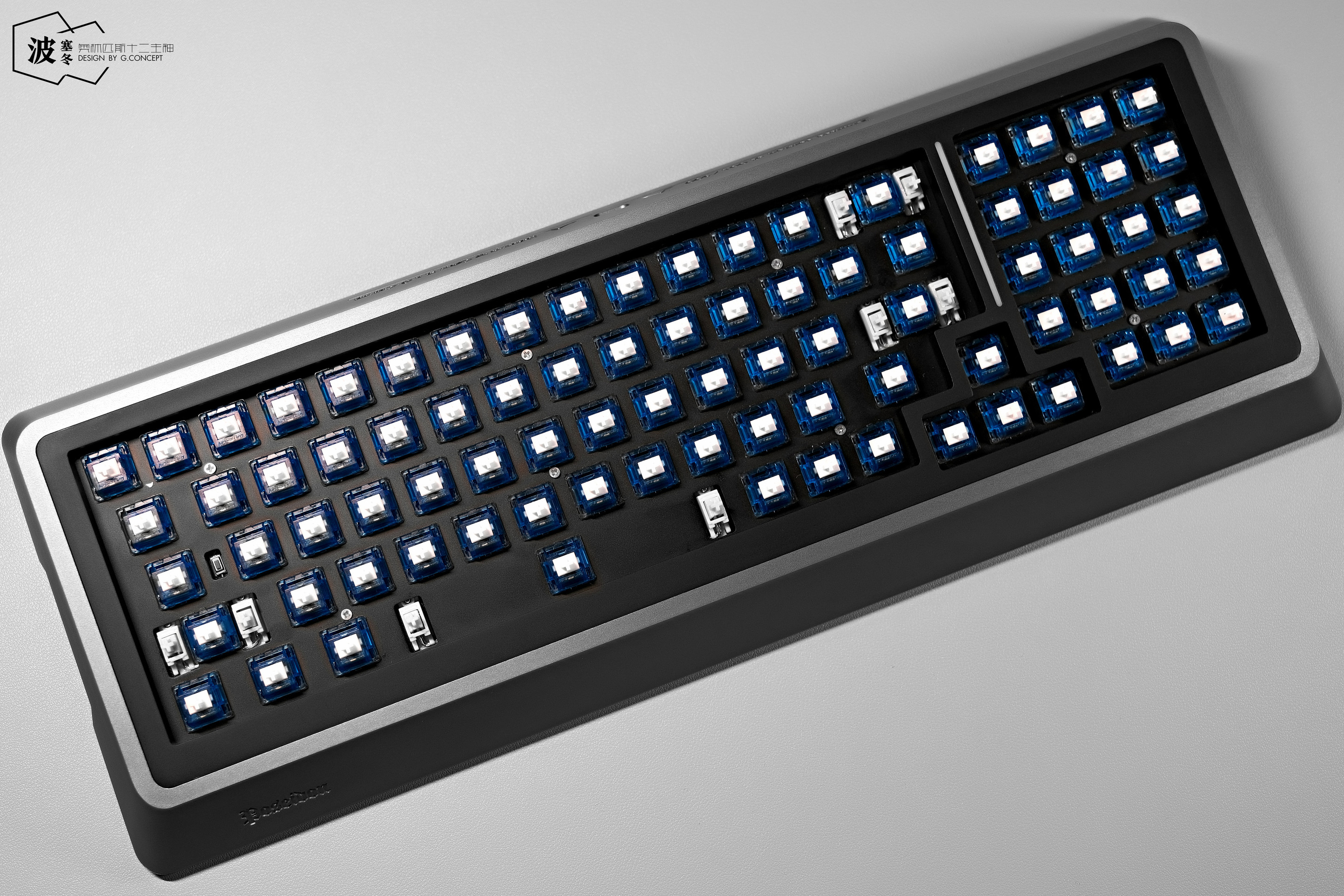

Hot swap PCB with fully customize keys by QMK
83 keys

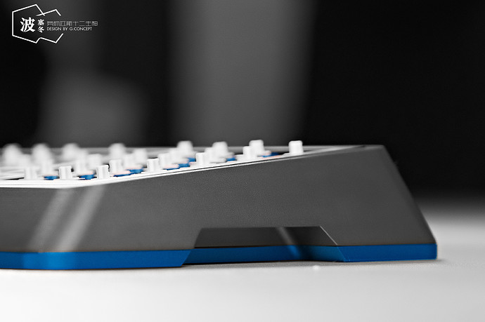

The keyboard shape kinda like round trapezoid. Some people may ask with this shape how can I use an armrest? The answer is the front of the keyboard is in slope which is low enough, so i don’t think it needs an armrest, but in case someone prefer a armrest, please do not hestate to contact me for a customize make.

8 different colors combinations

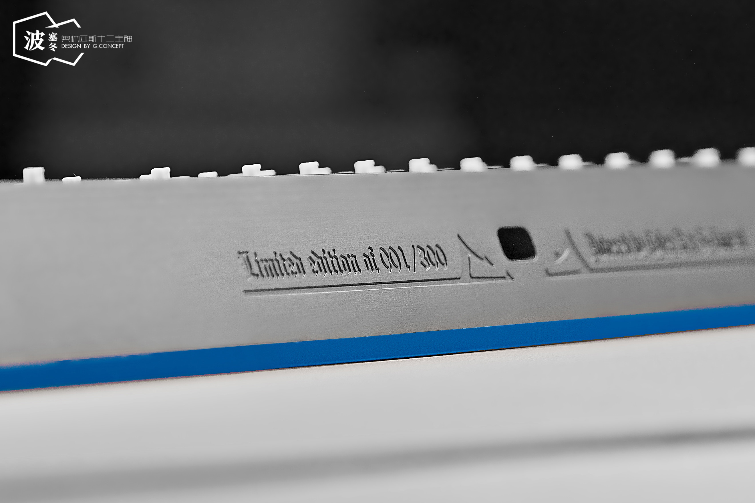

The actual sample
