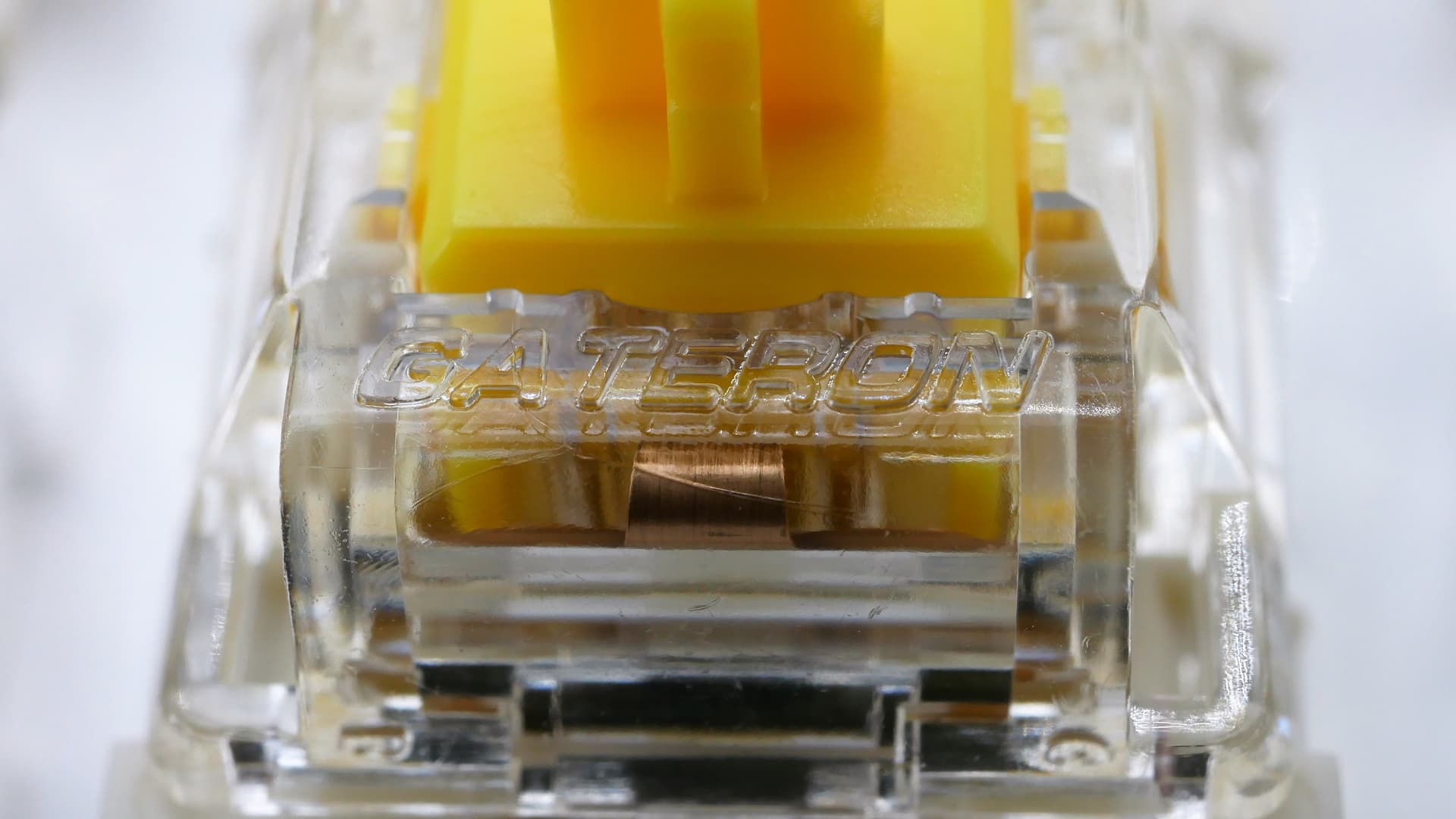

Hey all,
After a fantastic weekend off at That Windy City Keyboard Meetup in Chicago, I’m glad to be back with a full legnth review today. Given that this is the review where I finally have hit 250 scorecards, I figured there’d be no better way to celebrate than to pay homage to the very first switch I ever assined a scorecard to: Gateron Yellows. But rather than revisiting the classic ol’ KS-8s… let’s take a look at the latest and greatest in Gateron’s G Pro 3.0 Yellows!

I just received my batch of Gateron G pro v3 and they are very smooth and great for stock switches … until they became tactiles on rare occasions.
(All seven tested switches of the 90 switch batch have this issue)
I don’t know if it’s the spring, a leaf thing or what else could cause this, but every once in a while the switches have a clear tactile event. Not huge and intensity wise similar to MX browns.
Feel wise it’s different and rather like some part has latched on to another part and then quickly disconnects, like with clicky ALPS or like the spring buckles like on a Model M.
Has anyone encountered a similar issue with these or other switches and knows what might cause this?
Edit: After spring-swapping the switch I have found I was unable to replicate the issue with the Gateron G pro v3’s spring inside an JWK Alpaca, while the Gateron G pro v3 with an JWK Alpaca’s spring retained the issue detailed above.
Therefore the issue is not with the spring itself, even though it might still be an issue with the behavior inside the Gateron G pro v3 switch due to interaction with the housing or stem.

Could you take a picture from above on one of the switches you know for sure have the problem.
