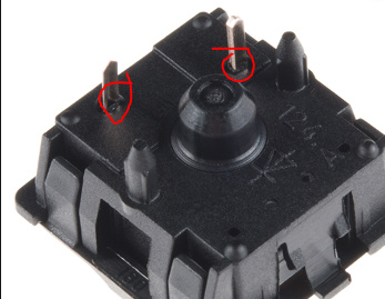

Is the leaf locked in place by the top housing, or is there a potential for it to move up and down, potentially changing the activation point?
The leaf sits on the bottom housing and the plastic on the bottom housing that surrounds the pins are what holds the leaf in place.
Basically with Gateron ink switches, the plastic that surrounds those pins are loose, so people have been able to too easily pull their leaf up from the bottom housing.
Would inserting the switches into a hot swap board, that uses Kailh sockets would mess with the leaf position and give me a bad impression of the switches.
Hopefully not, but no clue. Although I doubt it would cause major problems. If it did cause the leaf to shift, it would most likely make the stem have 0 contact with the leaf meaning it would never actuate lol.
The Kailh hot swap sockets don’t put too much vertical force onto the pins, mostly horizontal force. So it should be fine, but :man_shrugging:

The issue that has arisen for many is that when they open their housings, sometimes something will snag the leaf and pull it from its fixed position. Typically the leaf is gentle and you don’t want to me messing with it too much otherwise you’ll start to notice a lack of consistency between switches if you’re not careful.

I just lubed and swapped the tops of some black inks pretty recently, and the main thing is that the loose leaf makes lubing even more of a pain since you have to carefully put it back into place if it gets lifted slightly, or sometimes out of the switch altogether.

So the easiest way I could think of to hold the leaves in place would be to use a small clip of some type (I find small hemostats to work awesomely if you have access to any) to hold one or both (if it’s super loose) of the legs pulled down tight on the bottom of the switch. Putting them in a HS board is troublesome though as the leaves will want to move if they are loose & there is a small amount of room for them to do so with the switch closed. If you’re soldering them in you can grab the legs through the PCB to make sure they are pulled tight, but I can’t see a good way to prevent them moving when installing them in a HS board.
