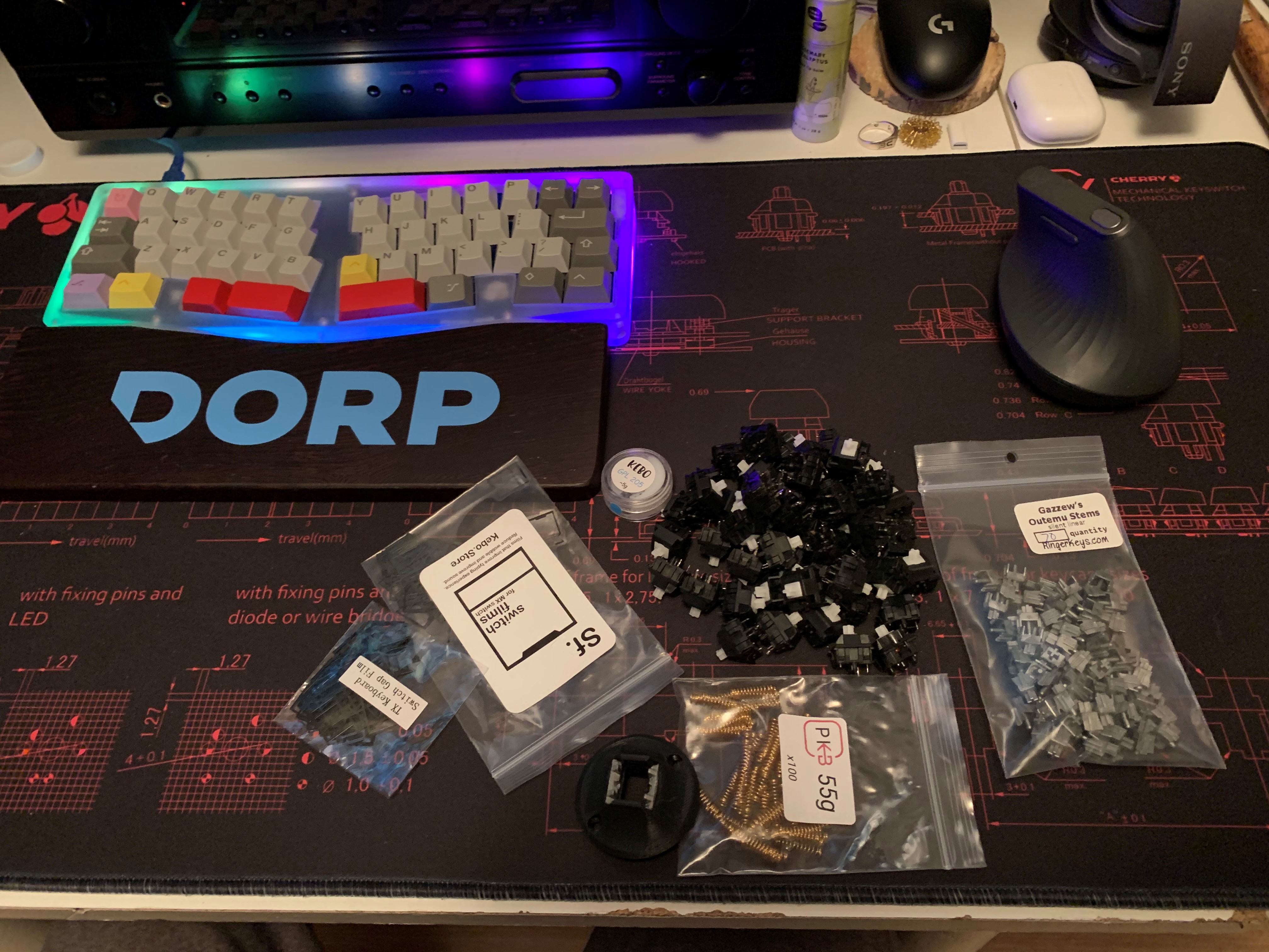

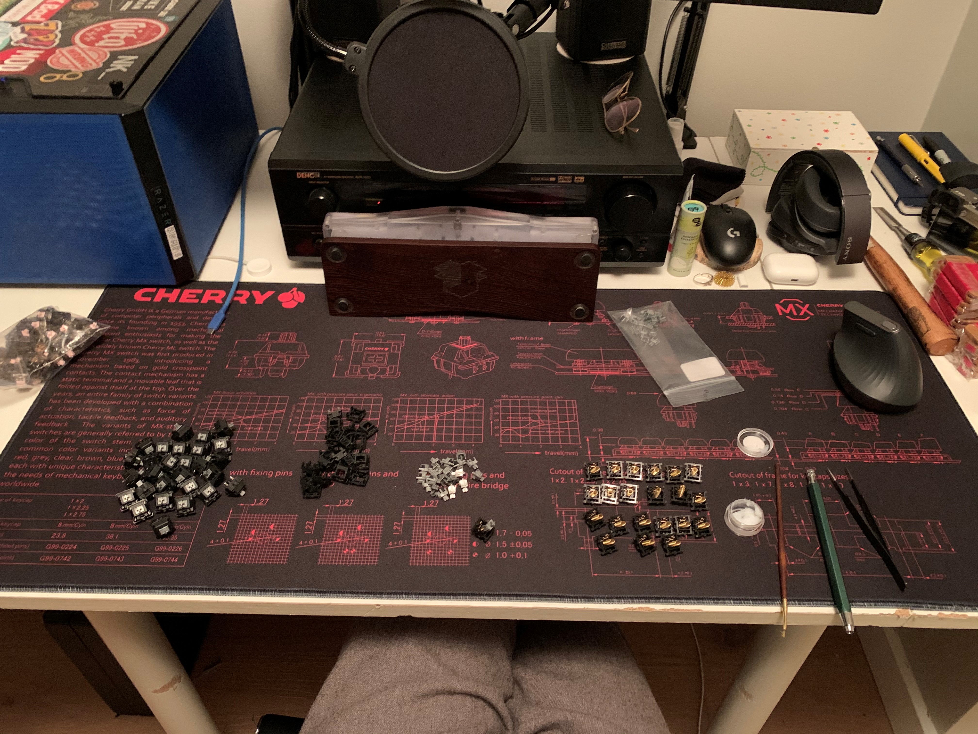

I finally received my stems after some nail biting with USPS tracking, and after hunting down some housings to use besides my U4s, I wound up desoldering 50 mx clears from my stock of old defective cherry boards just for the housings.
Admittedly these housings are probably not all they’re cracked up to be, but with some lube and films along with some 55g springs (this time from prime_kb not Sprit) they turn into a pretty amazing switch.

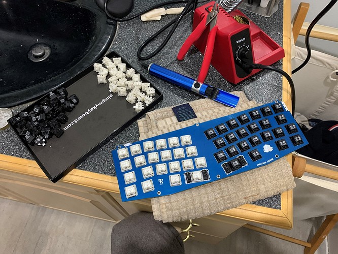

Halfway there. my Jank ass soldering set up in my new apartment right now (featuring unseen extractor fan and open window)
No pic of the fully soldered board, but heres the Tofurky and potatoes of the matter.
These are, in my limited experience, an amazing silent switch, in basically any housing. due to these being old cherries, they have some scratch in the housings that wasnt present when I put these stems into JWK or boba housings, with the boba housings fairing best for stem wobble, then JWK, with cherry housings trailing with some obscene shake. The travel is noticably quieter than the silent alpacas, not to say that they’re “loud” but you can detect some rattle and rustling of the silencing gasket in the alpacas, where as the GSL (Gazzew Silent Linear) cherries are nearly dead silent even on an enthusiastic bottom out.
Overall. The stems are amazing, have great compatability with a range of housings, smoothness is improved by the JWK housing, but at the cost of stability and thock. If you’re looking for a more solid bottom out on a silent linear, this is your best bet I think, definitely not rock solid, but the bottom out is strong and satisfactory.
